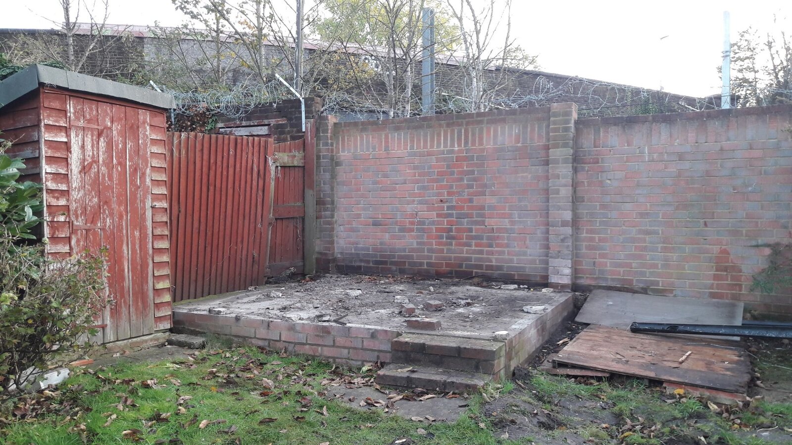

The shed was on a concrete base, although it's much smaller and will now have to be removed.

The picture shows the boundary fence with my next door neighbour. Behind the wall is alleyway and tram.
It's the end of the corner garden for both me and my next door neighbour.

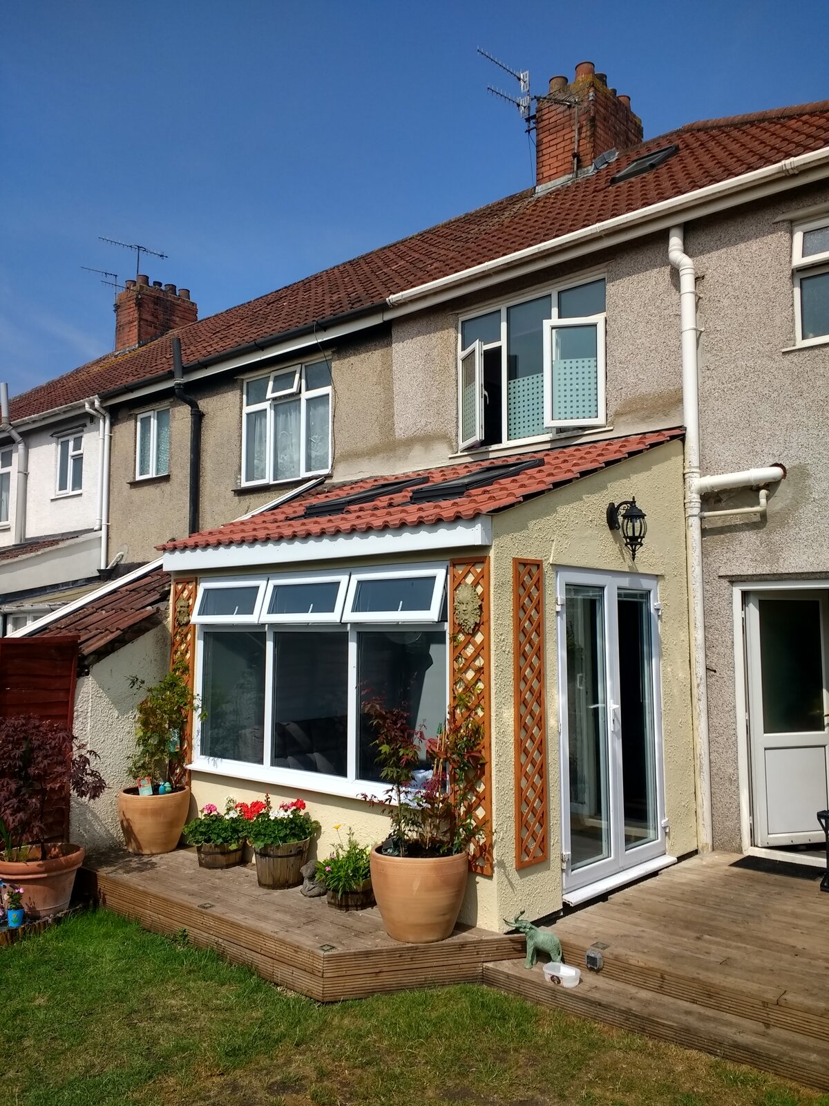

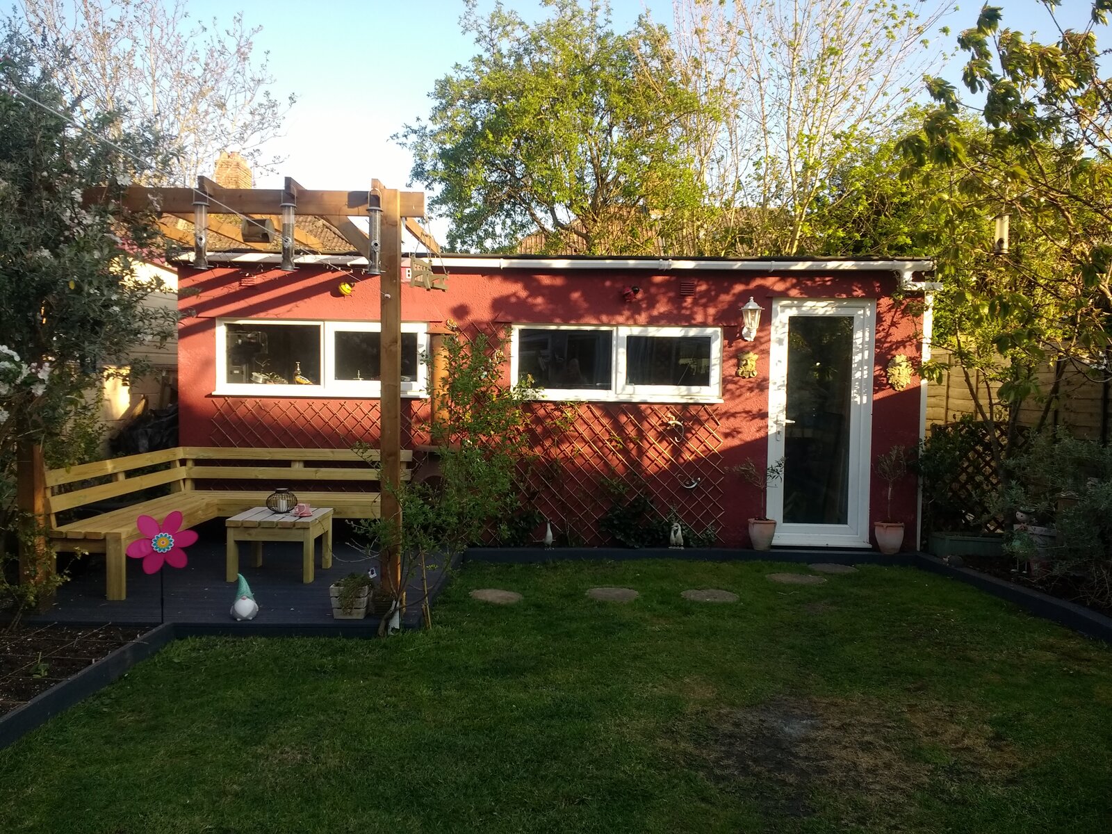

I would also go with timber frame and rendered. I have done this twice in the past and I'm currently doing the same with my side extension.

You can build in 4x2 to make the frame, use OSB for sheathing, then cover with breathable membrane, then vertical battens, then cement renderboard which can be rendered.
Inside you can put celetex in between the studwork.
