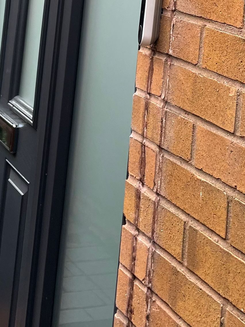

We have removed a porch. Unfortunately, they decided to use some sort of sealant around the porch and has left brown sealant around the front door.
Anyone have any ideas how to shift it?

Possibly silicone eater and a scraper for the worst bits and a small rotary brush (the type that look like a tu-tu for want if a better description, i.e. not a cup brush) used very gently on an electric drill for the final clean-up. I have done this on our house (sand stone). Success rate might well depend on the texture of the brick surfaces
Try a jet wash first, does not look like silicon, more like a basic frame sealant which can be washed off .
