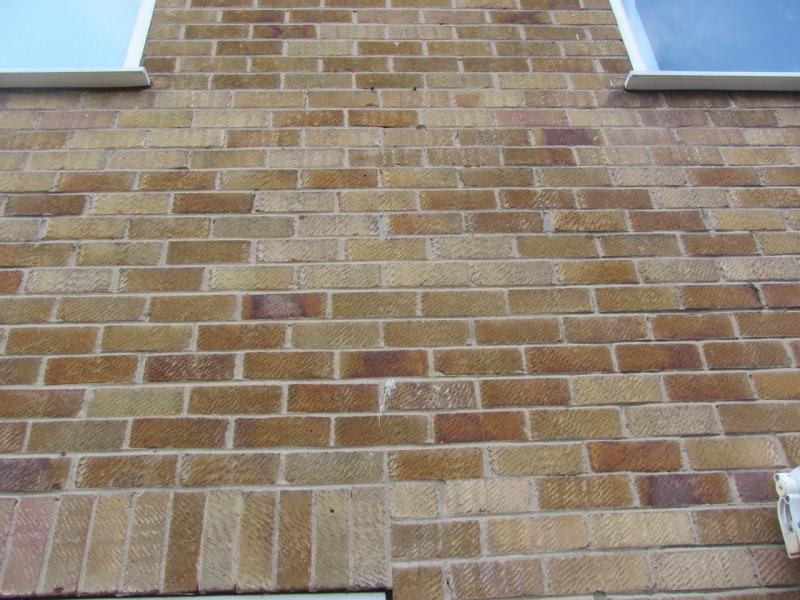

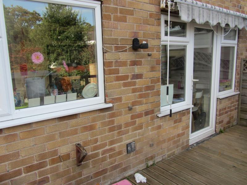

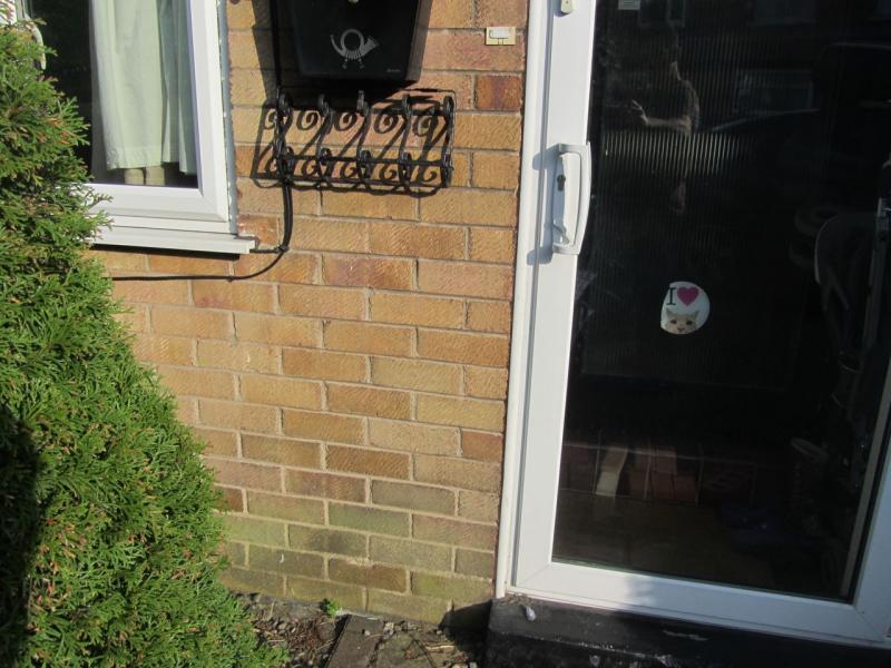

Hi all,
Wondering if anybody could suggest a match for these bricks, I have used a brick matching service and so far nothing has come close.
I think they are LBCs and they are 73mm.
Many Thanks for any assistance! I have no idea what to do if I can't find matching bricks. Seems the 73mm will cause a bigger issue as far less available than 65mm. Builder has an idea for this, if it comes to it. Biggest concern is that there is no match at all.
Suggestions so far have included Golden Buff (Too uniform I think), and Village Harvest Multi (not golden enough)
Regards,
Eric
Thanks, yes I have, and I contacted them supplying the photos - they suggested the Harvest Village Multi as the closest thing.
Doesn't look close to me, but always hard to judge from pictures alone.
They look like standard LBC buff multi rustics to me. But - as above - it's hard to tell from the photos.
http://www.brickexpress.com/rustic-73mm-hanson-lbc-LBC22.brick
Those Harvest village bricks don't look anywhere close to me.
Thanks, I think you've got one of the closest yet but they don't look like they have enough yellow in the mix, also the texture is wavy rather than diagonal (though it's colour first for me, if we could match that texture wouldn't be an issue)
Beginning to think I need a plan B - not sure what that would be on an extended semi-detached...
Smaller bricks are not too much of a problem if you step the line of the extension back 4 inches and use wall starters.
