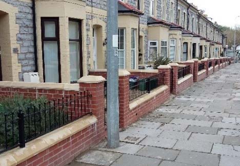

Depending on the hardness of your existing bricks, the paint could be soda/sand blasted off?
Whole terraces were treated this way in my area recently, returning them to their original stone and cream brick finish.
I always thought removing paint off bricks causes damage - something for me to look into though.
