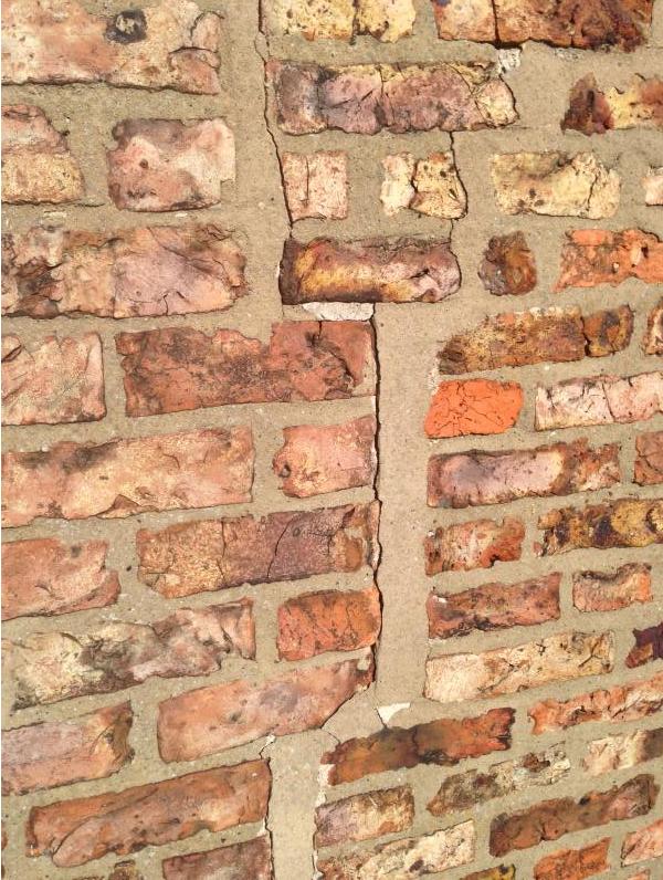

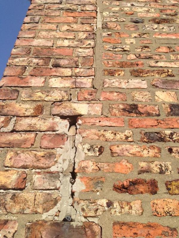

Brick wall - Is this a sign of subsidence or something else?

But all your surveyor with say is 'you need another survey from an expert'..

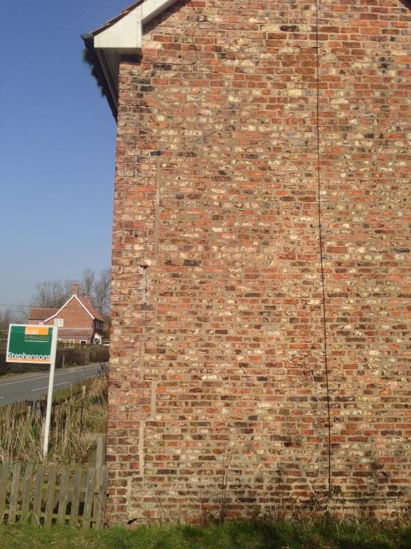

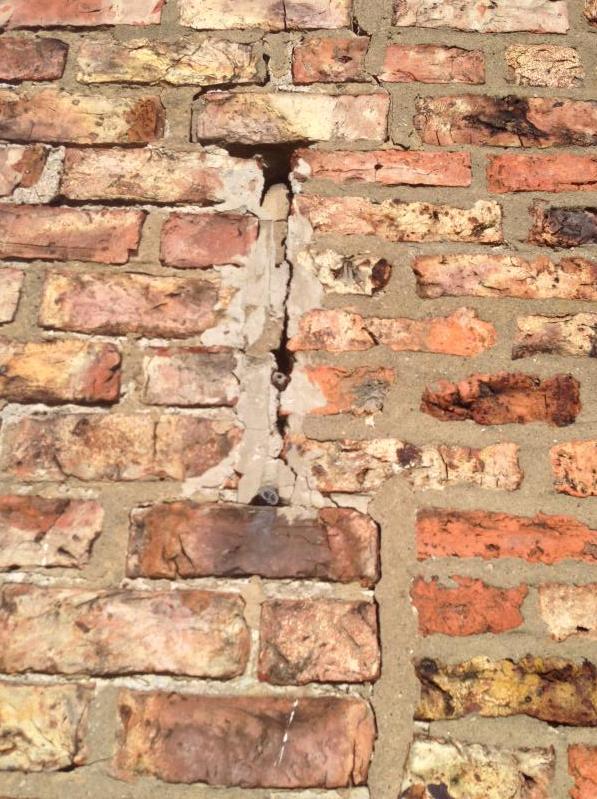

No, there is no evidence of subsidence.
Did you actually read any of the things I typed in your previous post?

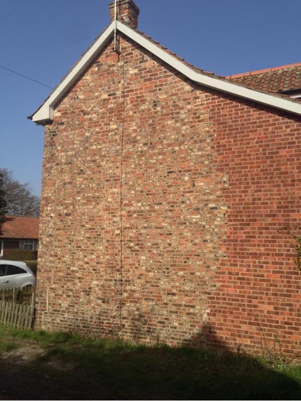

It looks to me like there may have been stone stone coins in the corner and rather than repair they have put some brick in?
Unlikely, as this would be indicative on the adjacent front elevation also.
What backs up my theory of a previous building being present is the evidence of sooted bricks showing at the bottom centre of the gable elevation.
Maybe an old fireplace?
Could be wrong on all counts of course. What is true though is that the side elevation brickwork is completely different to that of the front elevation and that it appears that it is of 'common' standard.
It also appears that higher up the gable, I.e. above window height, the brickwork resumes to best quality standard.
This may be that the demolished building was lower than its neighbour.

Here's a few more images to get a better idea of the property...
Is there some way of researching the history of the building? Because to me, there is strong evidence another building existed against that gable elevation. Mebbe one similar to the one on the other side.

The one on the other side is a recent extension. The interior of the cracked wall does have a working fireplace though.
I was told that the building is probably around 150+ years old, research doesn't bring much up though.

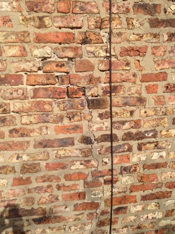

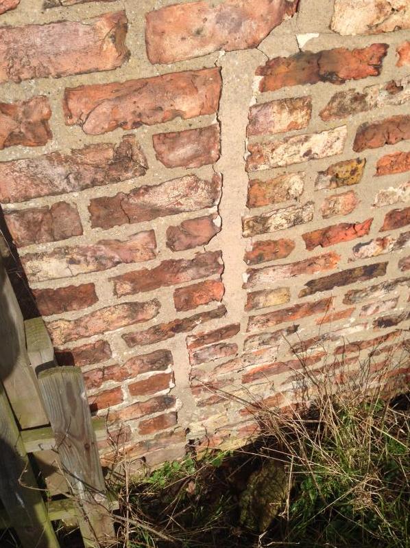

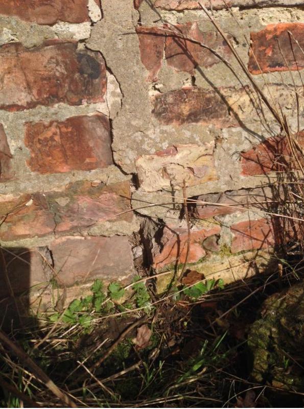

The front flank might have moved slightly from the gable wall as it's not really tied in properly. They used a smaller depth brick on the gable which makes it look worse.

Might an easy way be to dig a small hole where the other building possibly was? The founds may still be there... Or other detritus from it's demolition.
