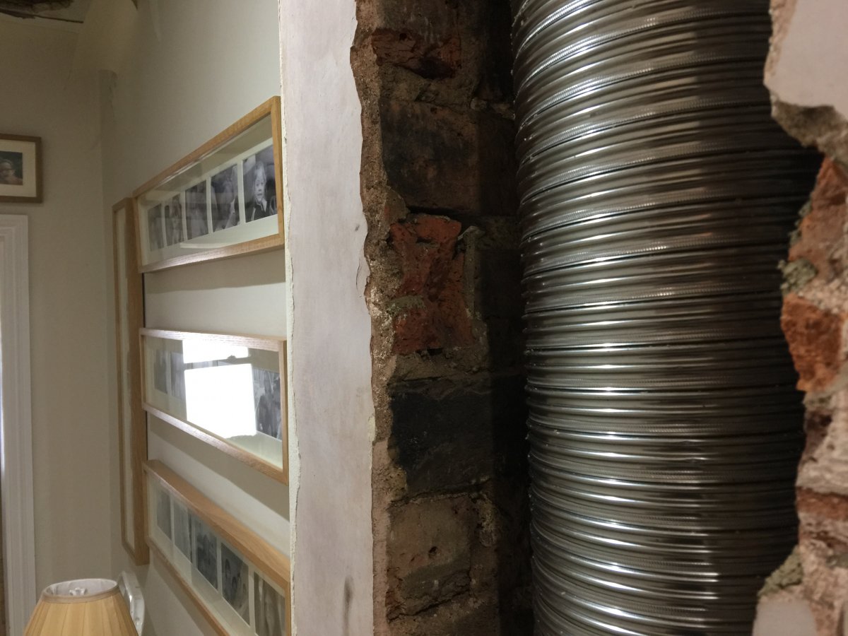

Hi I'd like some advice re closing the fascia of a chimney stack..... the chimney above is supported and so structurally no problem. However I'm concerned about the heat from the liner and what material I can use .... I would prefer not to use brick as it will decrease the width of the corridor. I've considered 10mm cement board followed by fire proof board on top that can be decorated.... any ideas
Chimney flues tend to be sqaure, so as the liners gone in, and there's space either side of it, then you should be able to brick it back up at the front. The liner seems to be sitting slightly forward, so can you put in some vermiculite fire board, and then brick the front back up - actually, why was the front taken out.

When I originally purchased the house the chimney had been reduced in size to create a wider corridor. The front fascia was removed to allow space for a 6inch liner.
Can I use self taping screws to tie the new block brick into the existing chimney?
I'm afraid that with the arrangement that you have, your only option is to use brick. The only other option would to have used twinwall flue. Cement board wouldn't give you enough heat protection and would be a fire risk.. If by fireproof board, you mean fire rated plasterboard, then forget it as fire rated plasterboard isn't heat resistant and will rapidly decompose and since it is coated in paper, it isn't fireproof either
I was thinking he might be able to use vermiculte fire board (not plasterboard) to provide a degree of heat resistance to whatever he blocked the front the the chimney breast up with

A lined chimney must be at least 100mm thick, 200mm between another property... Usually it is fine dropping a liner down a chimney as they are usually thicker than that but when folk mess with chimneys, then you need to be careful. A vermiculite board will help to reduce the distance between the liner and combustibles to 1.5 times the diameter of the flue but there is no way to stop anyone from placing combutibles near to the board, so that is why they insist on 100mm brick or block
