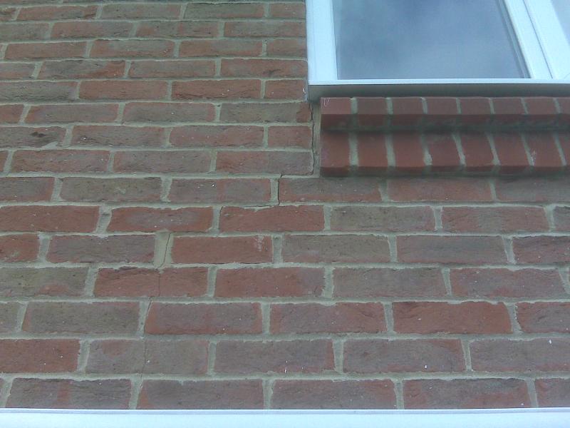

I have recently noticed a crack running from the corner of an upstairs window (new) vertically down to the top corner of our patio doors(existing). The crack runs through a couple of bricks but is 1-2mm wide at it's widest. There are no cracks above the upstairs window at all and no other cracks visible anywhere else on the outside of the house.
We had UPVC windows put in about 18 months ago and (whilst we only spotted this recently) looking back at old photos this crack started to appear about 3-4 months after installation of the new windows. There is a matching crack in the plasterboard on the inside which we did notice immediately, but assumed this was only superficial (there was a fair amount of plasterboard damage during the installation).
I have queried this with the windown installers and they are claiming no responsibility citing subsidence as the likely cause.
One comment they had during the visit was that it looked like there may be no lintle on the upstairs windows......
So - what I'm after is any advice as to what the likely cause is (I can get a photo up here if it's useful), which will lead me towards how to proceed?

Whilst there is nowt unusual about having diagonal cracks emanating from the corners of openings (i have them in my house), it does seem odd that there is a crack all the way through the masonry and that it is considerably wider at one end than t'uther.
Firstly, how old is the property?
Are you on a clay substrate?
Photo's?
Window companies are quite skilled at avoiding any responsibility for the lack of lintels within properties, though i guess legally they are only obliged to point out that you either have them or you don't.
Some only care whether they can fit their windows in without a triangle of brickwork falling down, as in older properties the external masonry sometimes relied upon the old wooden window for support.
Vertical cracks, including through bricks, are more typical of thermal movement (contraction).
However, it would be rare for these to show on an internal face too if these are cavity walls
Cracks both inside any outside in the same place are more typical of some foundation movement
Dodgy window installs tend to give stepped cracks not vertical and not through bricks, and relatively soon after installation

what`s that got to do with a crack under the window :confused: No lintol over the patio door , maybe - but unusual in a house that age- crack running from patio door up to corner of window

You need to know if its still moving.
Various methods such as gluing a microscope slide over the crack using a strong resin based glue. Get the slides from a decent chemist. Dap glue on either side of crack leave to set. If slide breaks its still moving.
Same method with 2 plastic window packers with a straight line drawn across the 2 pieces of packer. leave a while and see if the line is still in alignment.
Don't be so stingy with the photos. We can give you a better idea if you show the whole area.
