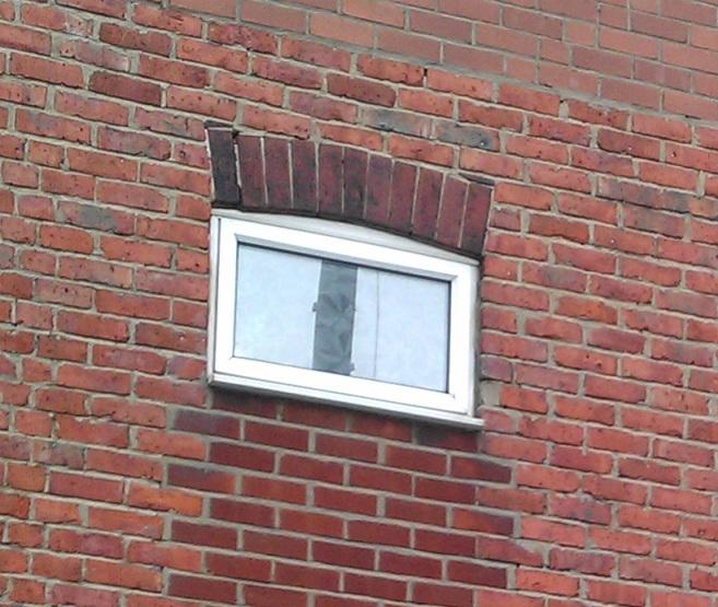

After a bit of advice folks.
A small window on the gable end wall on the rear extension of our 1900s terrace needs replacing. The frame appears to be coming away from the wall slightly, or at least it's a bit loose when the window is opened/closed, occasionally causing grit to fall from the cavity (I assume) above.
I did note on the survey when we bought the property that a minor repair to the brickwork above this window was recommended
The actual text in the survey says "slight disturbance was noted to the masonry above the rear bathroom window. this type of damage is indicative of the slippage of the soldier brickwork support to the wall. This is a common occurrence in this type and age of construction when the original windows are replaced. Minor remedial works consisting of inserted helifix bars should be undertaken to restore the integrity of the masonry"
As it's come to the point where I'm getting the window replaced, interested in the thoughts of you experts about what remedial work may need doing to the masonry. I take it the problem they've noted is shown in the brick on the left of the arch?
Is the surveyor right and are these helifix bars the way forward (what do they actually reinforce, I'm confused), or is it enough simply to repoint?!
And is there likely a relationship between the disturbance to the brickwork and the slight movement in the UPVC window frame? Or is it perhaps just a poorly fitted/cheap/old window?

It's hard to tell exactly from the photo. The brick arch has certainly slipped and the brickwork above has dropped down slightly with it. You say cavity - are you sure you have a cavity. What age is the house?
Helibars could be fitted into the joints above the arch which would relieve pressure on the arch and probably stop and further movement. That would be a cheap option but appearance wise it wouldn't look any different to what it looks now so in my opinion would be a false economy.
If it were mine I would take the arch out with a few courses above and rebuild with helibars in the joints. Done carefully that would give the best finish and would outlive most of us.

Heli-bars are not going to do anything for the arch or the window frame either
Can't help wondering why is there's difference facing brickworks above the window

The arch repair, or fitting of a new lintel will stabilise the brickwork.
Helibars are not going to be doing anything useful, and will be just extra work as the arch will need repairing one way or the other when the window is changed

It looks like there is no lintel supporting the arch - it should be self supporting. There is presumably a lintel supporting the internal leaf.
You can fit an external lintel and then use a plastic arch former to put the arch back, or just replace with soldiers or normal brickwork.

Apart from the cost of the scaffold to access the window, the repair could be done in a day.
As Woody said, fit a new former to the head of window, the bricks look reusable, take the arch out and rebuild, bedding the bricks in tight.
You might want a temporary prop while doing it, make sure the windows fixed properly.

FWIW: the gable pike has been re-built , hopefully, with two skins because the original one brick skin, built off snapped headers, had begun to bulge or lean. V. common.
You now have the added weight of the re-build above the frame. Again, FWIW, i'd suggest removing the soldiers and installing a flat lintel
It also looks as if you had an old window opening(?) bricked up, given the newish brick and the odd proportions of the PVC frame.
Window installers often cause damage when replacing older wood frames that sometimes had a structural purpose. They also, typically, cut the old wooden horns and leave them embedded in the brickwork - a fungal risk.
Woody is perhaps on to something with ref. to the inner ( timber ) lintel. Is it level? Is it sound? During your re-furb. you should investigate these things.
Do all your refurb. work in one go. The scaff. tower could be used for any exterior plumbing or facade work.
