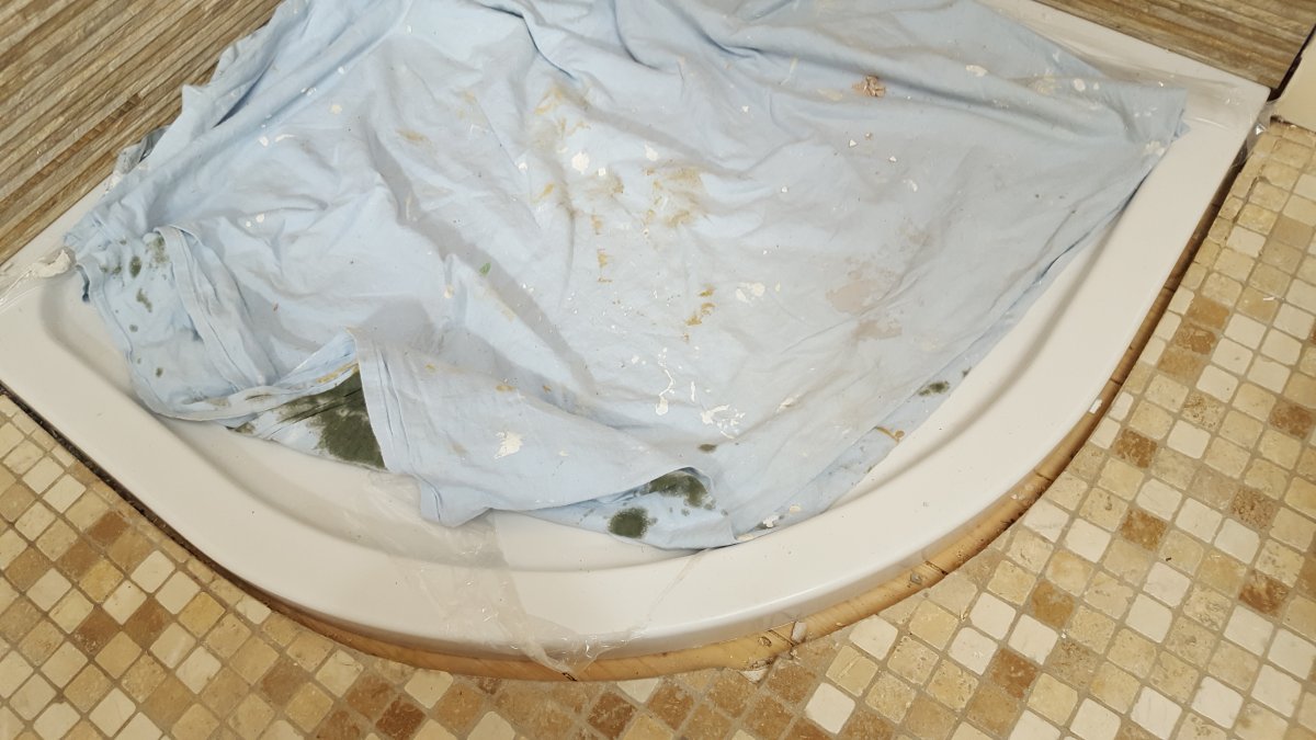

Hi there, we're getting the bathroom sorted following a leak and have replaced the shower tray.
Unfortunately the previous shower tray was a different shape and we now have a gap between the shower tray and the floor tiles.
The tiler has scratched his head for a solution, we cannot get a match for the floor tile mosaics.
He doesn't want to cut another row of mosaics away to allow for a different cut of tile to go in between.
He is suggesting a trim, build up the gap with grout and adhesive - but he doesn't have a flexible one, and was talking about heating a straight one to bend it.
I was wondering if a Quadrant trim would bend more easily?
Any other suggestions for covering the gap? Its about 24mm at the very widest part.
Personally, I'd try cutting back the tiles, using a diamond wheel, to leave a uniform 25mm (or whatever) gap then infilling with a deliberately contrasting strip of mosaic pieces. How thick is the mosaic?

Thanks Guys,
My initial thought was the same as you Tigercubrider and alec_t, but the tiler doesn't want to cut back, he says it'll loosen the existing mosaics. I had suggested putting different mosaics or cutting a strip of larger tile at a curve o fit in after putting down a sliver of ply but the tiler doesn't want the hassle.
He had suggested cutting some marble tile and over laying it (building up grout and adhesive under) over the mosaics.
But now they've said about bending a strip of trim. I really think they want the easiest option, not what will look the best. :(
The trim would have to be at least 24mm wide to cover the gap. What trim and how would he bend it?
As you are the one employing the tiler, surely you dictate what he should do? As for loosening the existing mosaic, can't a suitable adhesive cure that?

In answer to all your advice:
The tray us already glued down- at the time the guy from the bathroom shop said "the tiler will be able to sort out that gap no problem"
The tray is a 900 quad.
I'm paying the bathroom shop, the tiler works for them but is self employed and is their only tiler so I think he dictates a bit, therefore as my job isn't completely straightforward he wants the quickest solution.
I'm going to go back to the shop and insist on it being cut back and matched as best as possible.... I just know that they'll suck their teeth and tell me it's going to cost.... I'd seriously have a go myself if I had the rightly cutting tool.
Thanks for all your advice.
Ill let ye know how it pans out.

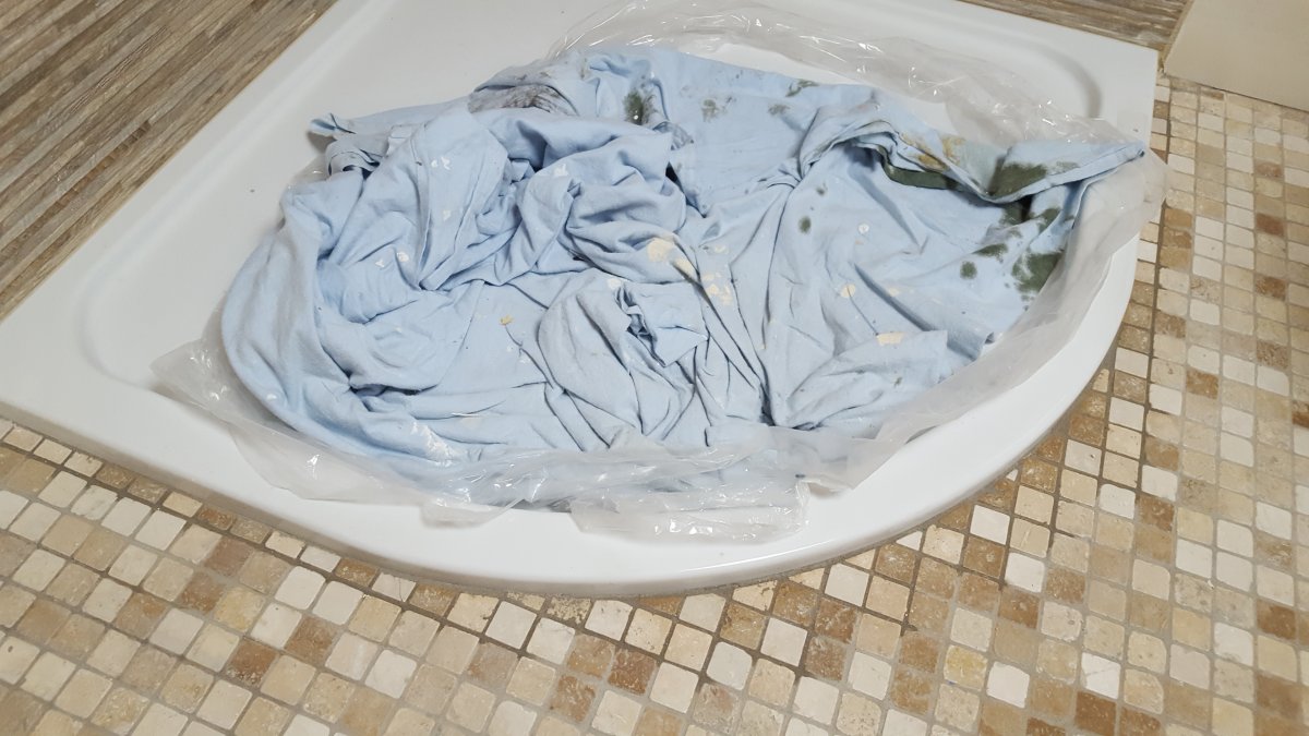

FWIW: here's a few pointers:
1. The tray appears to have been butted against the wall tiles - A proper fitting requires the tray to go under the wall tiles, & then they should come down on to the rim of the tray.
2. To cut the wall tiles, and recess the tray further back will create a larger gap at the mosaic surround.
But it would make the tray more secure against leaks.
3. The tray appears to be sitting on the floor - how will you access the trap?
4. Has the waste & trap been water tested?
5. If you lifted the "glued down" tray you could square off the floor tile, & run the mosaic under the tray footprint without any need for cutting.
6. You could build a small platform to raise the tray, & provide for a plinth access to the trap.
note: running a utility knife down the grout line will remove the grout and cut the mosaic mesh - tiles or tile off-cuts can then be lightly levered out.
The best kind of tray has fins that go under the wall tile.

Hi Guys, after much grumbling, the tiler completed the job, took him just over an hour.
We'll clean and reseal the whole floor, but the grout is dry now (not above) and its as if they were always there!
