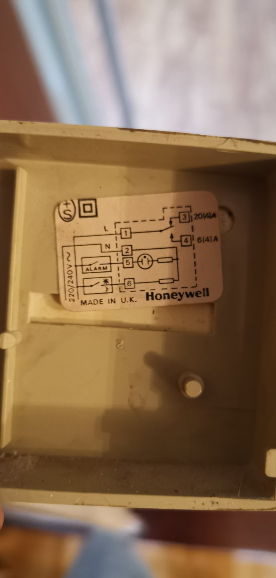

No, blue is in terminal 2 which is shown as neutral on the diagram, it shows you that it switches between number 1 and 3
Thanks for the reply. So 3 and 4 need joining as they are the switch?
No, read yorkspark's reply again. He says 1 & 3 are the switch. I think you'll find 4 isn't connected to anything.

The wiring diagram shown on case does not seem to match the thermostat, so I would actually test thermostat to see what it does, but the other problem is the programmer only shows one wire in L (Line) the two relays are volt free, Hive is not volt free when using the CH and DHW version, so it may not be suitable?

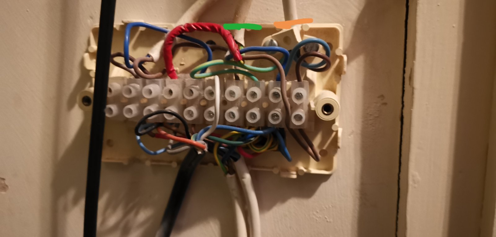

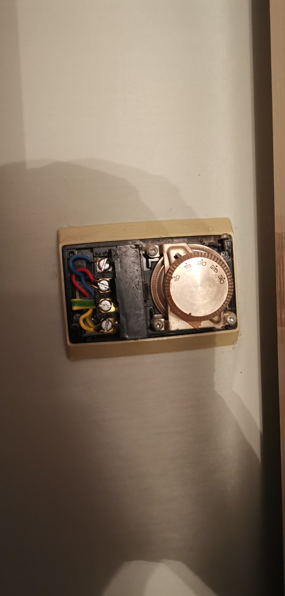

I've traced back what I think is the thermostat to the wiring centre. The cable marked orange is the one I believe to be coming from the thermostat. I understand I need to bridge so I can't just remove, the cable marked green goes to the current programmer and joins the thermostat neutral (as seen in photo). Which two is it from here that need joining? Sorry to sound like an idiot.. It was far easier when installing on my standard combi!

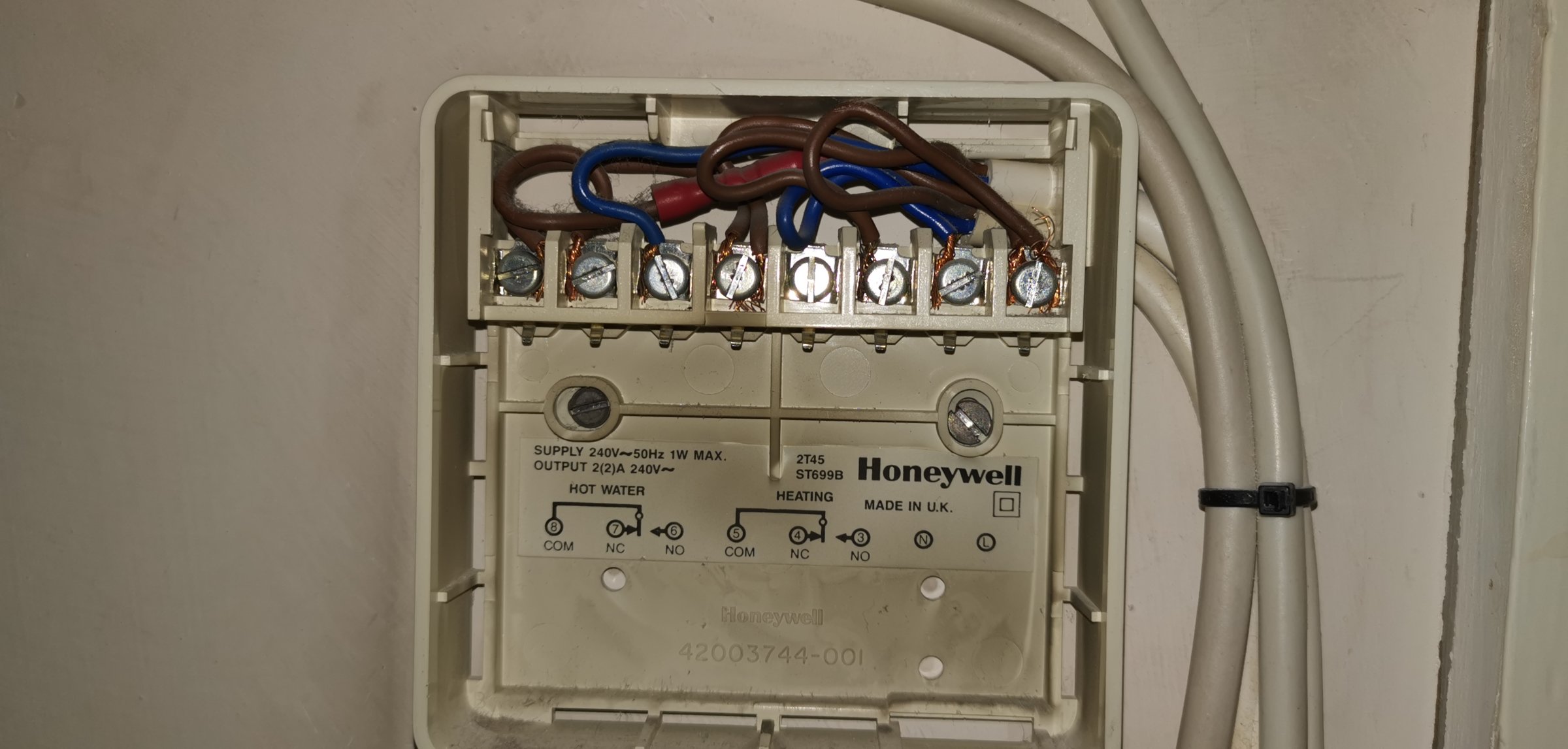

The boiler is a Gloworm Micron 60FF - pretty ancient by todays standards but still going strong. I've tried to find a wiring diagram to find out about the options you mentioned but to no avail.
The hive dual channel controls either the 3 port valve or the 2 x 2 port valves depending on your system and the valves then control the boiler
Incorrect.
There is a link between L and 5, and another link between 5 and 8. So the relays are not volt-free.
