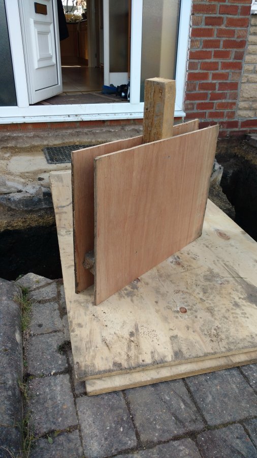

Need a bit of advice. I'm building a porch (well doing some of the donkey work to save money). I've gone down 900mm, but about 20cm from the bottom the electric cable runs thought it perpendicular at the front of what will be the porch.
My builder friend says dig a few extra inches down, about a foot wide, around the cable, get the concrete people to fill the whole trench to just below the pipe, then shutter an inch to each side and continue filling. Then fill the gap with sand and the bricks will bridge over the top.
This means my foundations are in two pieces essentially. Would it not be better to somehow cover the top of the pipe and then fill it all? Or am I over thinking this as a problem...

I agree - do it in one pour.
I'd shutter it off with some osb/ply boxing, embedded in the sides of the trench a bit so that it won't go anywhere, filled with pea shingle so it won't try to float away in the concrete, and then wrap some dpm/gaffer around to stop concrete ingress.
You could use an offcut of soil pipe too if you think you can make it work.
Not sure exactly what building regs has to say on the subject- me I'd be getting a bit of 50mm ducting or 70mm gutter pipe, slitting it, putting it over the cable, pack gap between cable and inside of duct with expanding foam (try and keep cable in the centre of the duct) then pour the concrete over the whole lot (make your bit of duct long enough that the trench sides shutter it).
Or if you go for your solution, if you've got 200mm below the cable then that's plenty- you could be putting blocks on top of that 200mm so shuttering round the cable would work fine. But you won't get a huge amount of time to muck about if you're getting Readymix or whatever in :)

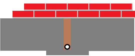

So, this is what he's proposing I think :)

But I spoke to my builder friend a bit ago and he said no matter what I still need to shutter around the pipe as concrete cannot lie on top because if there's any movement in the foundations or ground it'll take the pipe with it...
But you would have 50mm space for any up/down movement.
Burying it under the concrete wouldn't make a jot of difference.
However, just sleeve it with some slit gutter down pipe. Plug the ends with insulation then tape the DP with some duct tape.
