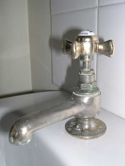

Bristan tap cap
18 Feb 2007
33
Surrey
Does anybody know how to remove the cap from a Bristan tap. I'm not sure whether it screws off or whether it is snapped on. Their website just says "remove the indice cap" Very bl**dy helpful!! :mad: I'm trying to replace the washer because it drips.
Cheers
Photo please, or at least the name of the model of tap - there are tons of different ones.
If it's the cheap type you flip the flattish chrome part up with a knife blade to reveal a screw.
It's screwed on. If you don't have the right kind of grips to use , then try grabbing it while wearing a rubber glove on your hand.
