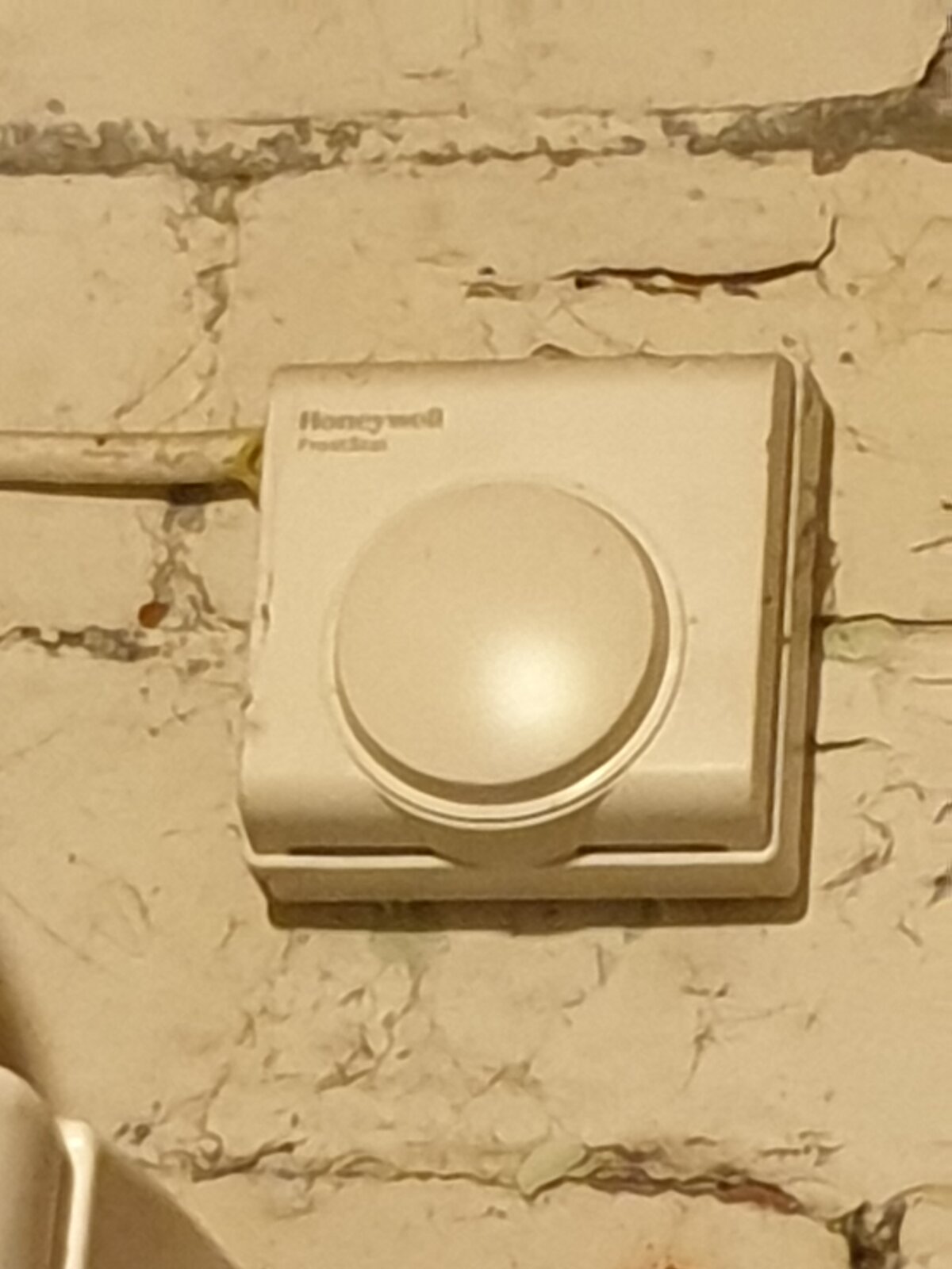

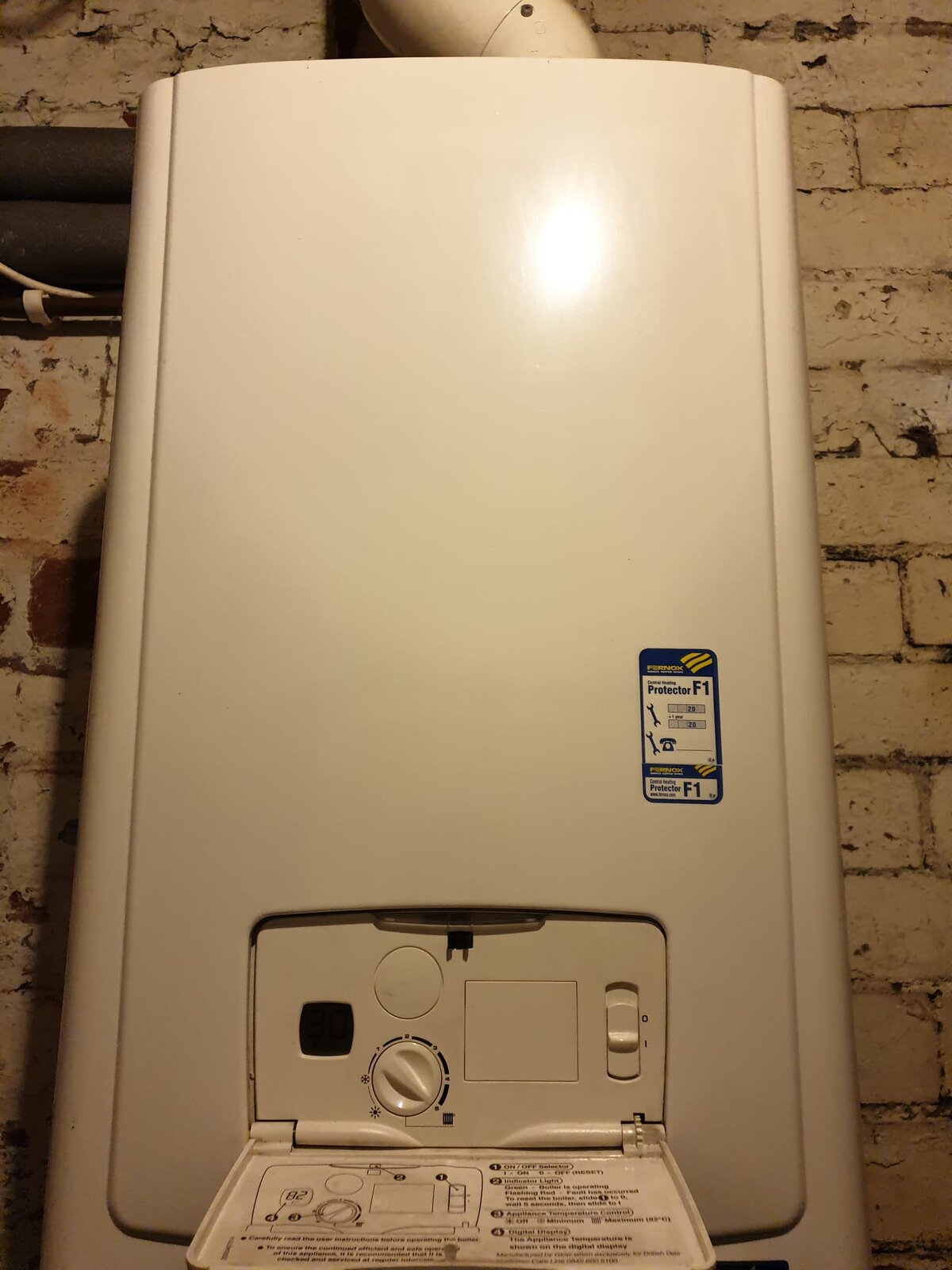

Hi,
I have a Glow Worm 330 heat-only boiler installed in an outhouse that has a frost protection system that kicks in to stop the pipes from freezing. It has been using between £6-£7 of gas a day when I have been away with work.
It's currently -4 degrees so I don't think I can turn the boiler off as the pipes may freeze. It's insane how much the bills are considering I'm not even home and the heating is switched off.
I know there is a frost protection thermostat in the boiler that is meant to fire if the temperature drops below 8 degrees. I also have a pipe thermostat on the return that is meant to turn the boiler off when the water in the system hits 10 degrees. The issue is that the temperature in the house is 15 degrees and the heating is coming on and the radiators are warming up.
Is there a fault? Any guidance on how to reduce gas usage would be greatly appreciated as it costs me a fortune to not have the heating switched on.
Many thanks!

Generally that's how frost protection systems work. They circulate water through the system but when the return temperature water to the boiler reaches 10C it goes off. So the radiators shouldn't really get that hot before the return flow temperature hits 10C, and if they do not for very long, although the radiator inlet pipes may get hot briefly. If you think the system is warmer than necessary to provide the necessary protection against freezing, then you could lower the froststat to 5C and the pipe stat to Min. But I would monitor it for a while to make sure it is still working to provide a sufficient level of frost protection to the parts that are outside of the ambient house temperature.

In the past, I've set pipestats to more than 10C (Mr Cautious) and the radiators do start to heat up as the boiler will supply them with hot water as if they were on normally. However, it only usually takes a few minutes for the return pipe to reach 10C and they go off again. Pipe stats aren't that accurate, so maybe that's some of the problem with yours and it's letting the return pipe get above 10C. If you have a thermometer you could check it. A replacement pipestat costs about £30-40
I notice that the pipestat cable isn't secured under the cable clamp properly so you might want to attend to that, although that's a safety issue, it won't effect its operation.

Yes, I was thinking the same thing about the pipe thermostat, I think this is where the issue may be. I put my hand on the pipe under the insulation and it was red hot. I would say well above 10 degrees with the heating switched off. Is it a simple job to replace the thermostat?
They are held on the pipe with a spring that clips it on, and there are a couple of wires to remove and re-attach. [Note the use of the cable clamp in the pic below ;) ] Make sure that you get a pipestat with the same temperature range as yours. There is a cylinder thermostat that looks identical but has a different operating temperature range.

I found the frost thermostat behind the boiler. I guess the boiler kicks in if the outhouse is less than 5 degrees which is all the time at the moment. The water in the system is at 35 degrees and the boiler is still firing. Surely the water in the pipe doesn't need to be 35 degrees for the pipe thermostat to register the temperature as 10 degrees?

A simple test of a mechanical thermostat, is the 'click test'. Sweep the setting knob back and forth, it should produce a distinct click going each way, one the on temperature, the other the off temperature, which will be around 5C apart, plus somewhere in the middle should be the actual temperature the stat is measuring.
Unless there is some heating in the space, other than the boiler, that stat will never be satisfied. Probably best to set that to minimum, off and maybe add a pipe stat in it's place - but attached to the boiler.
Alternatively, you could try experimenting by somehow attaching that existing stat, to the boiler casing.

In theory, the pipe shouldn't be 35 degrees, it should be no more than 10. But there are possibilities that may make it so:
1) The boiler has a pump overrun that even when the pipestat turns the boiler off. The pump continues to run for a few minutes to dissipate residual heat in the system. Depending on the design of your system it may be possible for some hot water to get back to the boiler without loosing a lot of its heat. For example, my boiler has a by-pass between the boiler flow and return and when the motorised valves closes, this effectively creates a short return circuit in and out of the boiler, so that would raise the temperature above 10C (there are other scenarios as well). The acid test is that even if it did hit 35C, the boiler should be off at this point and should not come back on until the pipe falls below 10C.
2) Something else is demanding heat from the boiler, or has been recently. Are both CH and HW off at the programmer and have been so for some time?
