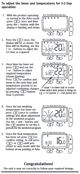

We have a British Gas RC Plus programmable wireless thermostat -but I think it's actually a Drayton Digistat +3RF that's been rebadged by BG. BG had set it up so we had one set of timings for weekdays and one for weekends i.e. in 5-2 mode. We had to change the batteries the other day and now it's reverted to 7 day mode, i.e. we have to set timings for each day separately. I can't find any instructions anywhere on how to set it back to 5-2 mode. Can anybody help?
Yes that's the one. But nothing there I can see about how to toggle between the 5-2 mode and the 7 day mode, only how to set the programs when in each mode... unless I'm missing something?
Follow the instructions carefully:
There isn't a setting for that.
If you want to set Monday to Friday in one go you need to press > then press + 7 times, it will go through all 7 days individually then on the 7th press it will go to Monday to Friday then press > to set your program once you have set the 6 times and temperatures it will go to Saturday and Sunday's settings.
