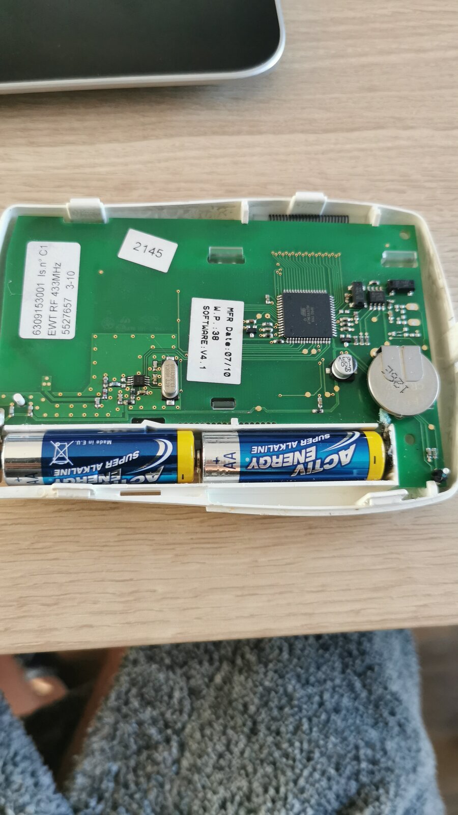

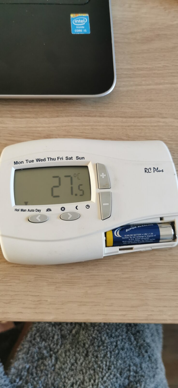

Hi.
I'm having a similar issue as you. My current temp reading on the display is 31deg, but the actual temp in my room is around 9degs so to turn on the heating i need to adjust the manual temp to max 32deg. My settings are set out the same as shown in your video. It seems the RC Plus settings are different to the Drayton Digistat kindly described in the detailed instructions above, even though they appear to be the same model. I have a minimum setting set to 5deg (Option 4) and a maximum setting set to 32deg (Option 5) Neither are offset/calibration settings.
Tried changing the batteries, clearing dust from the display control unit, even re-connecting it to the signal box near the boiler. No luck :confused:
Would appreciate any advice how I can calibrate my RC Plus to read the actual temp.
Many thanks in advance. ;)(y)
Those programmable thermostats are absolute dire they compete with Salus at being the worst on the market, change it for something that will actually work

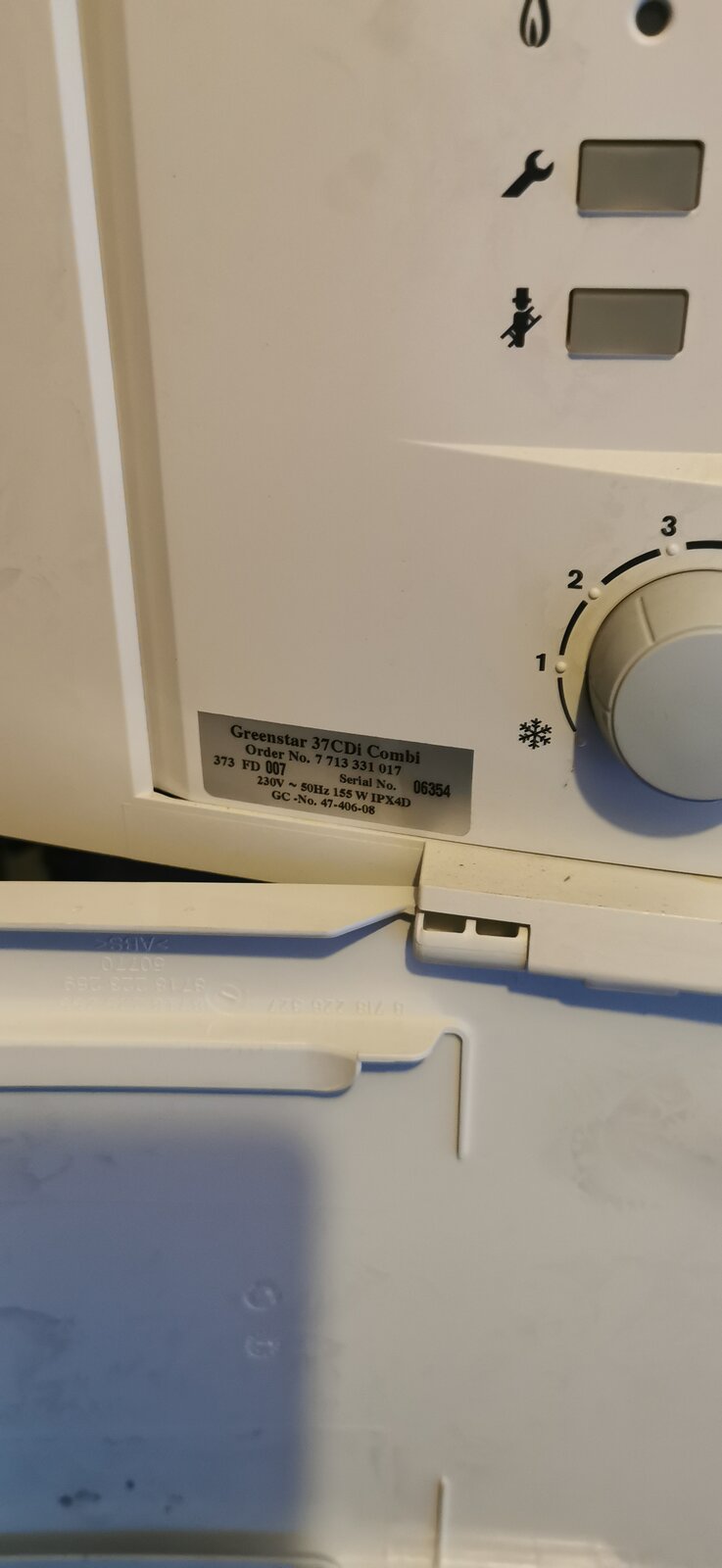

Hi, firstly, thanks for your reply it's very much appreciated.
Forgive my ignorance, I'm a chef not a boiler man lol. Can you suggest any wireless thermostats that would work with my current signal box near the boiler. I've attached some pictures of my boiler info.
Thanks again.
