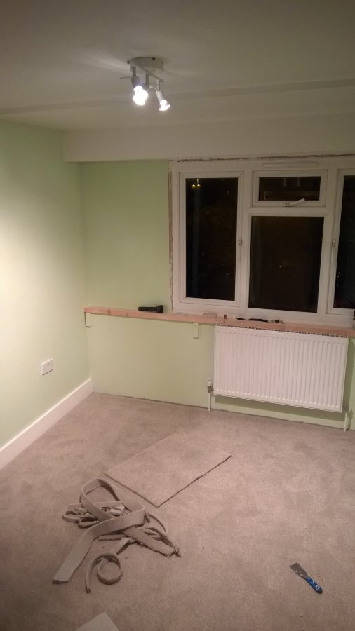

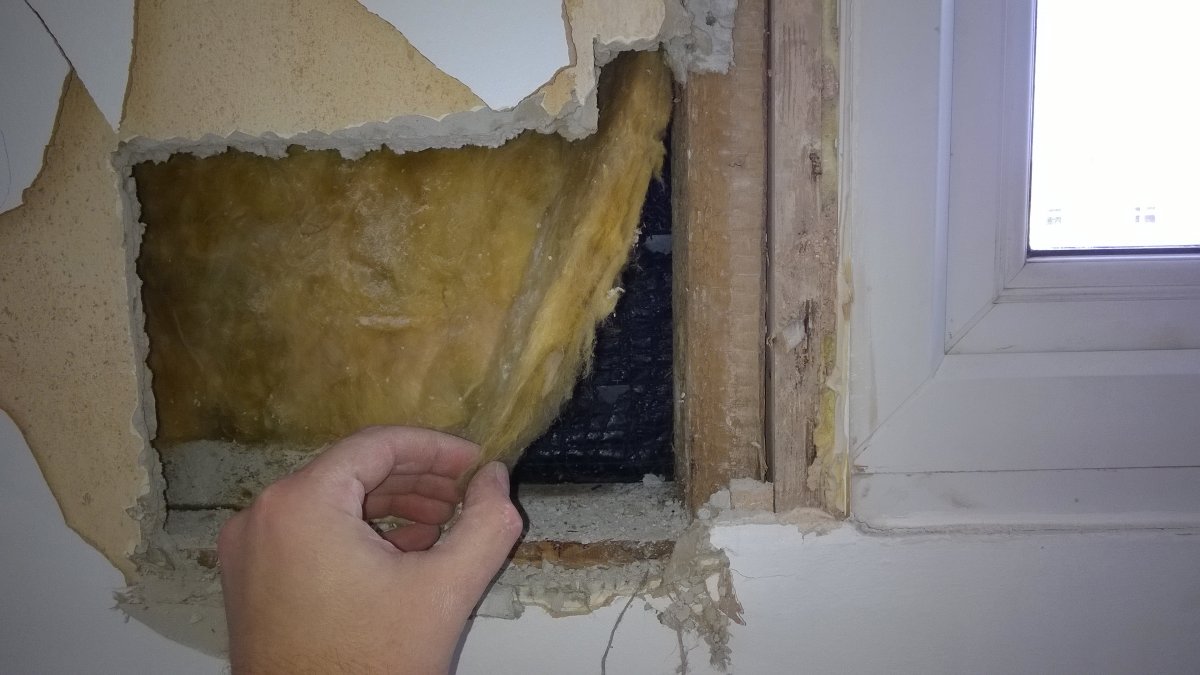

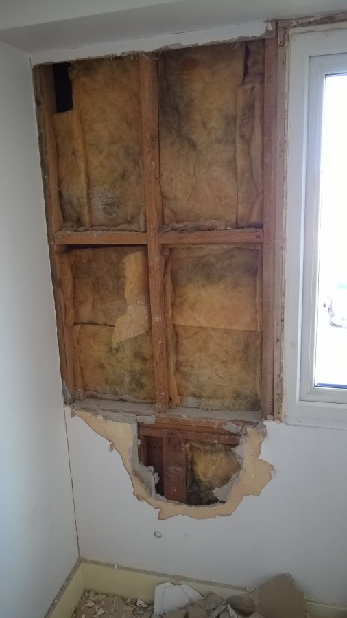

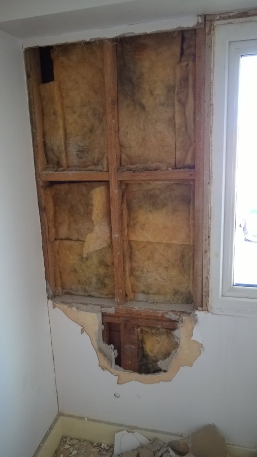

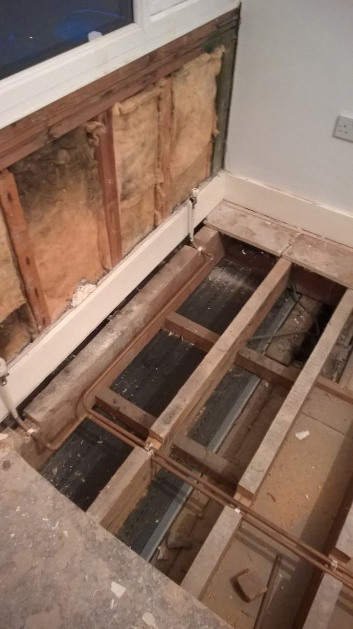

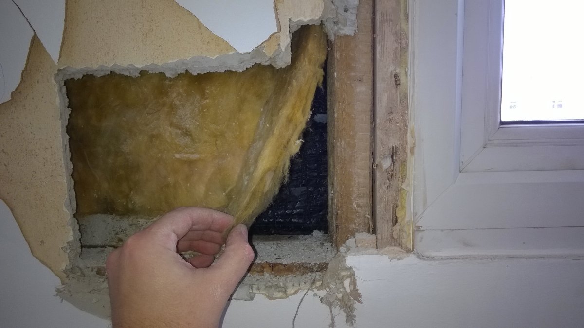

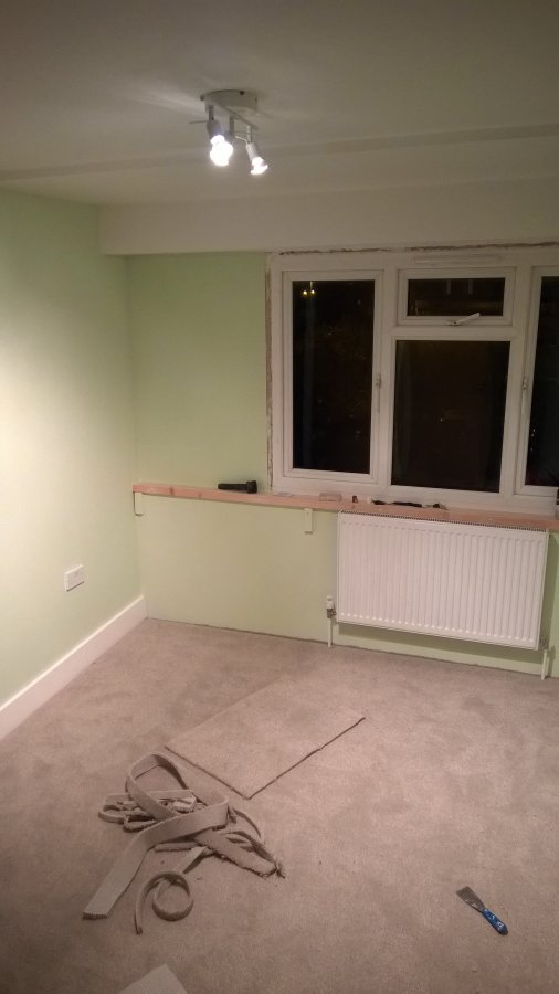

Started from first floor kids bedroom. Room windows facing north-east, so it was very cold and could feel breeze coming from somewhere.
Started ripping plasterboards to fit insulation, not much was found inside...

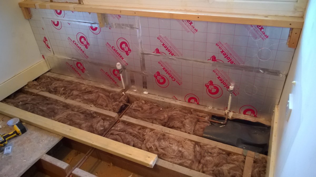

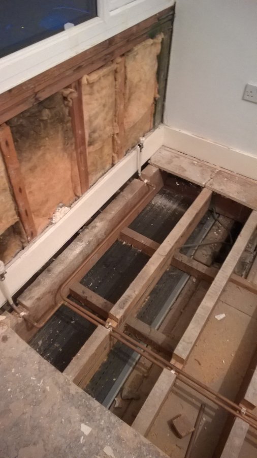

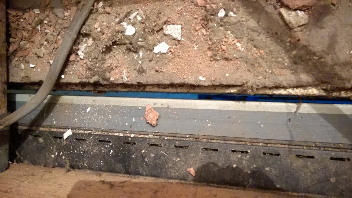

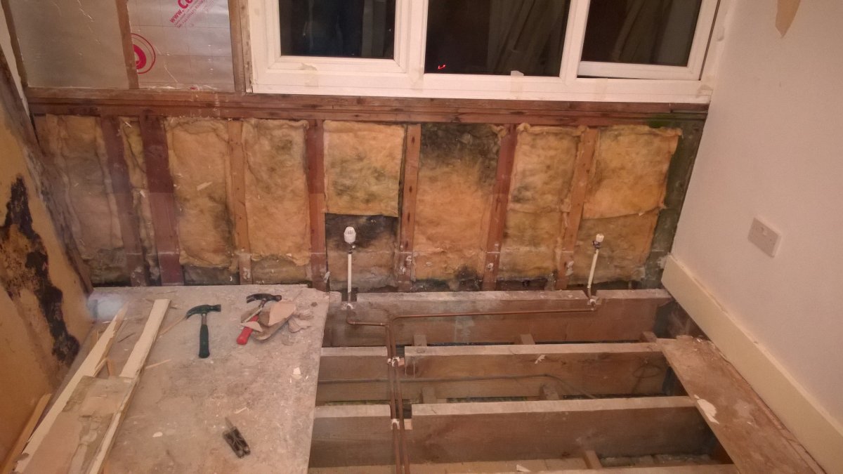

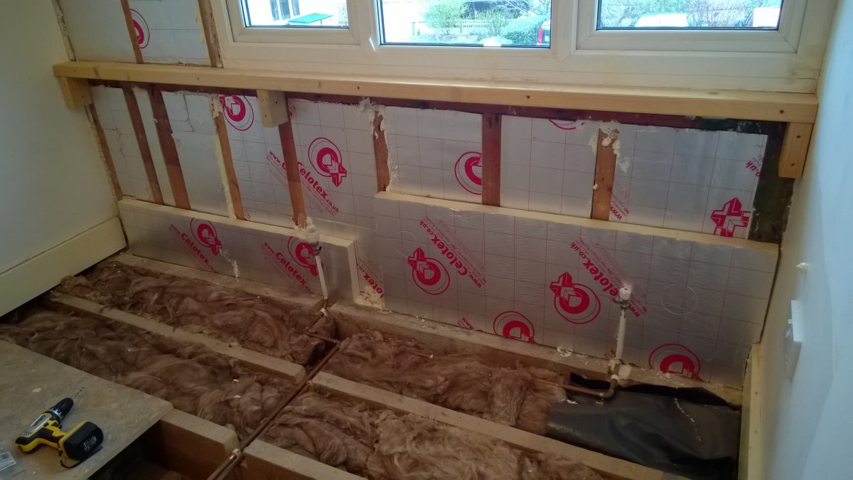

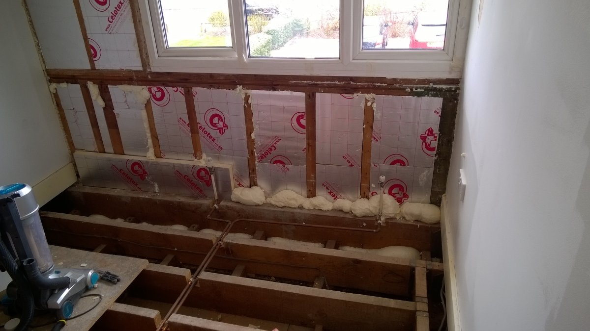

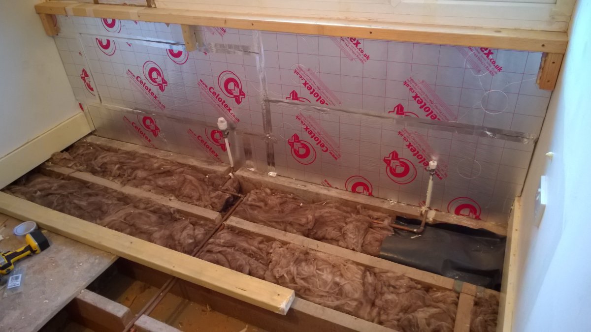

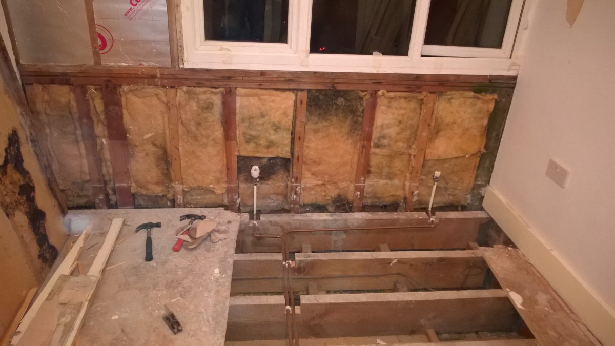

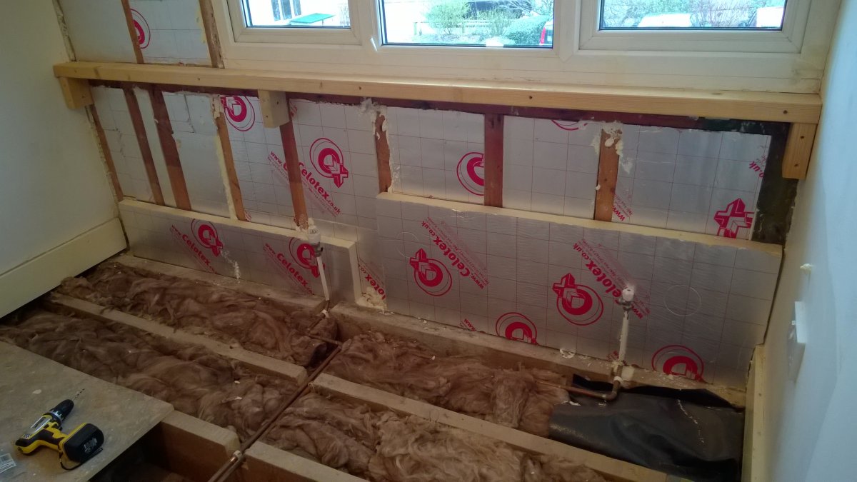

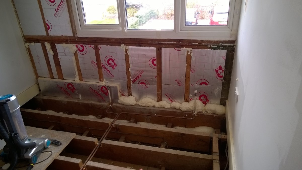

Ripping things out and fitting insulation. The first floor room has overhang to outside, and breeze was coming through exterior cladding as there was absolutely zero floor insulation and I could see streetlights through o_O All floorboards had mould on the underside :(

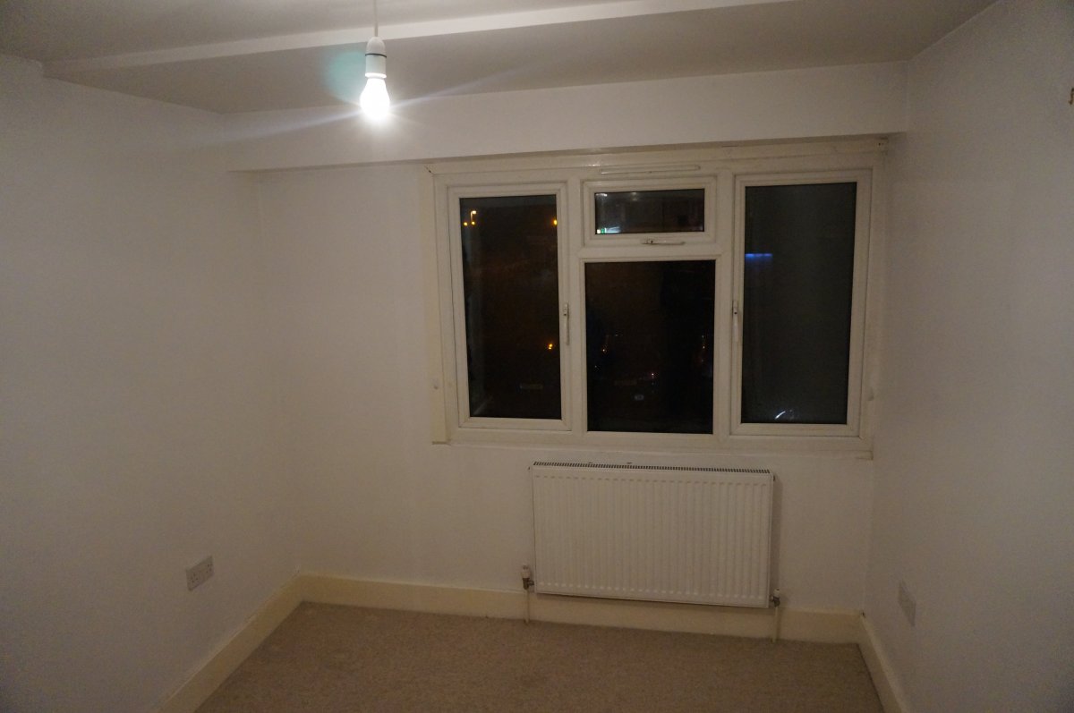

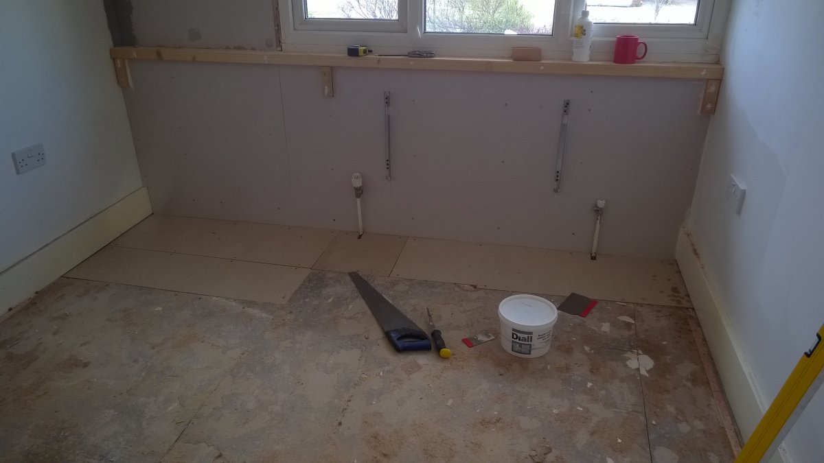

Should be warmer now...

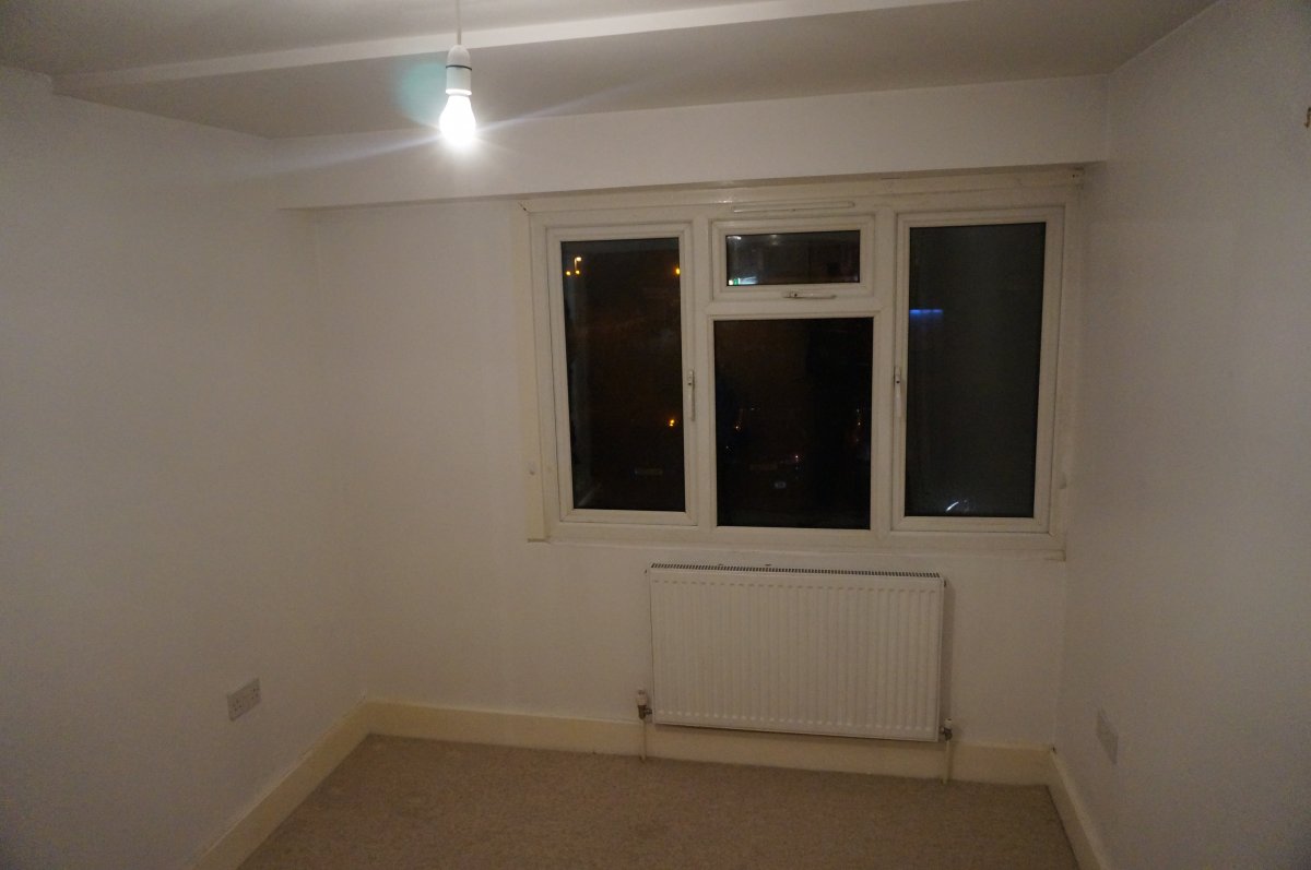

Progress

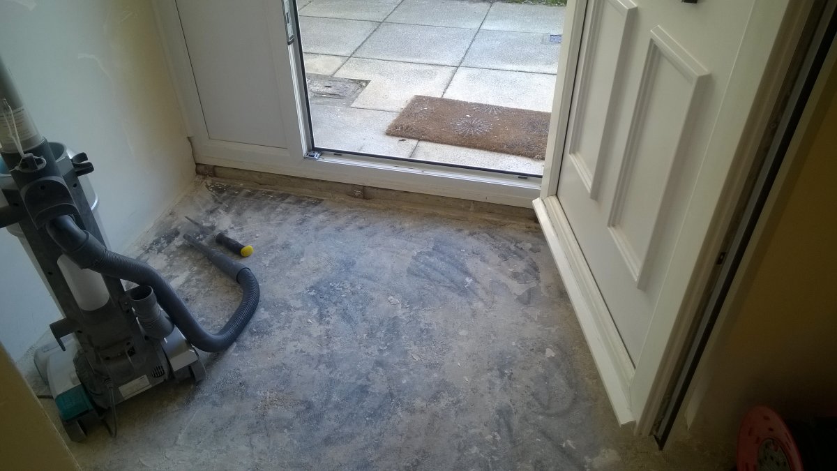

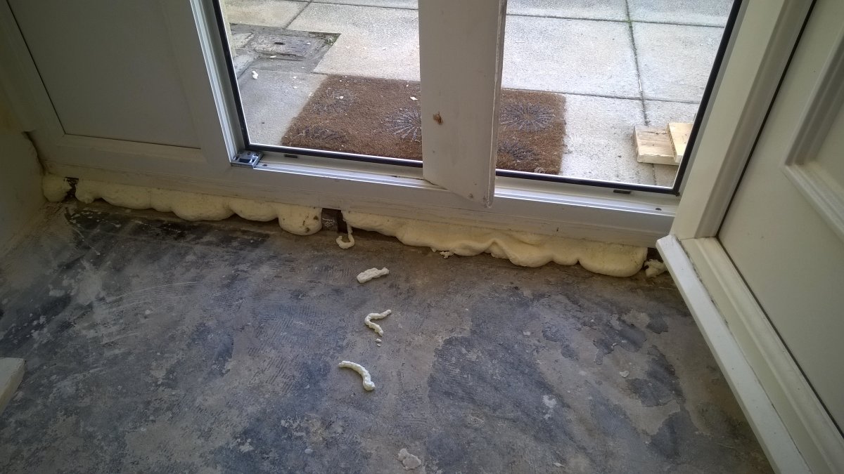

It felt like front doors are always open :)

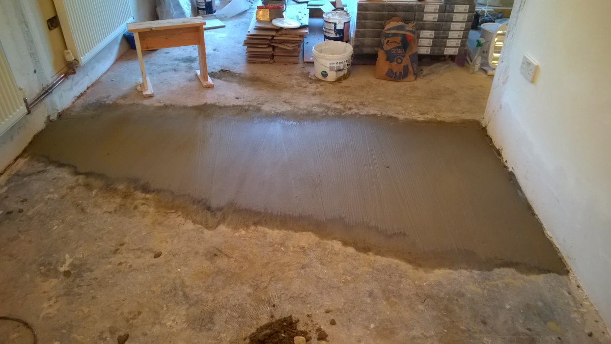

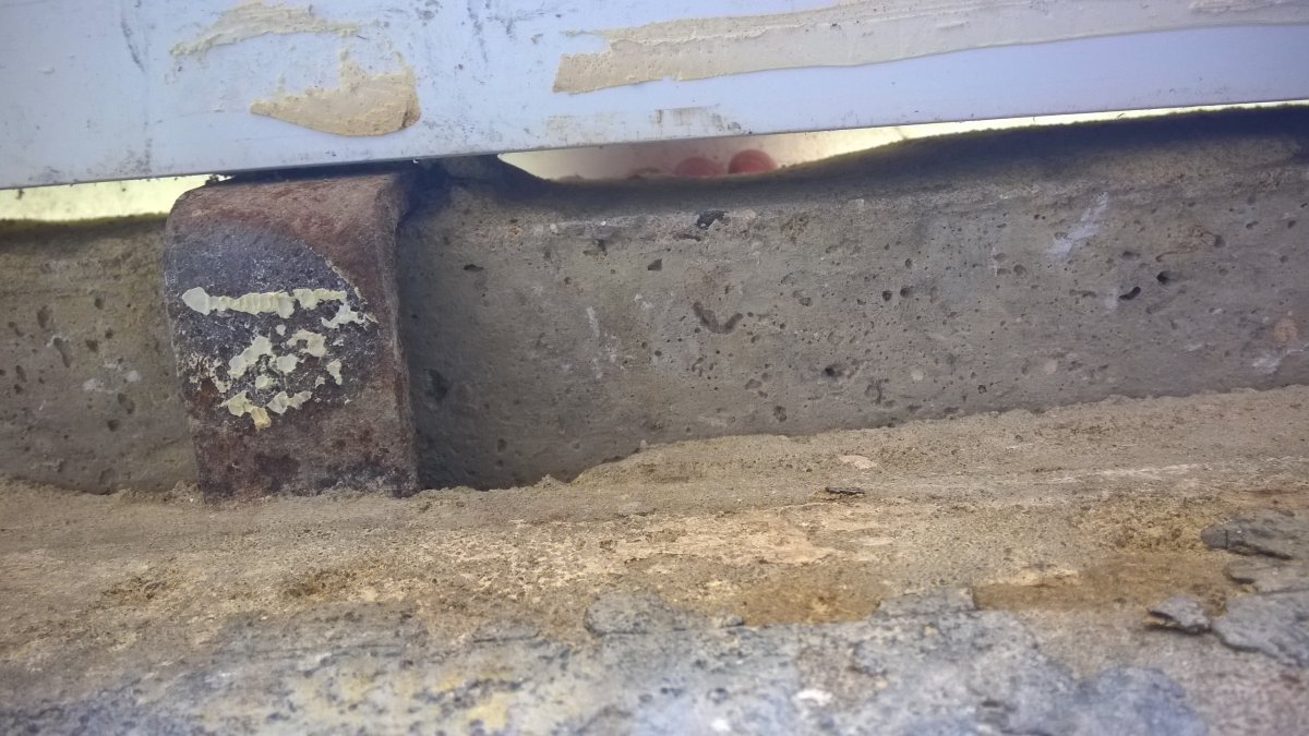

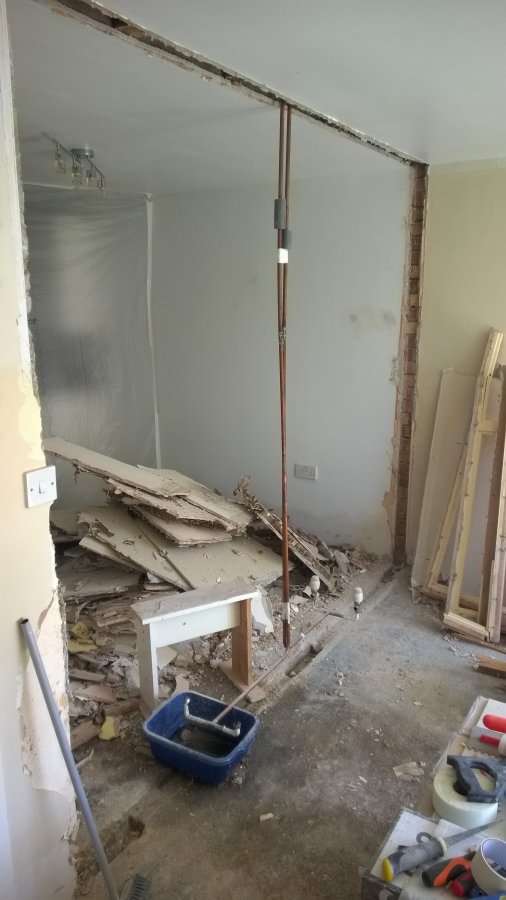

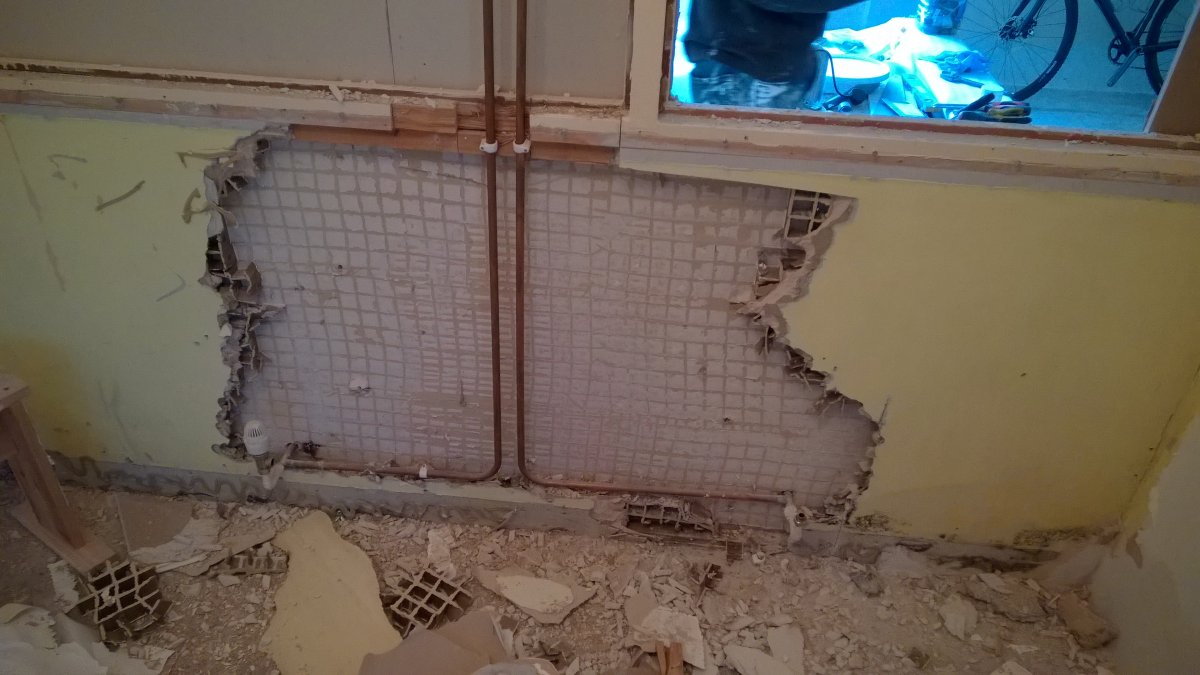

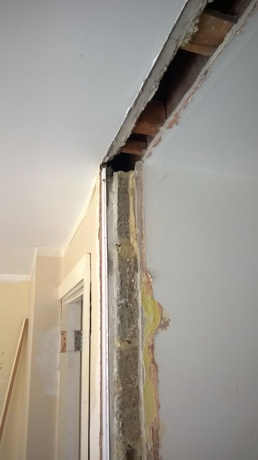

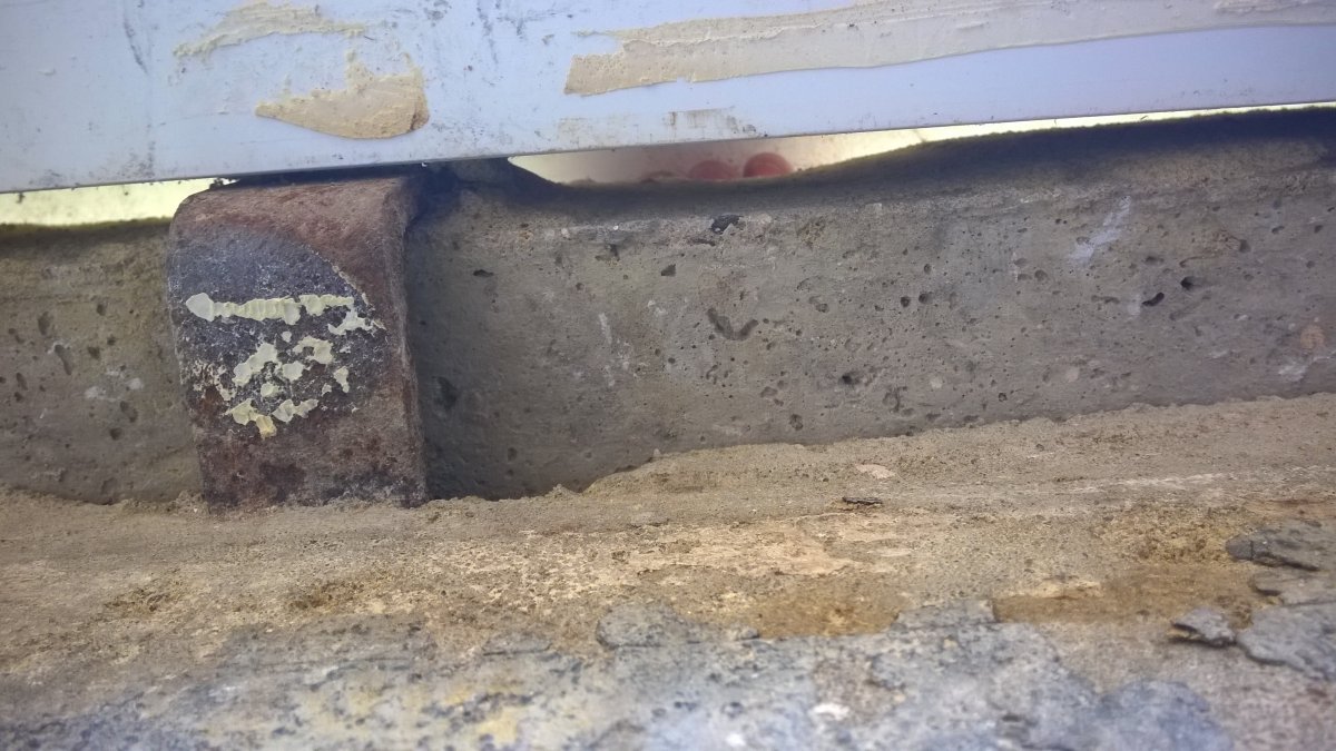

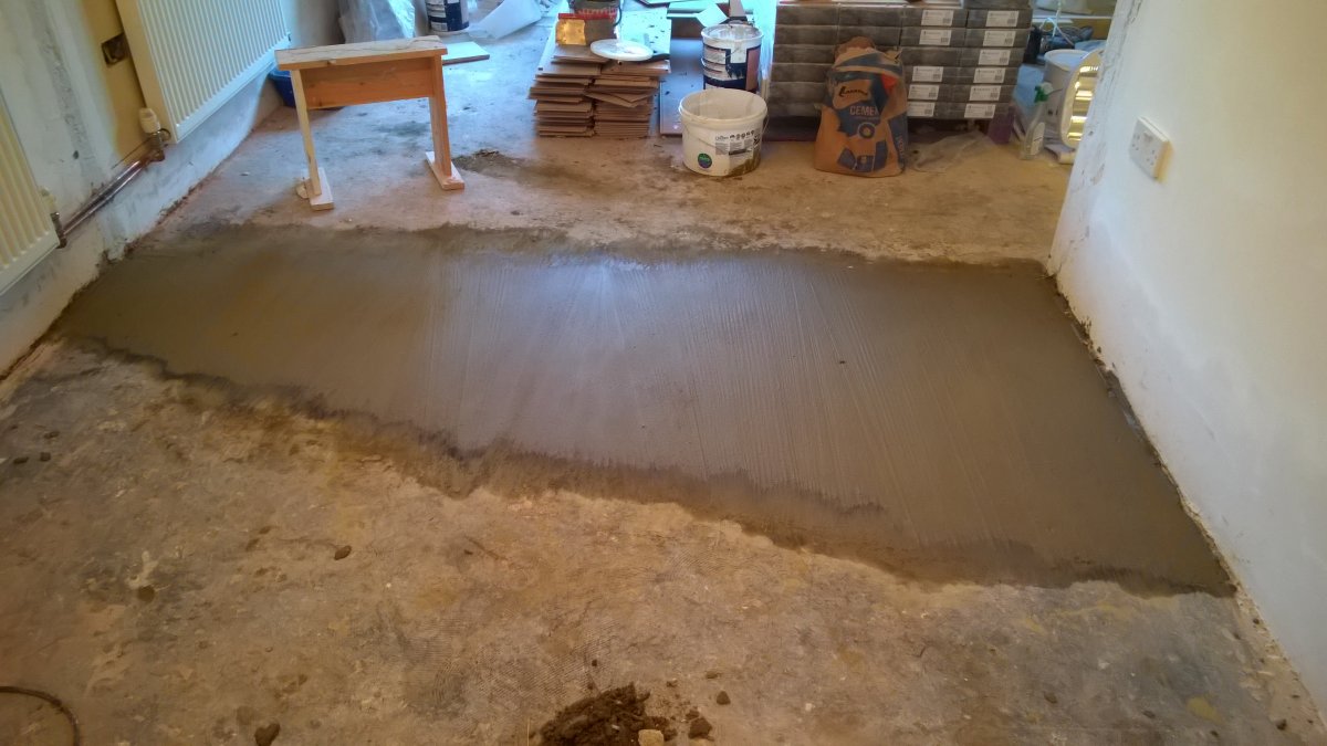

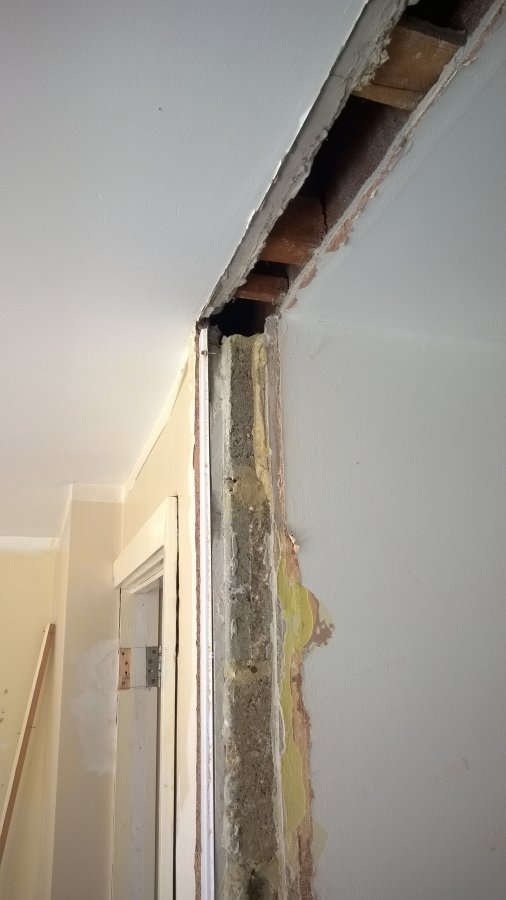

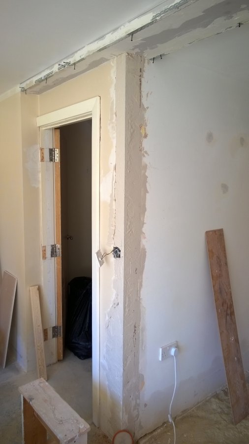

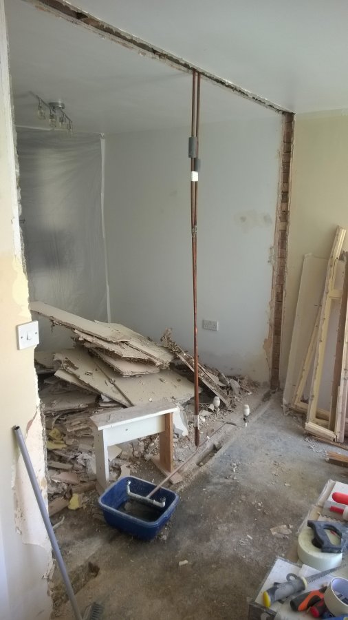

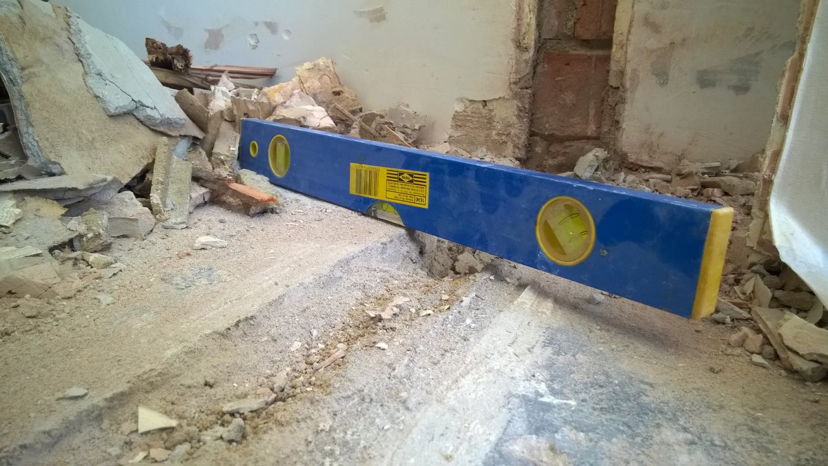

Decided to knock drywall between kitchen and living room. Ground floor - concrete slab everywhere...

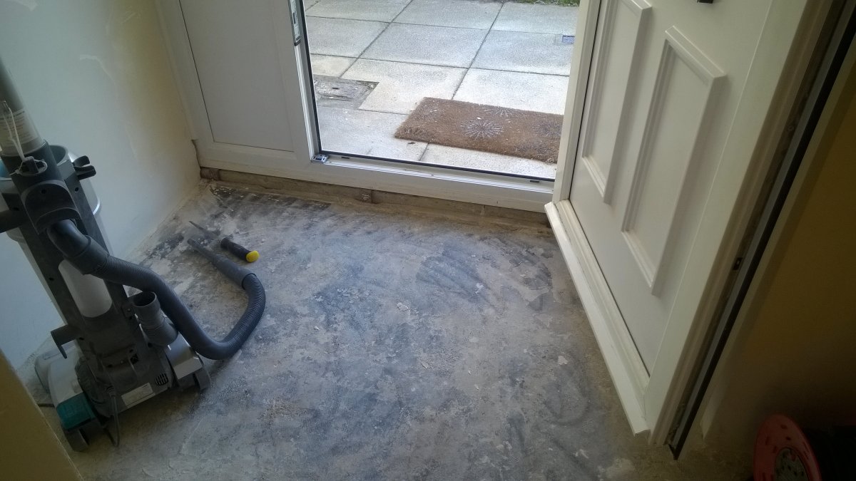

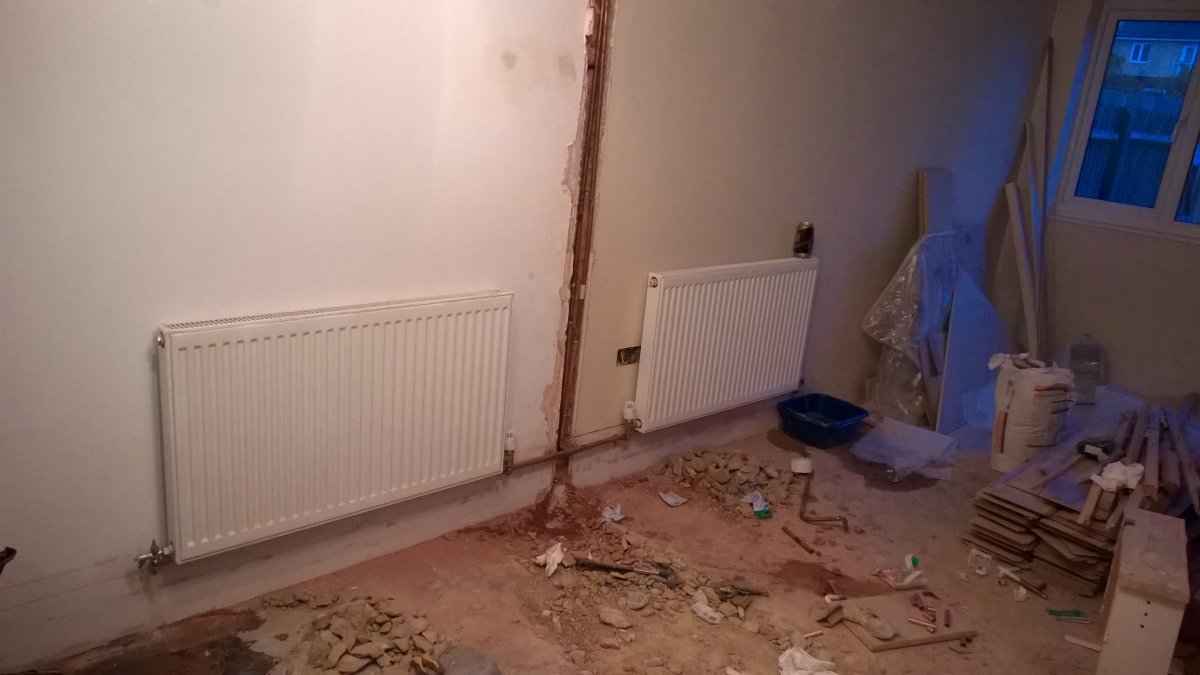

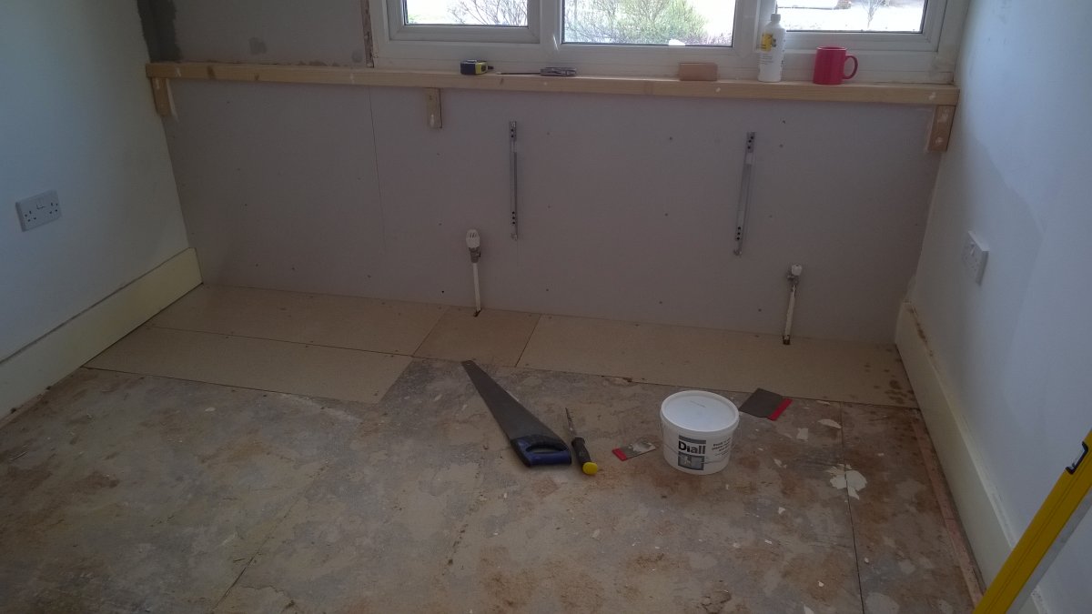

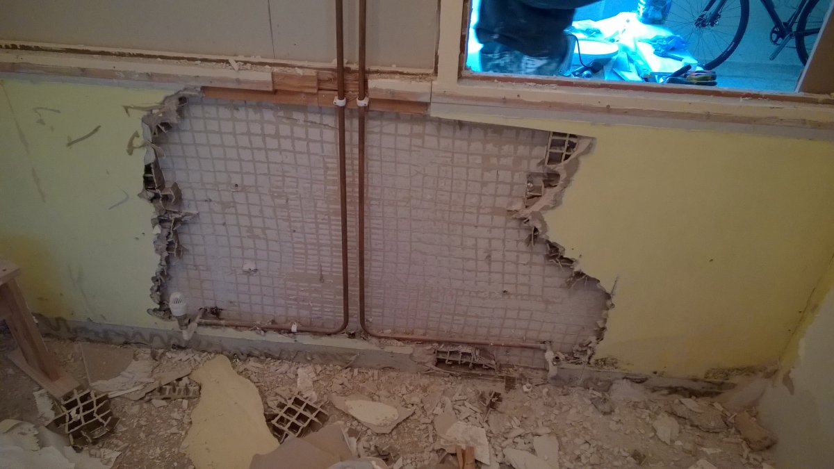

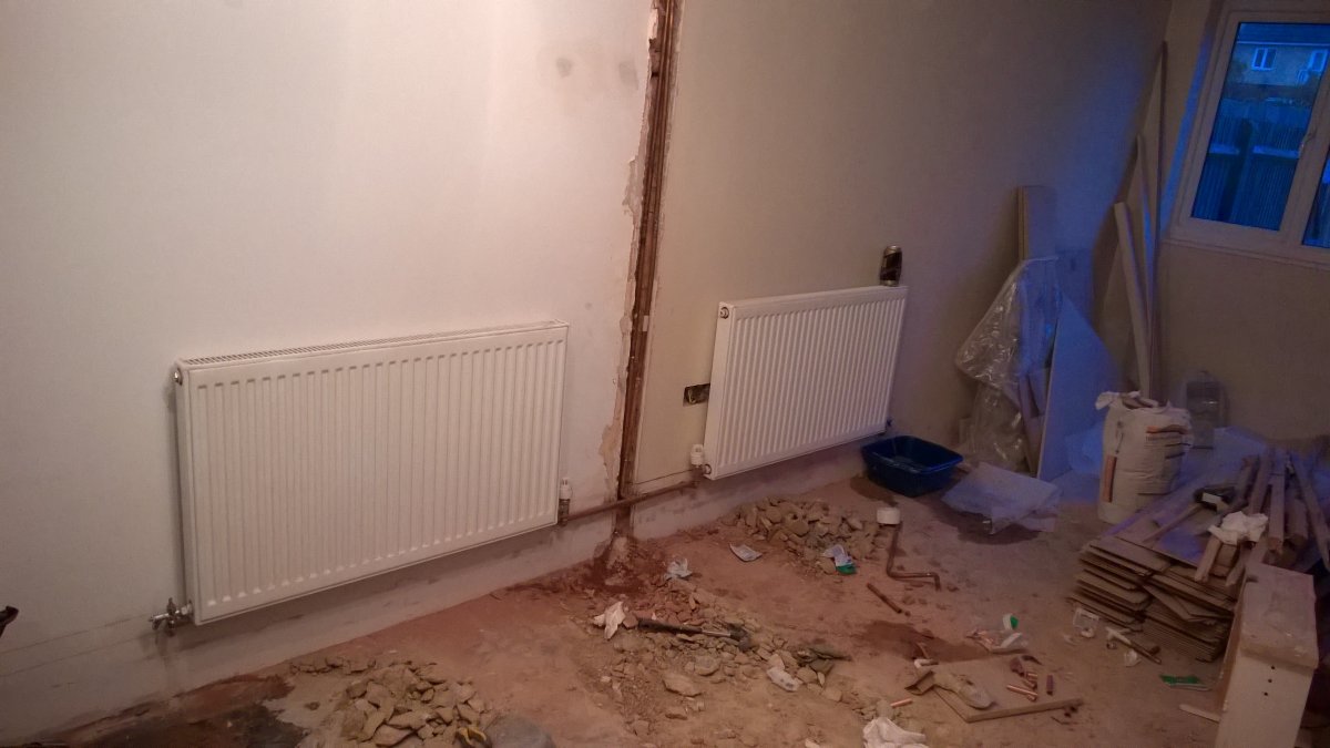

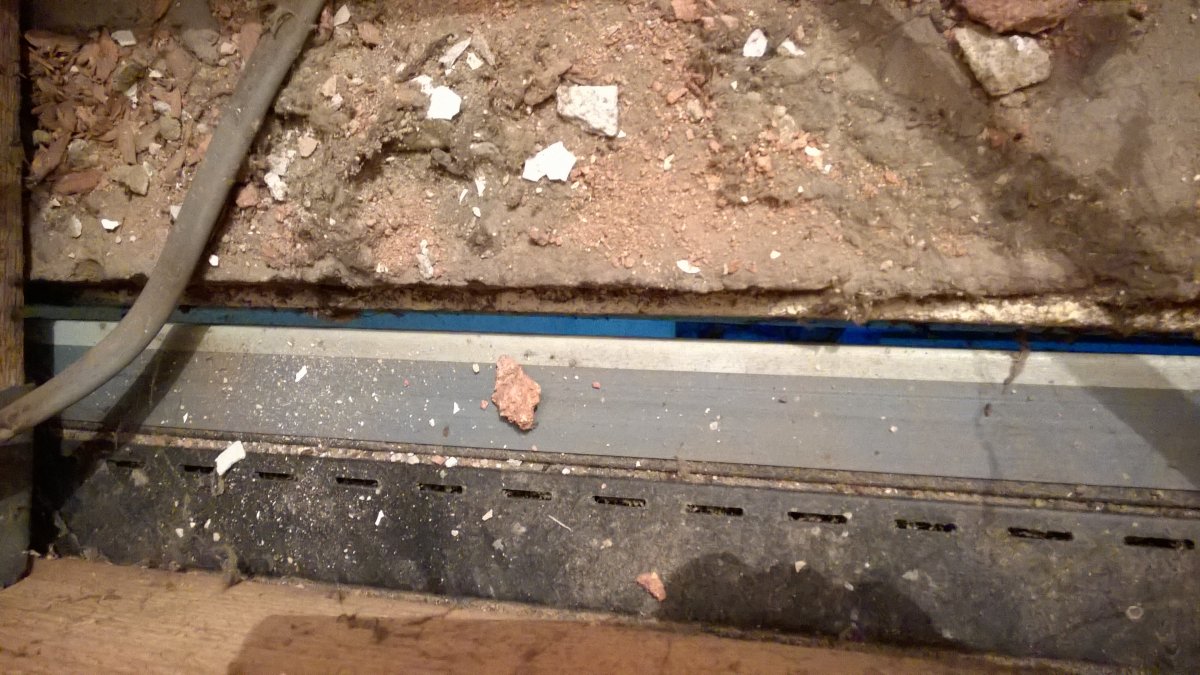

Fixing slab floor problems and rerouting central heating.

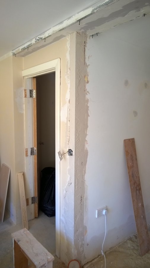

and built a plaster box to hide ceiling gap and level problem

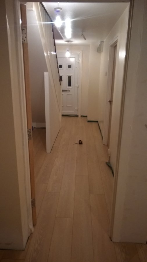

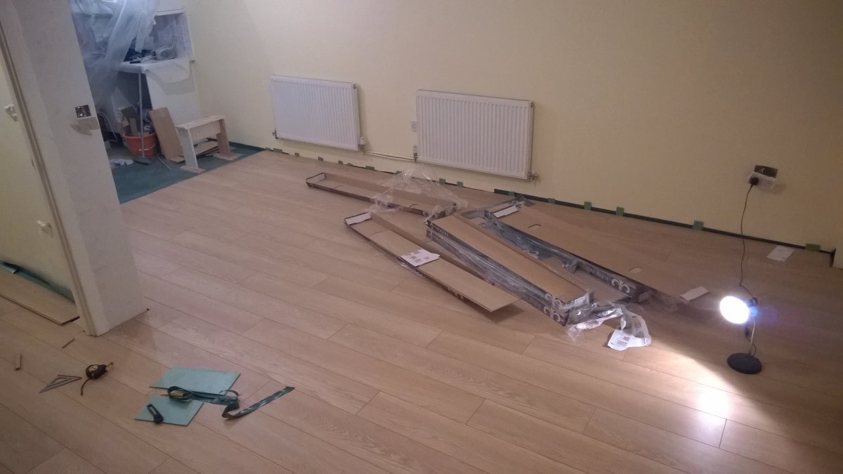

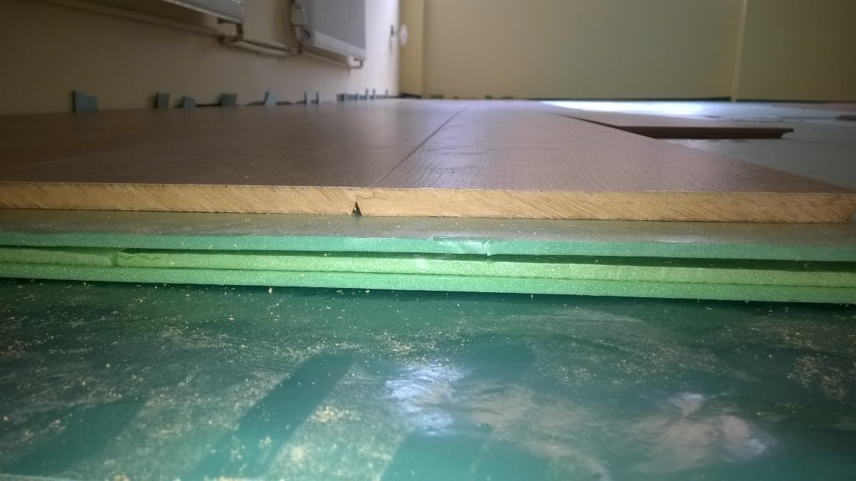

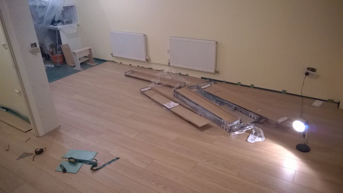

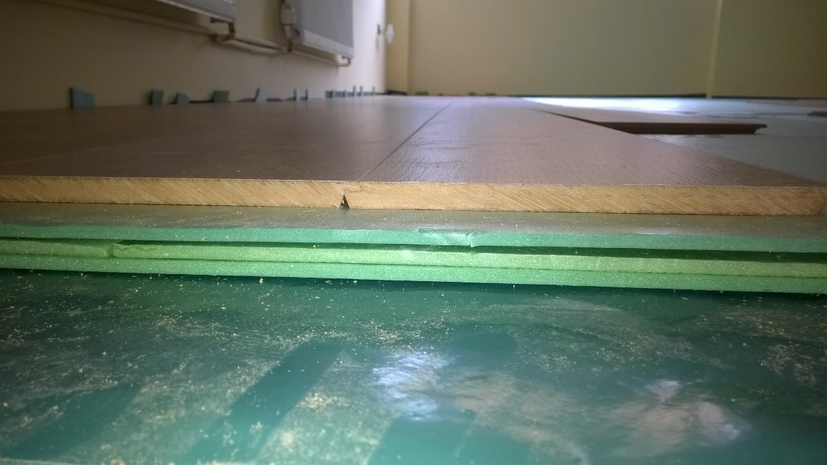

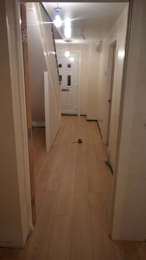

New ground floor, with insulation. Could not find proper thickness so had to improvise - 3 x layers of 5mm extruded polystyrene and vapour barrier.
