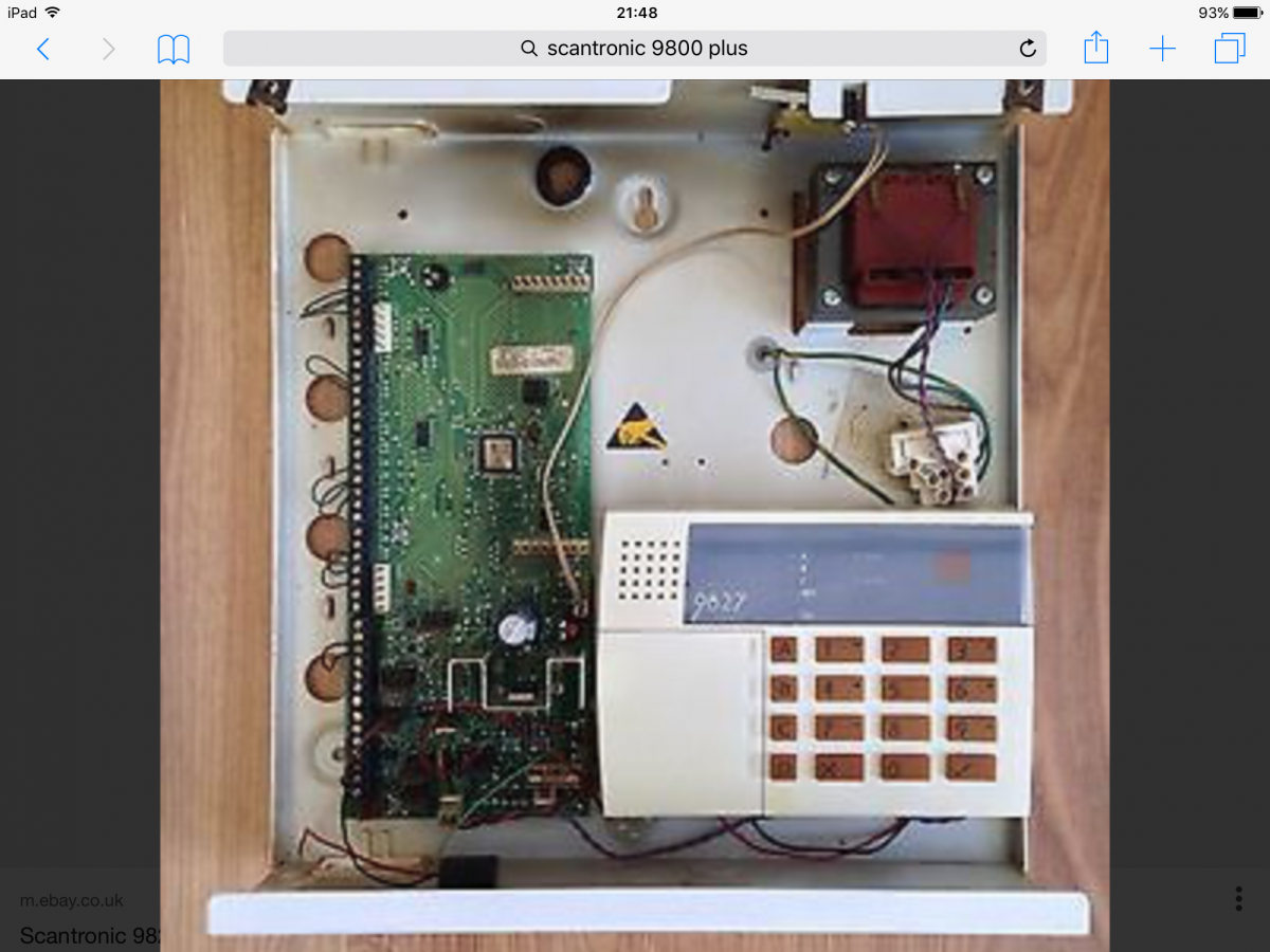

9800, if it's the old keypad small grey keys , then sooner or later you will have issues with the buttons , it can be defaulted , but will need a full reprogram , if it's the 9800 plus you can default the engineer and user code only, what's it showing on the keypad ?
It's the later keypad which is good , if the end station is a 9800 plus even better as it can be defaulted codes only , a service and replacement battery is probably all it needs
Thanks again for your help. How do I determine what the end station is? (Is that the box on the wall nearby?)
It will have more than 8 zones if a plus , it may have the zone extenders plugged on , there will be two sets of molex connectors next to the zone terminals

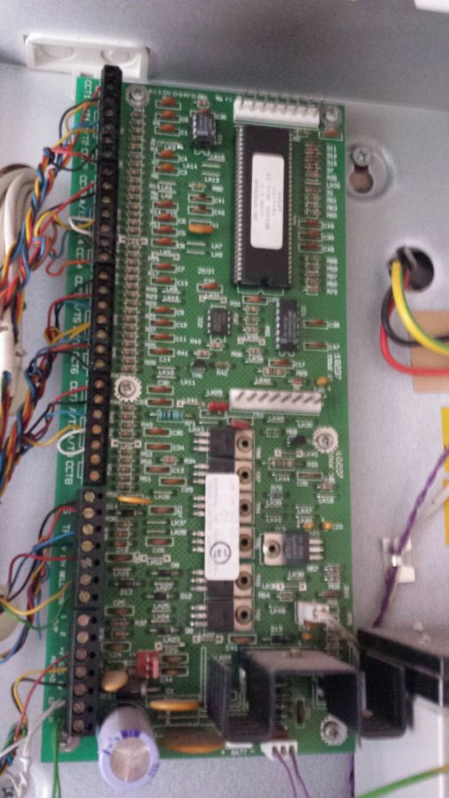

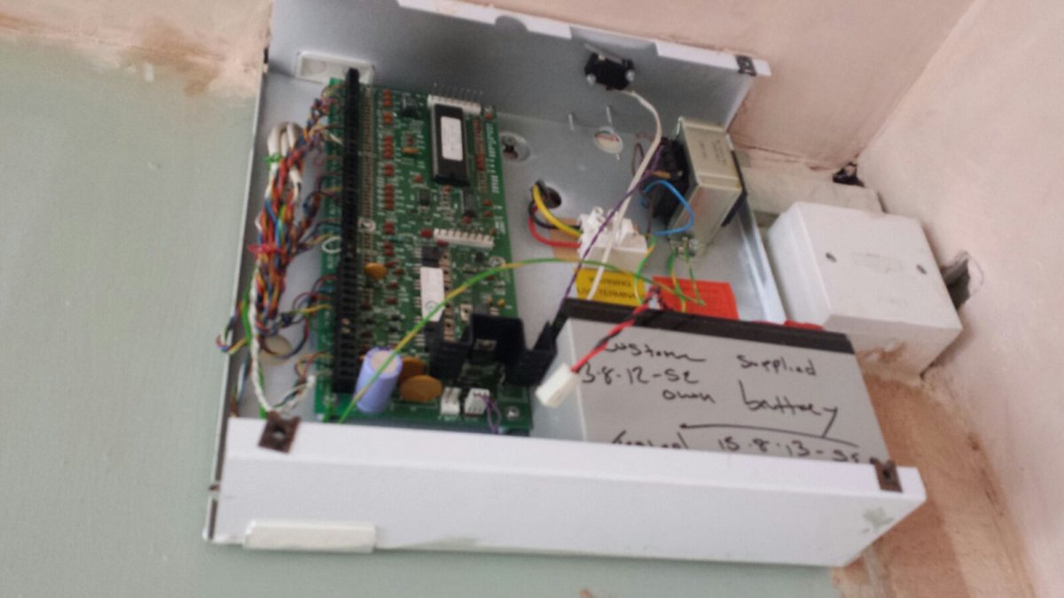

Hi,
I took a couple of photos of the end station. Would be grateful for any advice on whether it is a plus, and if so how I can reset the codes.
Many thanks.
That's a shame. How long would a reprogram take for an engineer? i.e. how much is it likely to cost?! (roughly)
Would guess a service and reprogram should be an hour , we charge £55 plus vat, plus parts
