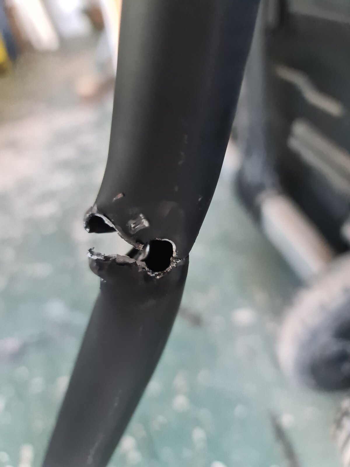

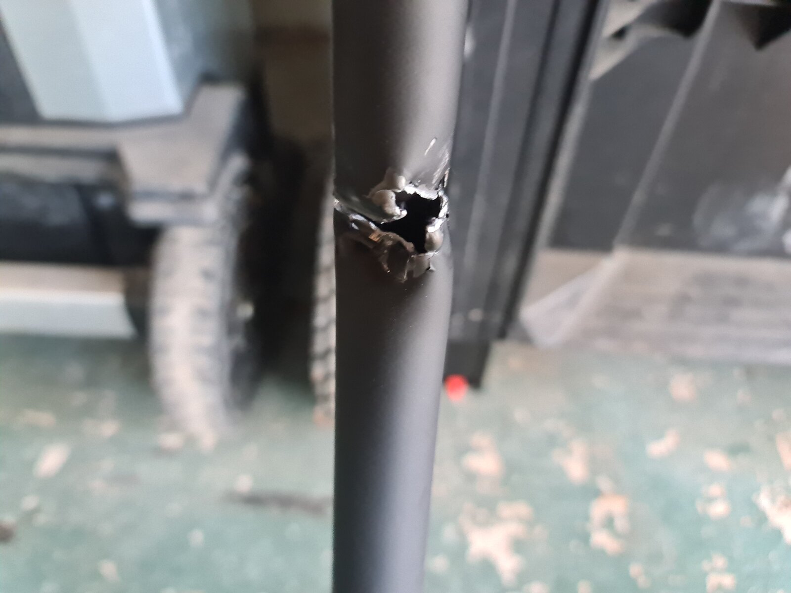

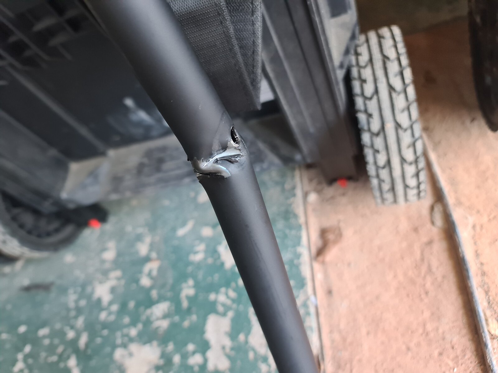

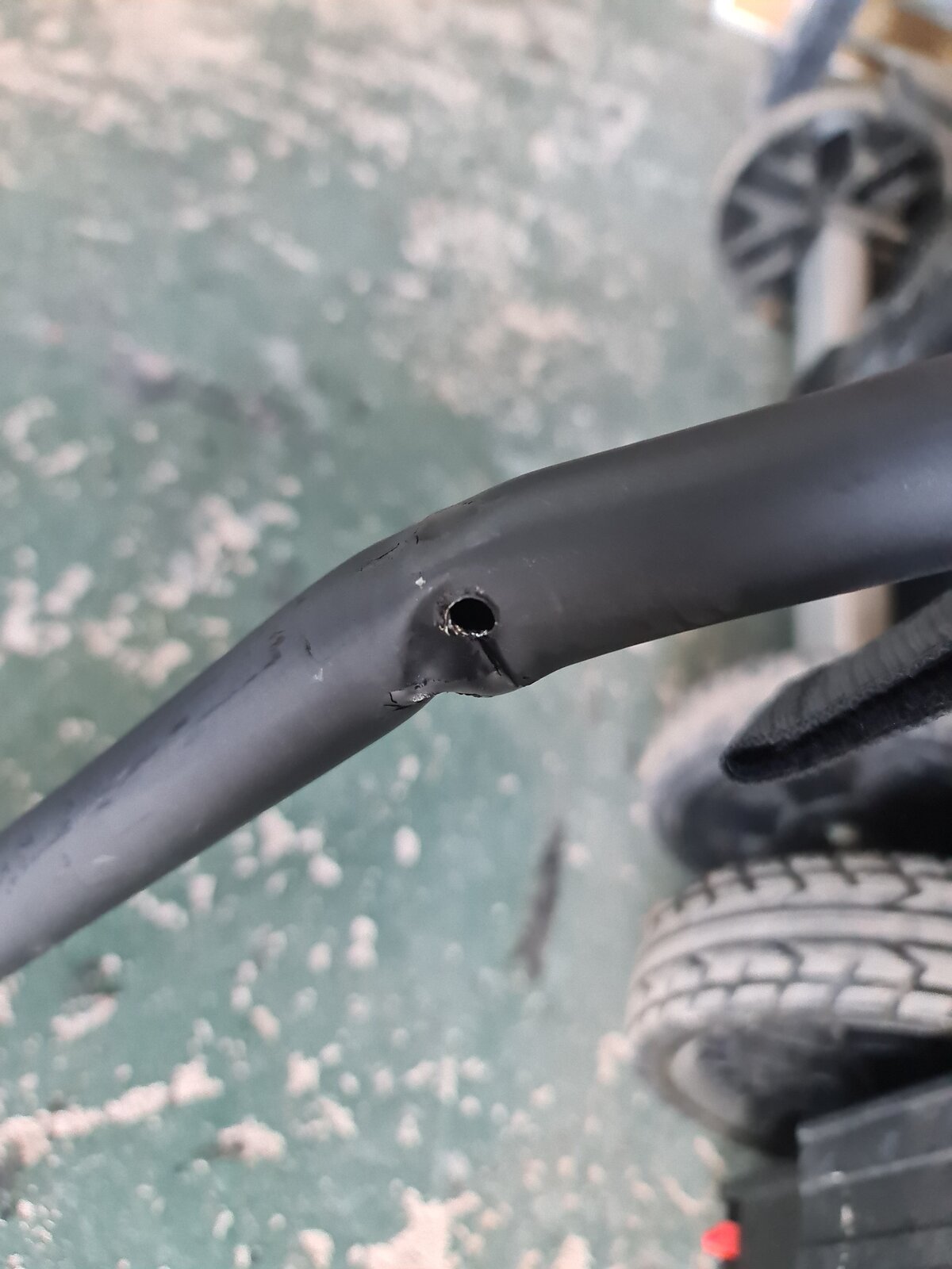

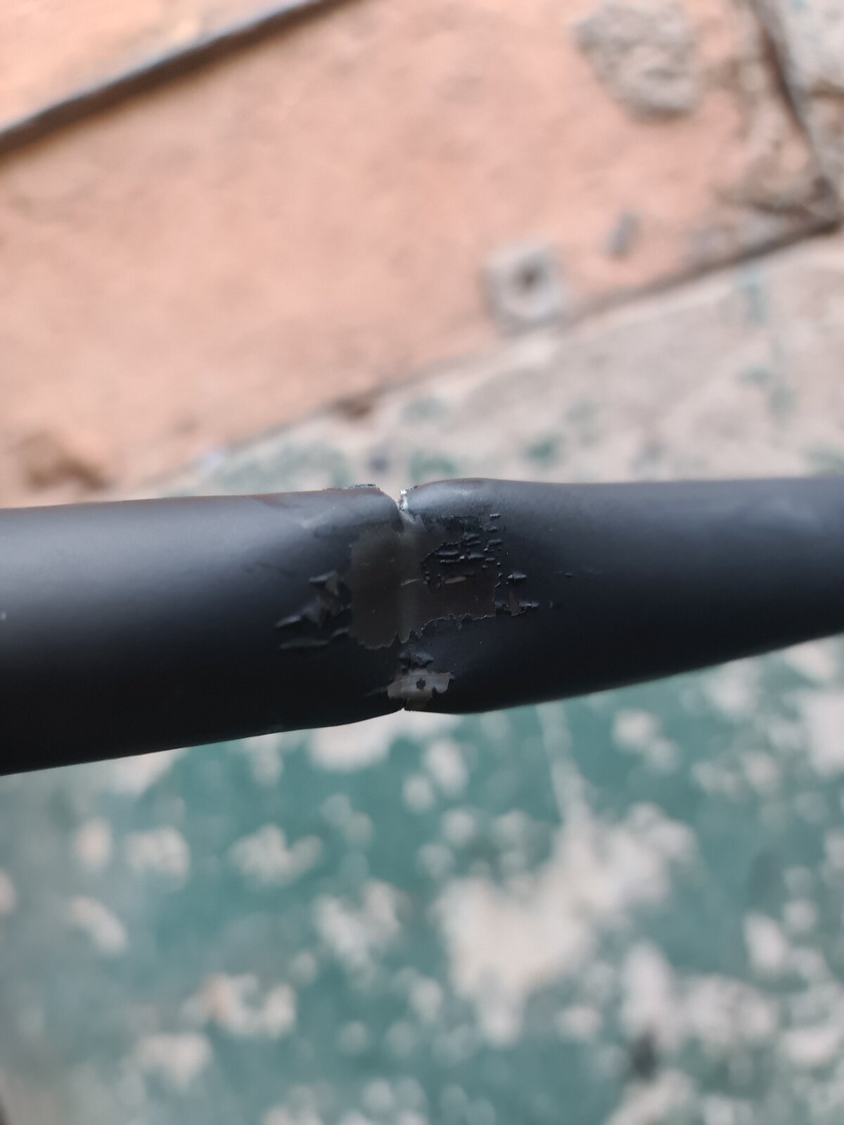

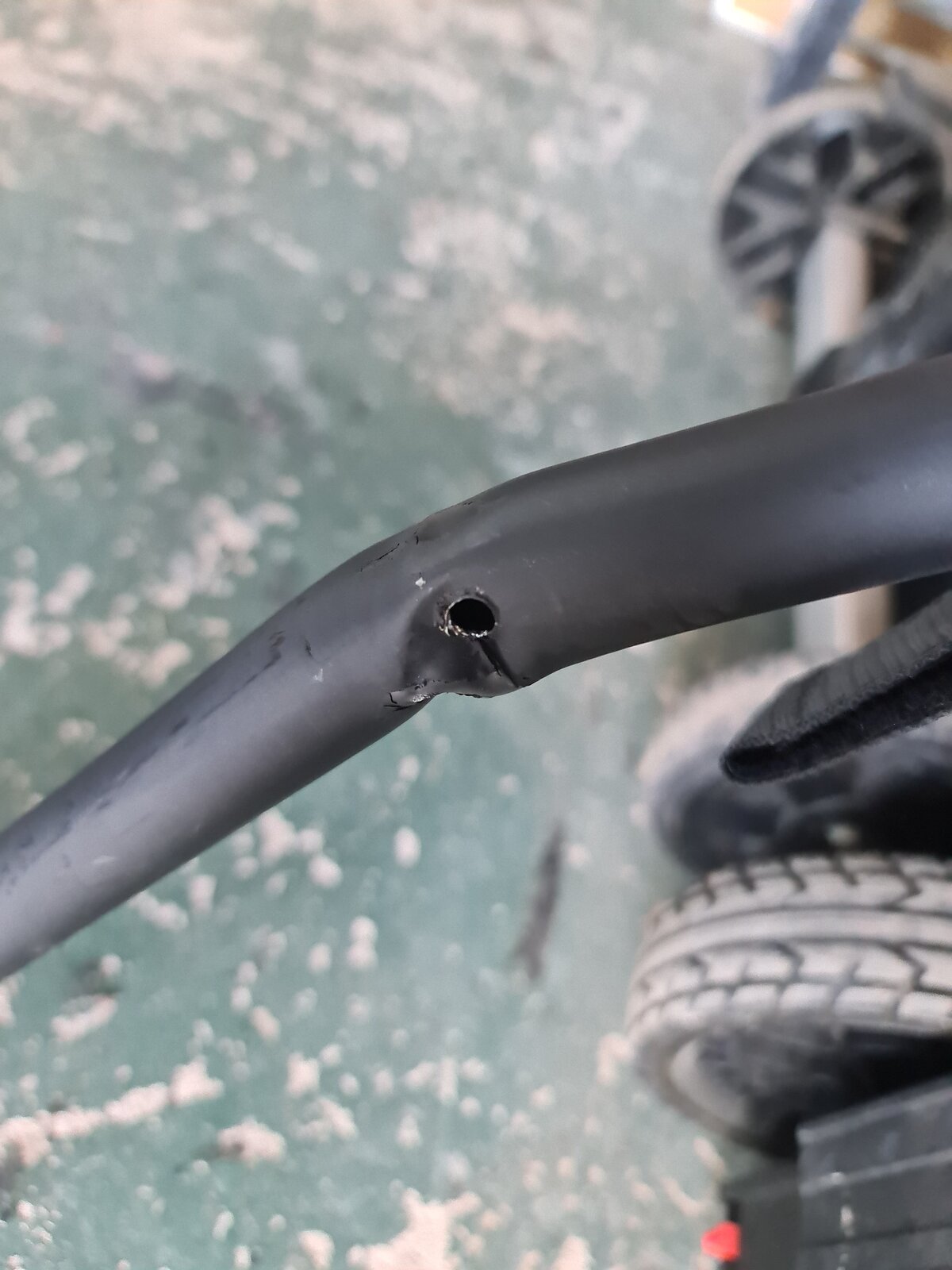

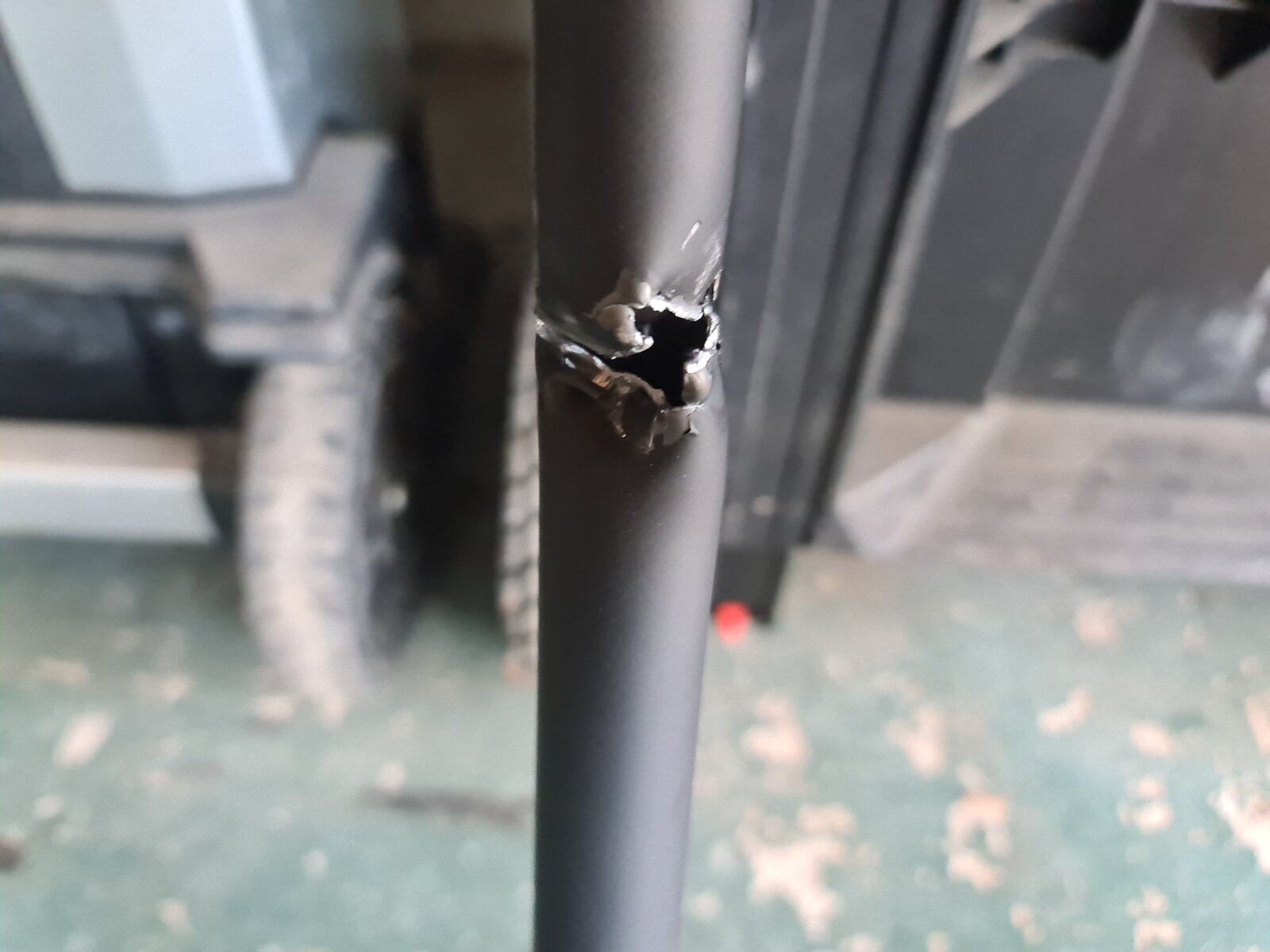

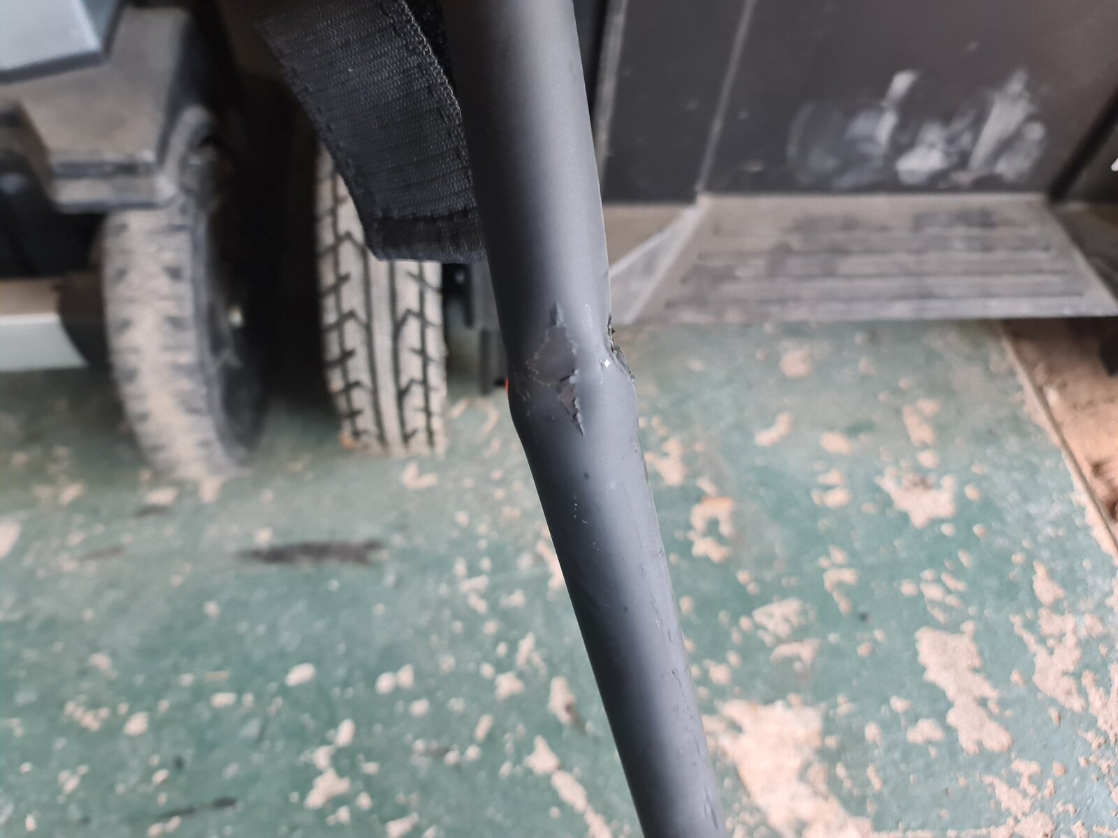

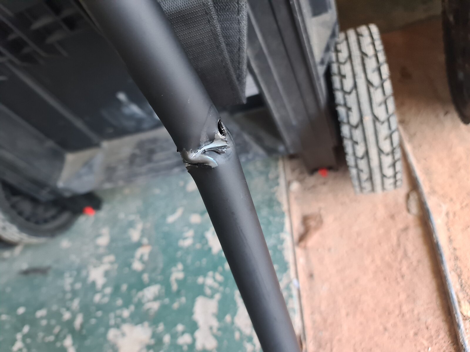

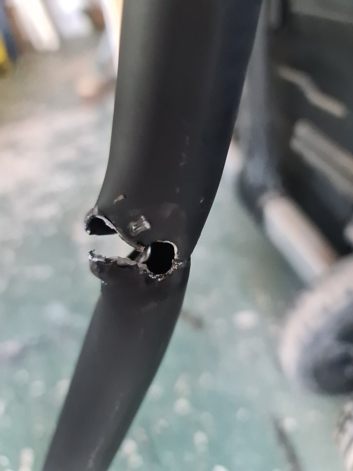

Broken aluminium tube. Can it be fixed
2 Jun 2024
I have a playseat challenge, however one of the legs has bent and broken where they join together. Is there a way to fix this.
I have absolutely no idea what one might be, but to fix that, you would need to cut the two damaged ends off, then find some tube which would fit tightly inside it, as a sort of sleeve, then fix it in place, maybe with Gorilla glue. The other way, would be a tube on the outside, instead.
