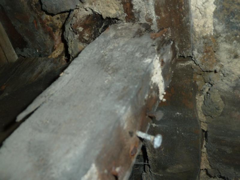

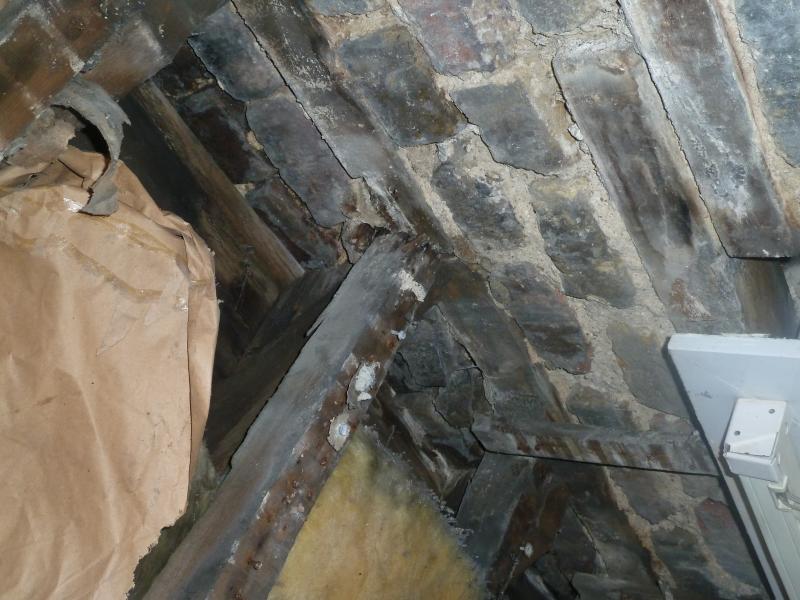

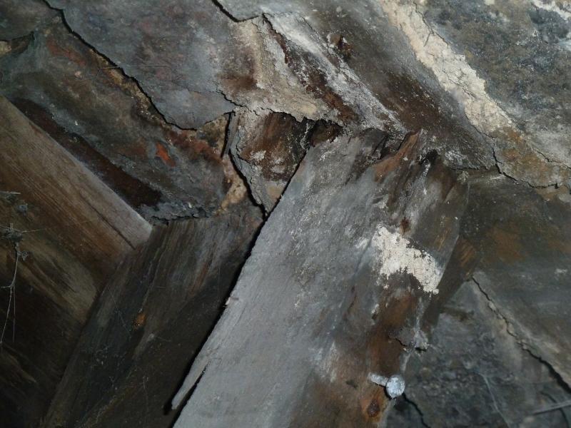

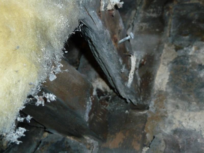

We have a Victorian terrace house. He have been taking down the ceiling in the front room on the top floor, as it was bowing and needed replacing.
We have taken off all the plaster and laths, and have now realised that one of the ceiling joists is broken. It is broken right at the end, where it meets the wall.
When we purchased the property the rendering on the front was blown, so we have penetrating damp. However, this was not near the broken joist. We also have a parapet gutter, and I fear that this is the cause of the problem. The other joists don't look in great shape around the wall area either, but are not broken. I presume this is a damp/wet rot issue, but was looking for some general advice on diagnosing the problem.
I've been speaking to the next door neighbour and he has the same problem.
I was also looking for some general advice on where to go from here. To be honest I don't really know what to do next.
I've created an album with some photos of the broken joist, which you can find here

Yep - well rotted away, those!
I'd be inclined to Acrow prop up the ceiling, and consider replacing the joists, using the existing sockets formed by the bricks.
I presume the damp is historic now?

I would guess that the damp is historic - assuming that the joist ends are dry now of course!
This sort of thing isn't uncommon on old properties - especially if the parapet gutter has been leaking towards the house!
No need to panic here - nothing is going too fall down overnight. I just use the acrows to keep everything stable and safe when the work is ongoing - if you are just doing the one joist then it wouldn't be necessary.
As for costs well you'll just have to get some joiner quotes, and decide if the whole ceiling needs doing......and if there are other issues. A couple of days should easily sort it!
