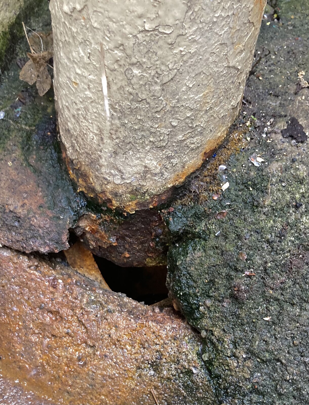

At the base of the soil pipe leading to the drain, there is a hole in the concrete which reveals the main sewer pipe.
What is the best way to repair the hole?
Ideally a dig and replace the clay with plastic using a DC115 onto the cast and AC4000 onto the clay.
Loads of people would stuff a bag in then concrete over.
