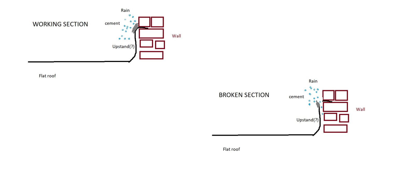

I hope the following makes sense - I have an old felted flat roof that leaked for a while and I achieved a reasonable fix with some bitumen mastic and painting the whole thing with some blackjack roof repair (the 50L tin) it's leaking again and I suspect it's the following in a few places. There isn't any lead flashing, but rather the more cheaply done tuck it into the wall and slap a lot of cement over the top - in some places, the felt has clearly torn - it looks like in one place (perhaps previous same issue) they've put a big wad of bitumen mastic over as a patch and it looks like it's made a good seal - is this the best approach? Probably time for a new roof but hoping this could last another winter...
EDIT - I've misused the term 'upstand' - apologies - it's just the vertical piece of felt that tucks into the wall.
Patching with felt (including mortaring it into the wall) has got to be the best approach and cheaper than re felting the roof.

Fix a lead cover flashing at or above the chase.
