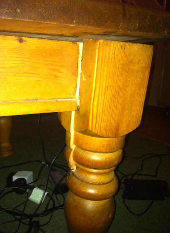

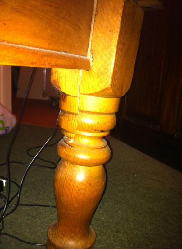

I have broken a table leg, and need a quick / easy fix that I can ideally do in 24 hours.
The leg has been on its way out for a while and has finally snapped , my instict is to use wood glue and clamp / cable tie it together until it is dry but would this be enough?
Here's a photo

The leg is clean snapped in two, so at the minute the table is just resting on the leg, the leg is not attatched
Any advice appreciated, please bare in mind I am a young girl with little / no DIY experience / Tools !

you should be ok
dry fit to make sure it fits well then glue and clamp using card or wood to prevent damaging the wood and that will be strong enough in most instances

Best turn table upside down before gluing as it will relieve any strain on the repair.
If you have no clamp a simple piece of rope wrapped, tied and then a timber twisted thru like a tourniquet will provide a perfect clamp.
poly glue(gorrilla glue) with clamps will make it stronger then the timber itself.
how you cramp it is the critical part. Use PVA white woodworking glue ie a glue thats thin and doesnt bulk when the break is put togther. Also, critical that the vertical alignment of the break is 100% in line. You would need approx 5 or 6 cramps to do this including a couple to keep the flat faces level toward the top of the leg. Use blocks beneath cramps for the flat surfaces and folded up thick cardboard for the the rounded parts. Turn table upside down. Its a 30 min job for a pro.
