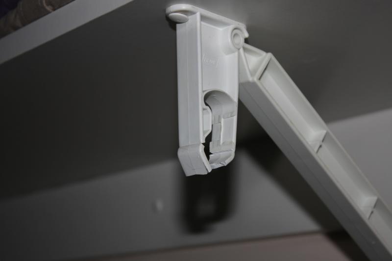

Hi people,
I'm wondering if I can get any advice on my now-broken wardrobe. I guess I put on too much weight on the rail and the ?fitting broke and the rail dropped.
so,
1)What should I do? Where do I buy the replacements.
2)are there any new things I can try out, cuz i find myself running out of space to store my shirts/tshirts.
please chip in some idea. Thanks!
thanks for the suggestions. i have few more questions please.
the shelf in my wardrobe is supported by 2 of this hinges
and of course, there's the little plastic nuts nailed into the sides (as in pictures in first post)
I'm just wondering, if it is safe to remove the 2 hinges for replacement? is it difficult to reinstall the hinges so they support a good weight of the shelf?
I had a better look at http://www.sdslondon.co.uk/207/wardrobe_fittings/
It seems that with wichever end support brackets i choose, I will inevitably need to re-drill a hole on the wall.
The other thing is, if I choose the oval rail, their oval socket and their oval rail don't seem to fit each other snugly... or am I missing something?
wickes!
i think i found my oval socket!! i was actually near a wickes store just now. oh well, until my next grocery shopping...
thanks bilous

I have found the bracket and sockets that match my oval rail, which would mean I will need to change the middle bracket to this:
http://www.wickes.co.uk/Chrome/Oval-Centre-Bracket/invt/160692&temp=largeimage
Now, I think part of the shelf's weight is supported by the original bracket, being nailed to the wall and all. When i tried unscrewing the original bracket, i heard the shelf creak under my clothes' weight.
so, what should i do? go ahead and do it? will the shelf crack?
please advice! thanks
Either unload the shelf first (!) or leave the brackets well alone and attach the new ones just behind/infront or below the originals.
As spooky says leave the existing brackets in place, you can trim the rail carrier part off with a hacksaw if you need to and smooth off any rough edges with some sandpaper.
Add a couple of centre brackets to spread the load.
Probably, but where do you start looking, you will be able to get similar but that would involve drilling into the wall which, I get the impression, you are trying to avoid.
Fit the metal ones from Wickes and just tidy up the plastic brackets is my advice.
