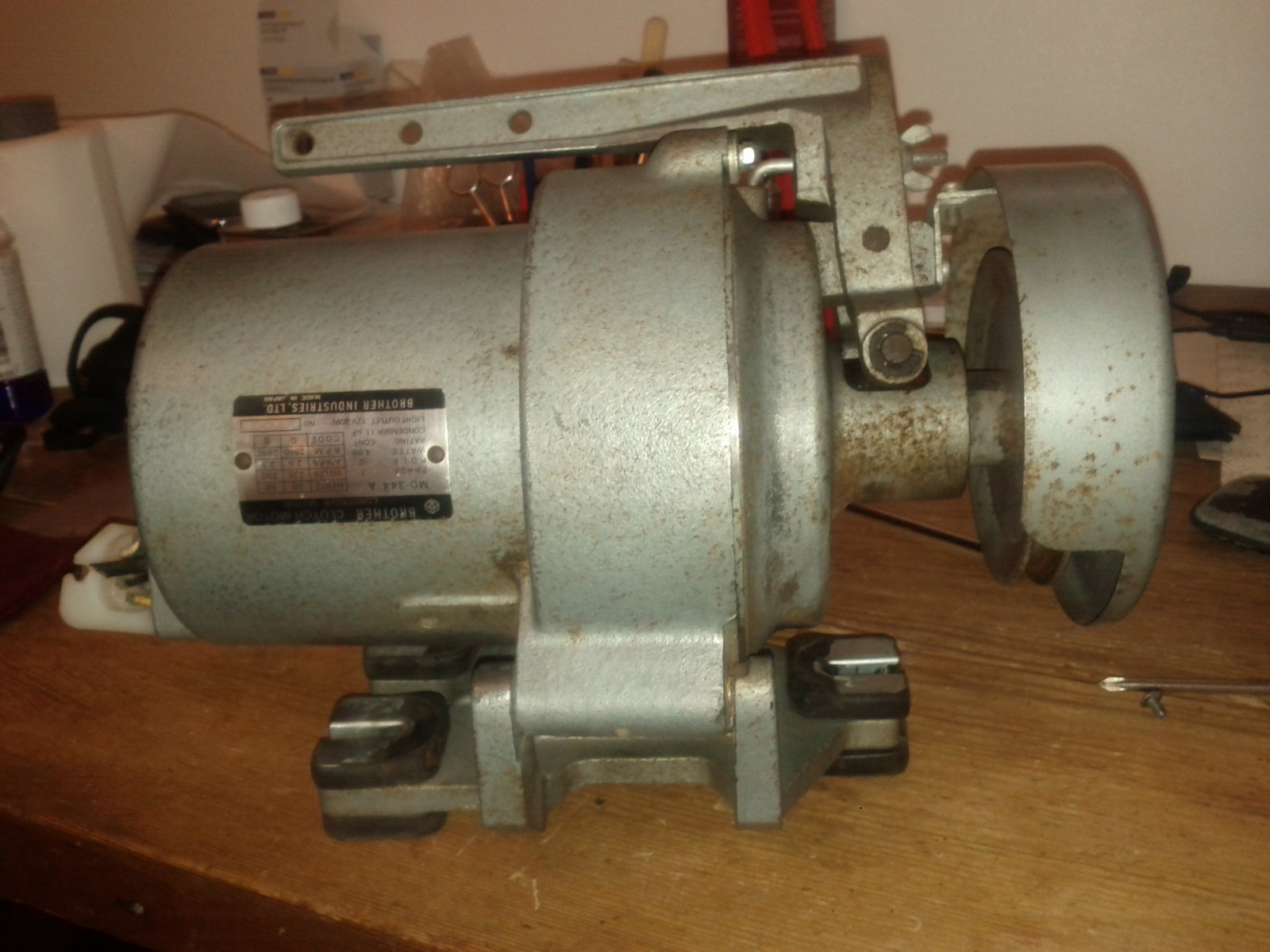

I have a Brother single phase clutch motor with a multi pin connector block on the back.

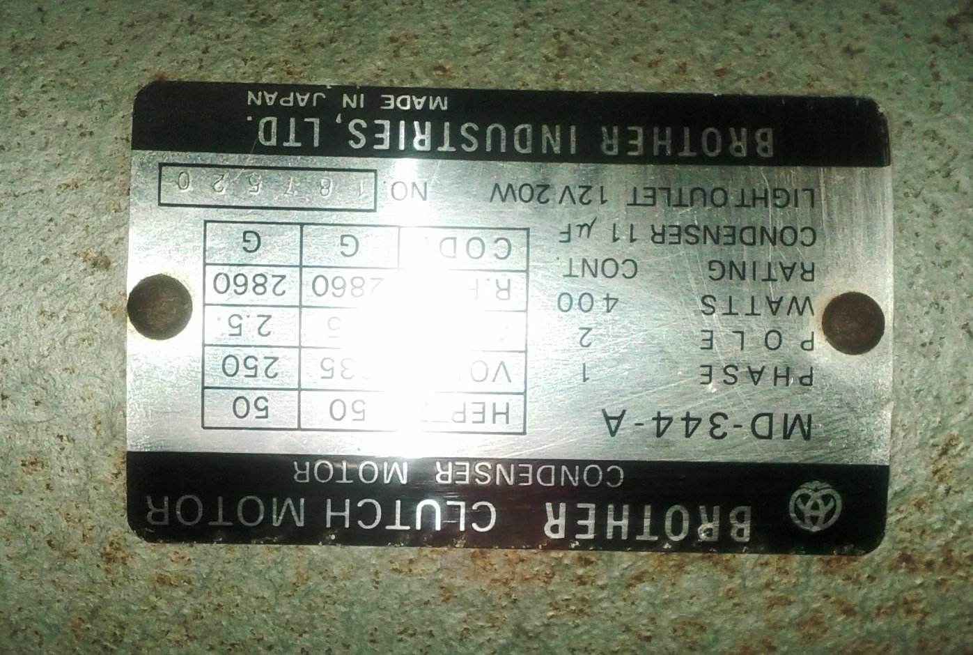

Here is the data plate...

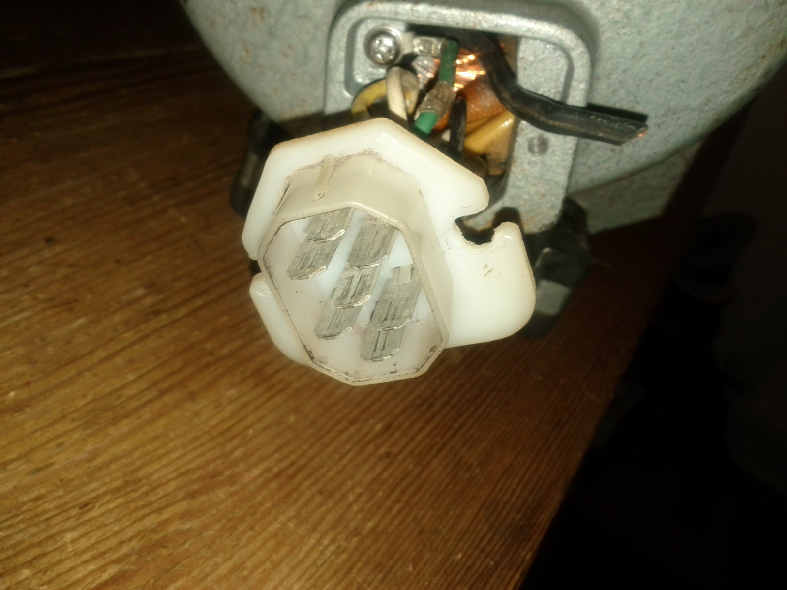

Sorry, I don't know why it's upside down - it's the right way up on my lap top. This is the connector block..
I don't have the female plug so I'm not sure how to connect the motor to the mains. Here is a picture of the wires coming out if the motor to the male connector (you can ignore the black twin core, that's for the work light)...
The red, black & green are, I assume, live, neutral and earth respectively. But what are the yellow and white pairs for? I know some sewing machines were fitted with reversing switches; could that be it? In any event, how I can connect this motor to my domestic supply using a standard 3-pin plug? Can I ignore the yellow and white wires and connect live to live and neutral to neutral?

Most sewing machines have a foot control, which which may be what your other wires are for, so no I do not think you can just connect L.N & E as you suggest, as you would have no speed control.
The foot control for a clutch motor operates the mechanical clutch, not the power supply. The speed of the sewing machine is controlled by feathering the clutch, just like driving a car in bumper to bumper traffic.
Could the yellow and white wires be for a condenser? There isn't one inside the casing as far as I can see.

Why would you need 4 wires for a clutch or start or run capacitor? Could be both I suppose but either way I don't think just connecting 240v to the red & black would work
The female half of the connector is designed to have two cables connected; one serves the mains plug and the other serves the foot control. (The foot control probably has a capacitor within it.)

I've never come across that type of clutch motor, do you have a photo? My understanding is that clutch motors on industrial sewing machines are running constantly whereas the set-up you describe would have the motor switched on and off with the clutch being operated simultaneously. I can see that being quite hard to control.
I didn't get a foot control with the motor, I just have the conventional clutch motor foot control plate with the Pitman rod.
