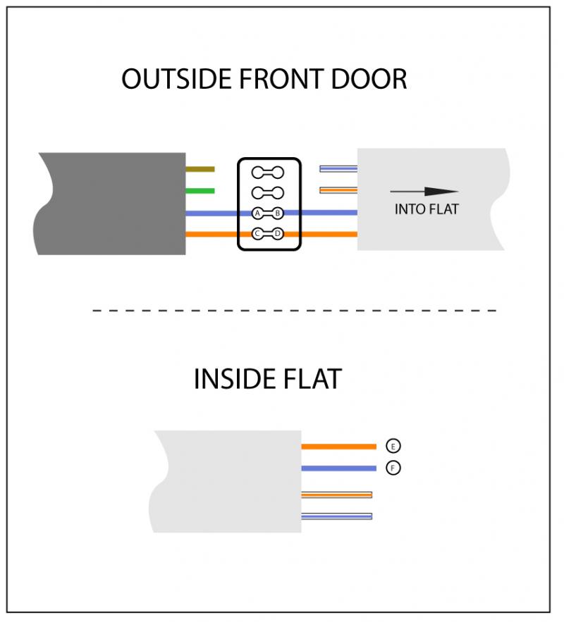

This is the set up - above the flat is a grey wire with four colour wires inside blue, orange, brown and green. There is a junction box outside the front door. Inside this the orange and blue wires are then joined directly (there are no other components in the box just connections and the brown and green don't seem to be used) to a new wire that has another blue and orange wire and also a White/blue and White/orange wires that are curently unused. This line then runs into the flat and I presume that this connectedto the master socket that I now missing.

The blue and orange wires of the four entering the junction box are the only wires connected (the green and brown are folded back out of the way and unused) and coming out of the junction they are also the only wires connected of the wire containing the orange/White and blue/White wires - these have been folded back out of the way.
So from what I can see the only wires in play are the solid blue
and solid orange wires directly connected through a junction box. Do you think I need to connect any other wires? Do I check the voltage across each and see if I get 50v dc?

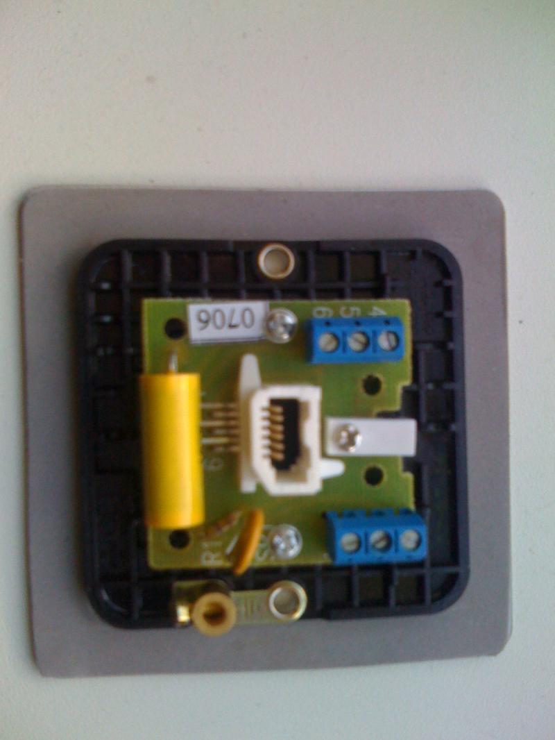

I have included a diagram because I am not at the flat at the moment - but I do have an image of the master socket oddly enough.
I have labeled the points in the diagram with letters (to avoid confusion with the number convention already in use) because I'm going to get hold of a multimeter and test the line voltage tomorrow. Which points should I test the voltage across?
In answer to the other questions - the master socket does have a capictor and it also has screw points rather than the push type tools.

set your multimeter to DC voltage and stick it accross the two wires that come in from outside. Connect the negative side to 2 and the postive side to 5.
there should be a voltage of just under 50V, if there isn't then the line is dead or you have the wrong pair of wires (I would try all combinations in the outside cable if the two that are already wired inside don't work).
