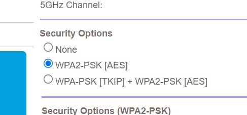

You may find the router is only set to broadcast AC & AX, there should be a setting to enable N also.
-or-
It could be the WiFi security option setting of the router that isn't compatible with the older devices.
Go into the routers settings and change to allow WPA2, or WPA+WPA2 (similar to below)
