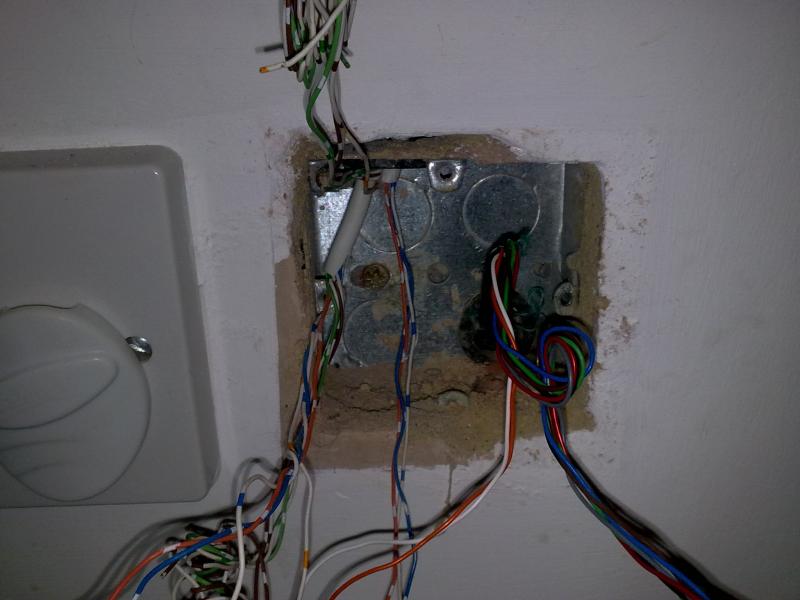

I have a customer who owns two adjacent holiday cottages, each with their own distinct phone number. They have a BT master socket in each. BT provided a single 8 core cable to one of the cottages and ran a seperate cable between the incoming master socket and the master in the other cottage. The incoming master socket is connected to two wires, one orange and one white and six wires are unused. This cottage works just fine.
The second cottage used to work but the owner says that BT, for reasons unknown, disconnected it while installing ADSL in the first cottage. Now the cable running from the incoming master socket to the second cottage's master socket is not connected to anything at all. The owner has had BT out to have a look to see what's wrong. BT said all their cabling was fine, charged £120, and left the customer in exactly the same position as before. Customer not happy.
I've tested voltages across all combinations of the incoming wires and only the orange and white have a voltage (49v DC). All the others appear to be dead. I've also tested voltage across the orange and white when the incoming cottage number is called, it remains at 49vdc and the telephone rings normally. When the second cottage number is dialled the orange and white start fluctuating from 49vdc to a whole range of voltages, both DC and AC.
So from this I deduce, perhaps incorrectly, that both telephone numbers are served by the single pair of orange and white. Is this correct? If it is correct, where and which colours should I attach to this incoming master socket to spur off to the second master socket?
This is a picture of the incoming master socket. The bottom right cable is the incoming BT cable. You can see the orange and white wires running to the faceplate. The blue/white, white/blue, and orange/white wires runing up to the right-hand cable at the top of the box are to an extension in this cottage. The left hand cable is the run to the second cottage's master socket. None of these are connected to anything in this box.
This is a picture of the faceplate of the incoming master socket.
Any help would be most welcome.
If there is nothing at the master NTE socket, it is a BT problem and down to them to sort - I would chase for a refund and revisit.
The black cable coming up the wall is likely to have all three lines in it (assuming you are correct that all 3 buildings had a seperate number, and the master sockets in those buildings all come back to this socket int he photo). One pair will carry one line. The orange/white is carrying the line in the photo. The other pairs may be carrying the other lines, and would usually be jointed with jellies behind the socket onto the cables to the other buildings.

So pair 1 in the incoming cable must be the line for cottage #1 which has had ADSL provided on it then. The only problem there is your description of the voltages measured:
Measuring across the line when an incoming call arrives, you should normally see first a polarity reversal of the DC, then the AC ringing voltage superimposed on that (when the call is either answered or abandoned, the DC polarity will return to normal). If you're using a digital meter it won't be able to keep up with the ringing bursts, hence the fluctuating readings.
But you say you just read steady battery on the line when calling cottage #1's number and (presumably) ringing voltage when dialing cottage #2's number, which is puzzling. Is there a possibility that you accidentally had the two numbers mixed up when you did that test?
If there is/was a second line and that external drop wire is the only cable to the building, then the second number should be on one of the pairs in that cable, most likely pair 2. For reference:
Pair 1 = Orange / White
Pair 2 = Red / Slate
Pair 3 = Blue / Brown
Pair 4 = Green / Black
I thought I'd checked every combination of the other wires and got no voltage. Now you've given the the specific pairings I can recheck with more knowledge.

I see that as a possibility, but then I would have to wonder why the second pair was disconnected behind the NTE in the first cottage. :confused:
If the second cottage had a working line before the change, then one of the pairs in the drop wire must have been connected through to that second NTE. I'm just wondering if the engineer had somehow gotten a mixed up order and thought that the line to the second cottage was to be discontinued?
