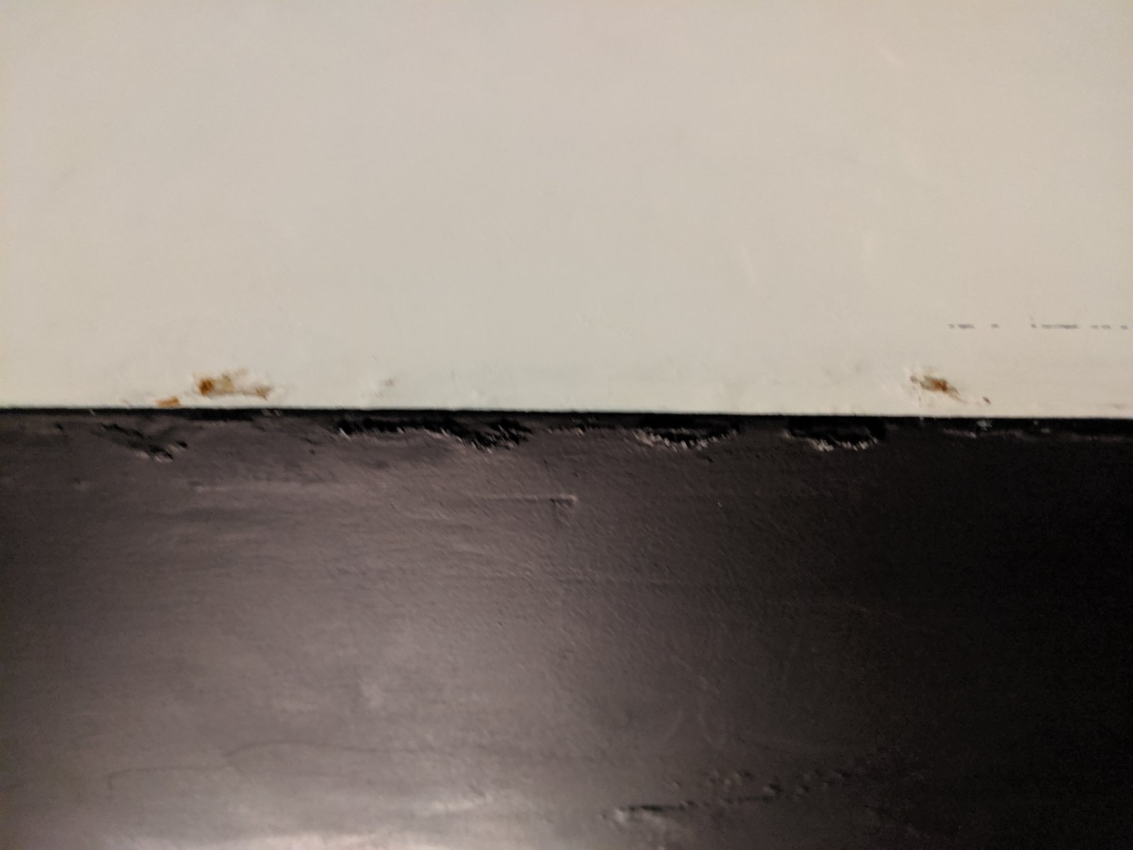

Attached a pic. There was a previous leak from a leaking flat roof. Which has been sorted.
Had a plasterer come around who suggested just but a new bead o we it and skim over and the adjoining ceiling, any thoughts?
My thought is do I cut the existing bead out, replace with a plastic bead and try to skim it myself?
Or cut it out attach new bead and let plasterer re-skim
Or let plasterer out new bead over it and re-skim, (will the rust come through new bead and skim?)
Any thoughts?

a pic with more context would have been more helpful - you only show a small detail?
1. you've got to be dead certain that the roof is sound otherwise your wasting your time?
2. previous repairs have been daubed on the p/board skimming
skim bead, not so called angle bead, is typically used on p/board.
3. if you only want to deal with the angle bead ie limit your repairs - then run a knife along the edges (the fins) of the bead to free it from skim and paint.

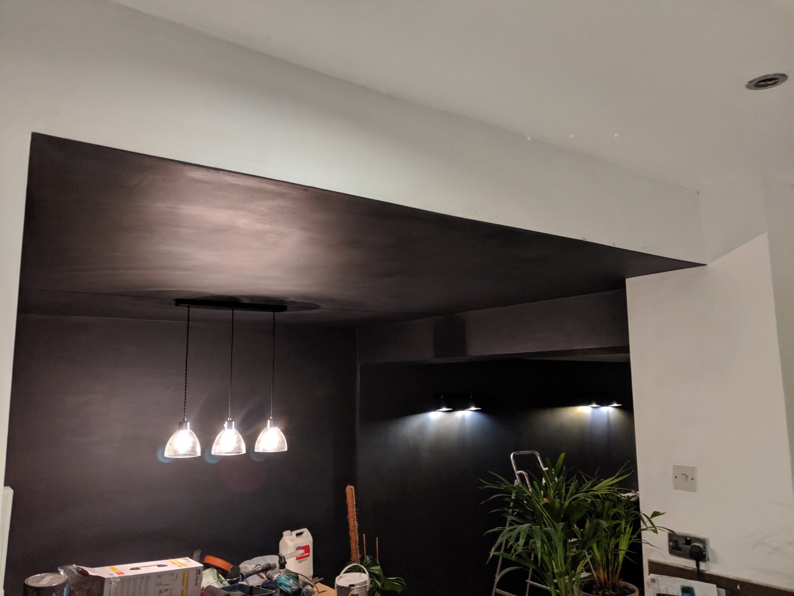

Yes sorry have attached wider view, the beam is solid concrete no plasterboard on the white side you can see, just the dark ceilin. Roof is 100 sound - was replaced last year following the previous roof leak hence the water damage repairs and be taking off the blown plaster.
well it now changes the situation: i'm assuming that the dropped lintel carries back across a dropped ceiling (in black)
the white ceiling is the original house high ceiling.
then its a case of do you want to do a whole black p/board ceiling replacement now or a patch repair?
another question is: is it actually an "angle bead" or a stop bead?
a stop bead would stop at the outside corner of the lintel.

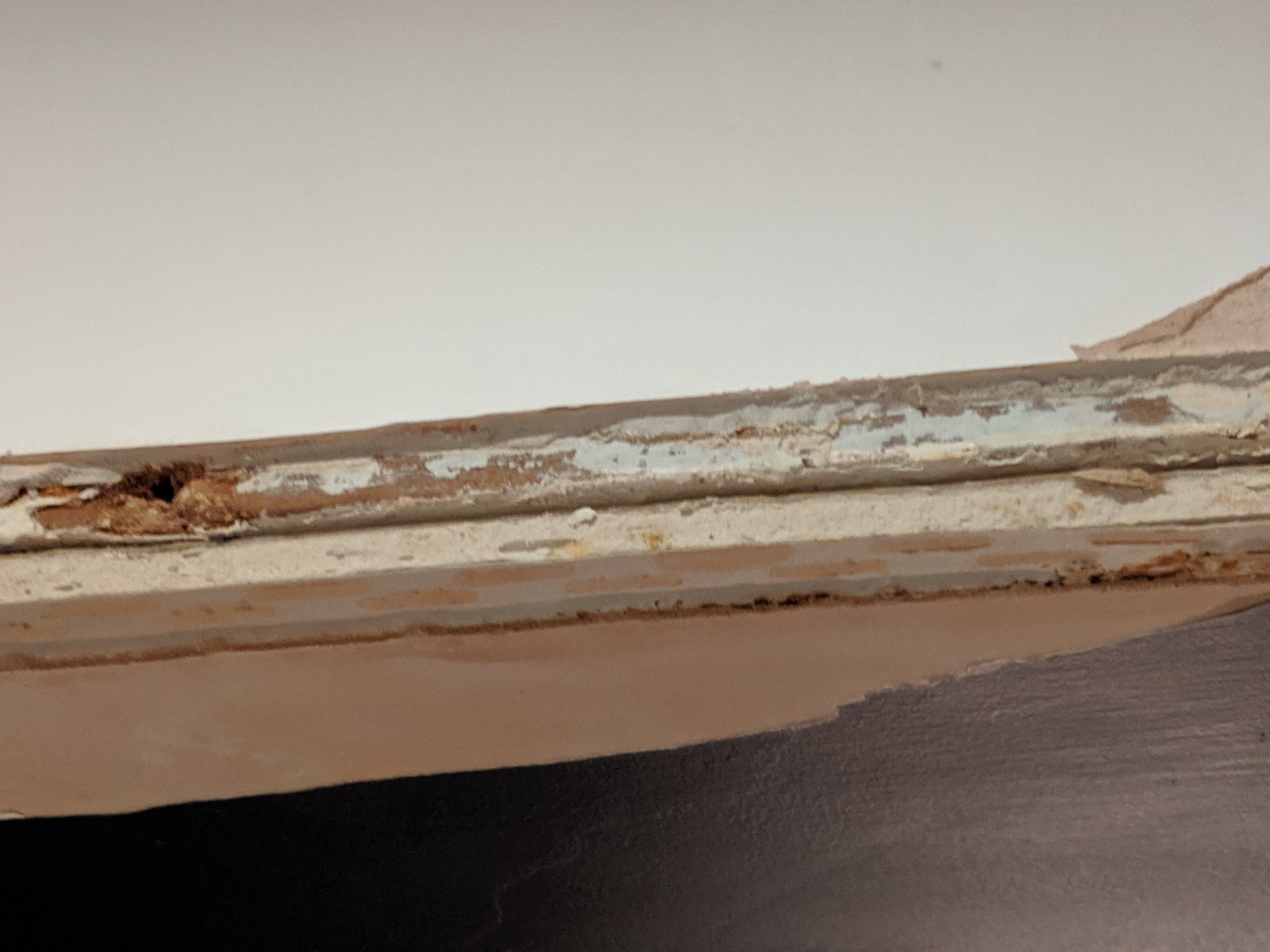

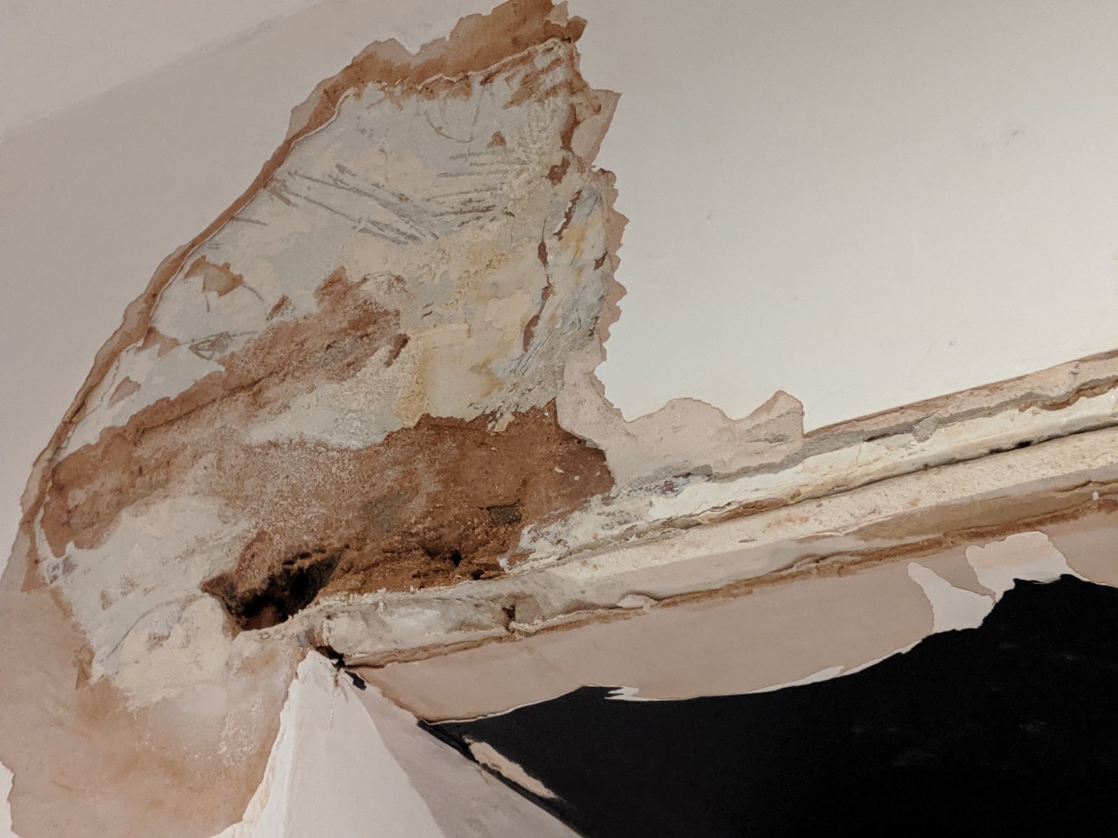

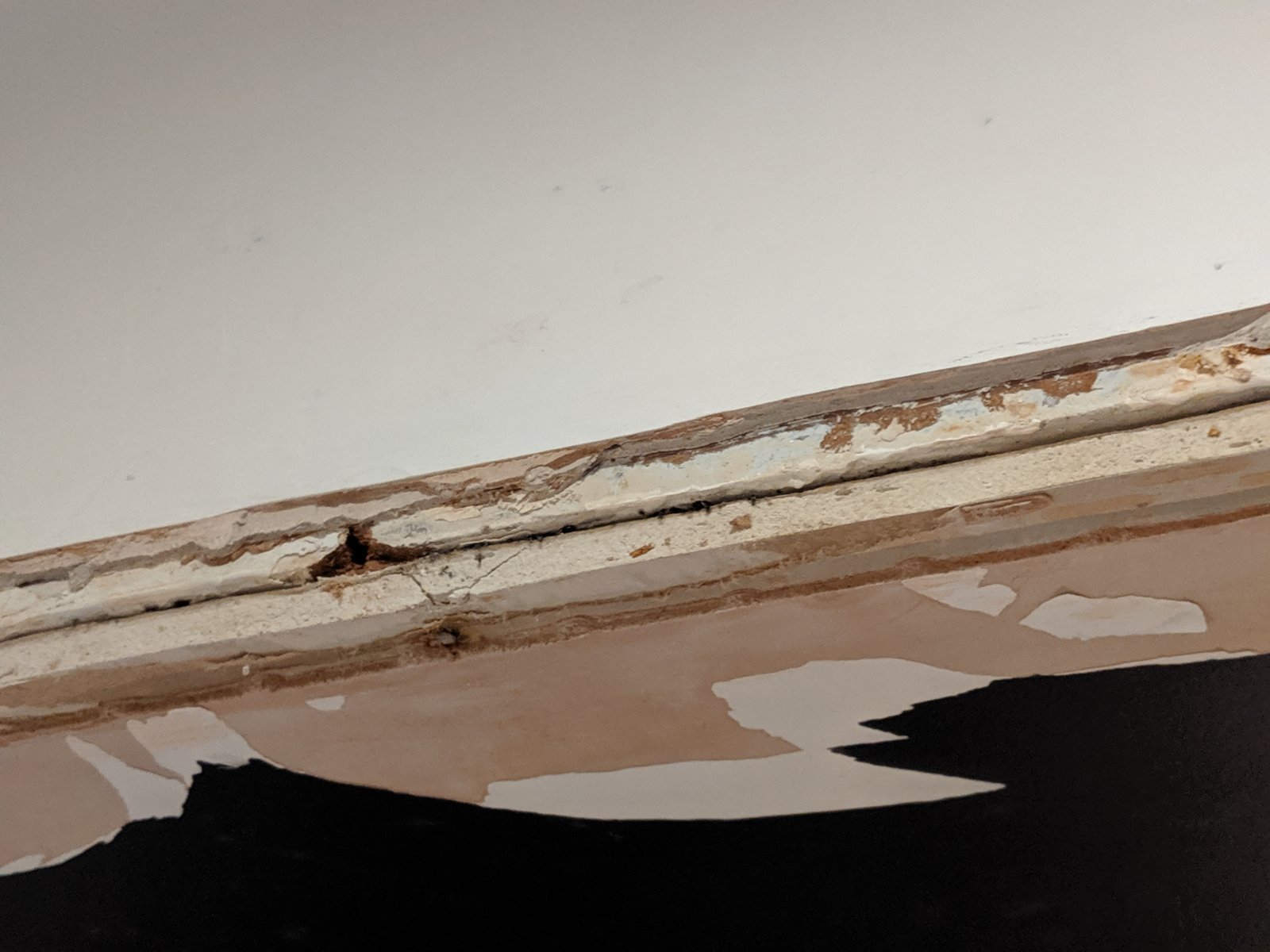

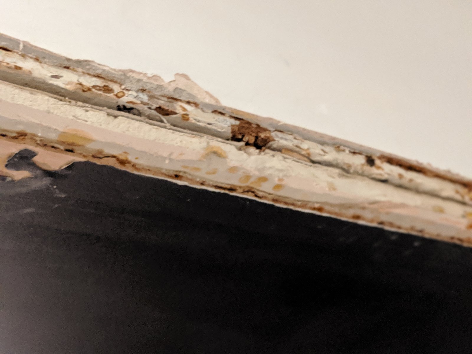

So bit of an update as we are all locked up because of COVID19, the other half was out so I decided to take a look to see if the bead was rusting.
I've cut it out and indeed it was, it looks a right mess now bit I know it usually looks worse before it's better.
So I've uploaded some pics, the plasterboard undneath seems good and dry, there seems to be a dark patch which looks damp but feels dry.
So my next this is what to do next, would you get someone in to check for any leaks, I think the previous owners had a leak here from the bathroom above and wondering if this had caused the rusty bead in the first place.
any advice would be appreciated as ever. Also thinking should a put a few nails in the edge of the board is not really flush now I've removed the bead.
The big missing plaster was old blown plaster I removed
thanks for the new pics and info.
what i dont get is is this a lintel over a wall breakthrough or a lintel over a window recess in your kitchen?
the damage now shown probably indicates that you will have to cut back all signs of water damaged plaster board and solid plaster - dont leave any damaged stuff, be ruthless, & cut back well beyond any obvious signs.
i'm assuming that the flat roof comes up to the lintel(?) and the bathroom is directly above?
go in the b/room and search for leaks
and take and post pics of he flat roof if you would?
