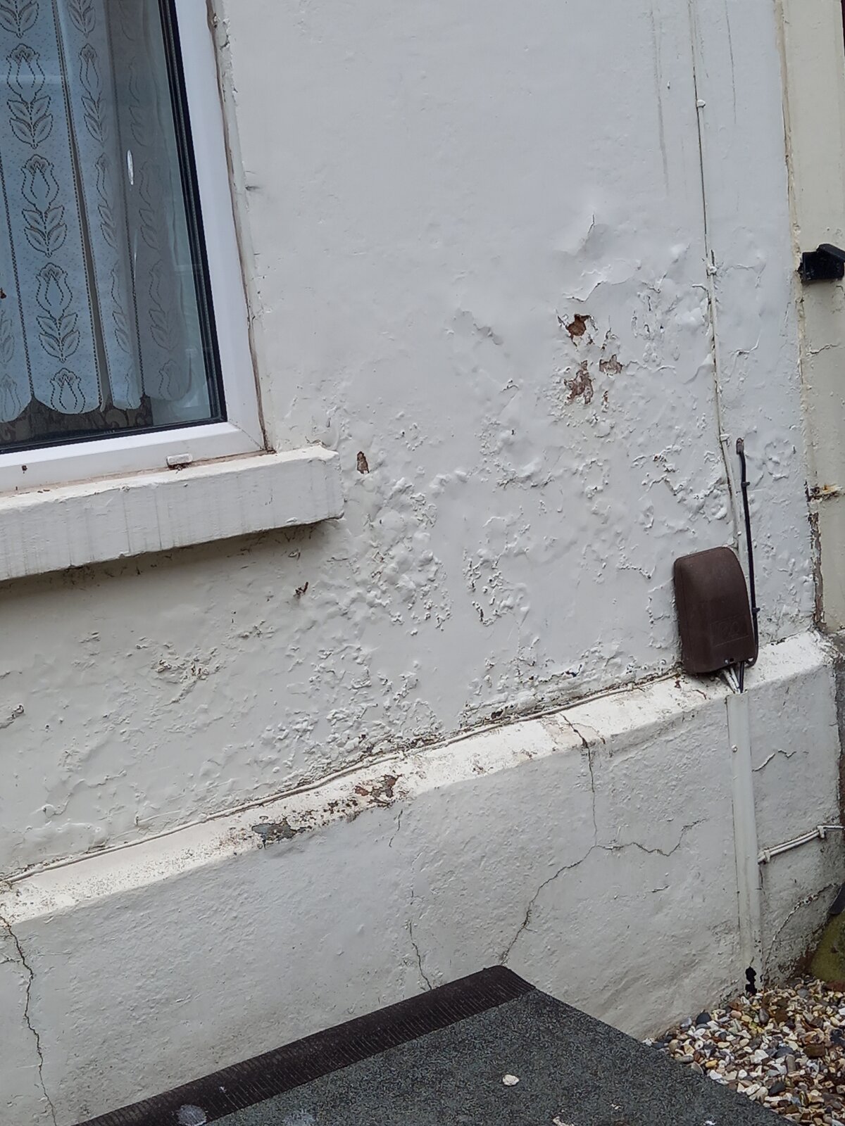

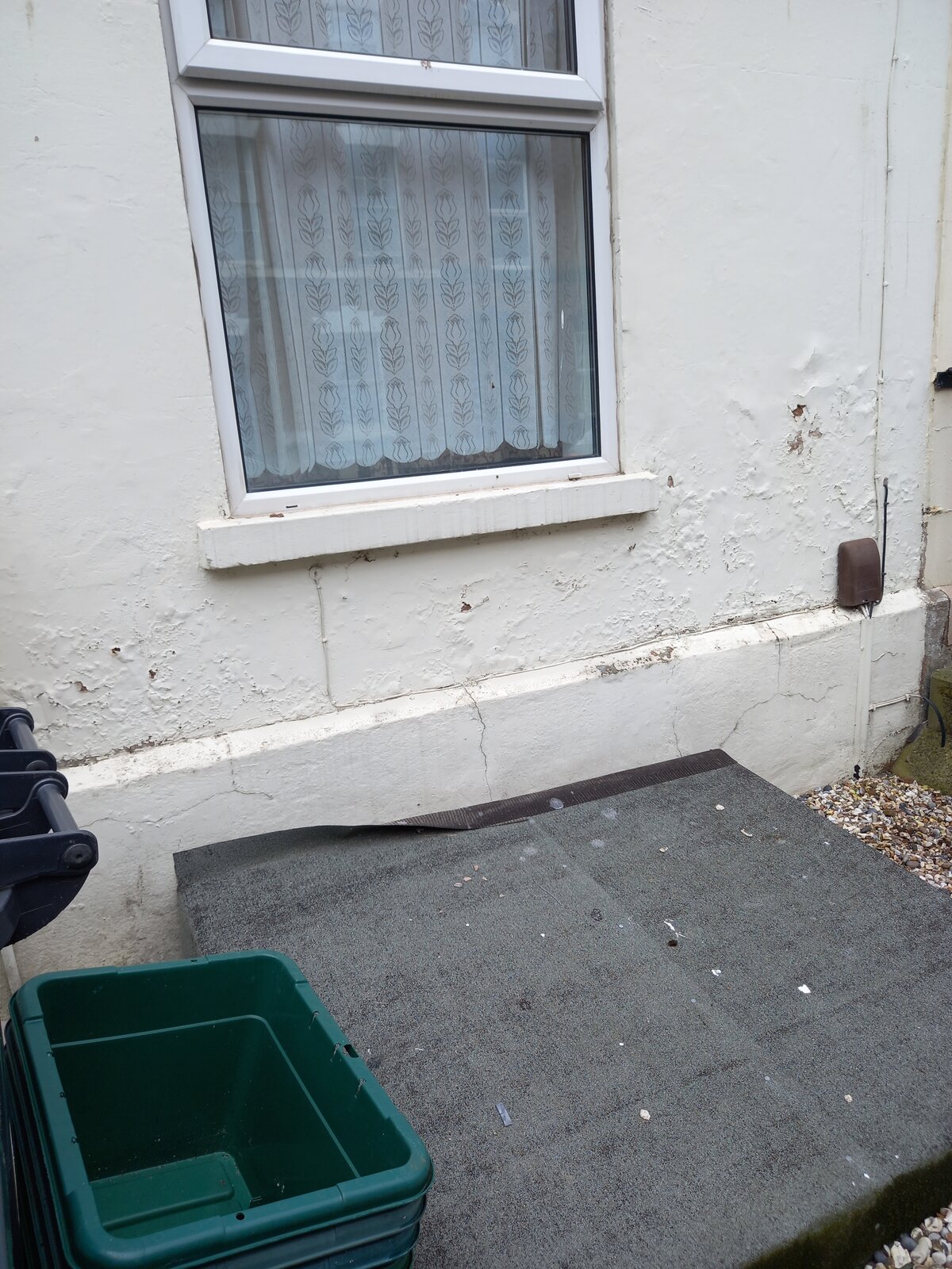

I had the outside of my house painted a number of years ago. It is an 1850s property. All the other houses in the street are also painted. However, very soon after, the paint started bubbling. It has gotten worse over the years and now looks a right mess tbh (see pics).
I'm assuming, it was the wrong type of paint used perhaps? If I remember rightly though, it was some sort of weathershield. Perhaps it should be a 'breathable' paint?

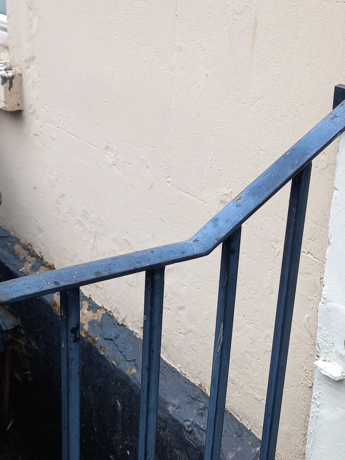

It's odd because none of the other house in the street look as bad as mine. The pic with the railings shown is directly next door to mine.
Any thoughts or ideas?

Damp pushing off paint by looks of it. Consider getting it looked at and taking advice.
Can be anything from wrong paint or rising damp.
Could be a bridged damp course or drain problem. Take advice if you can't find the reason.

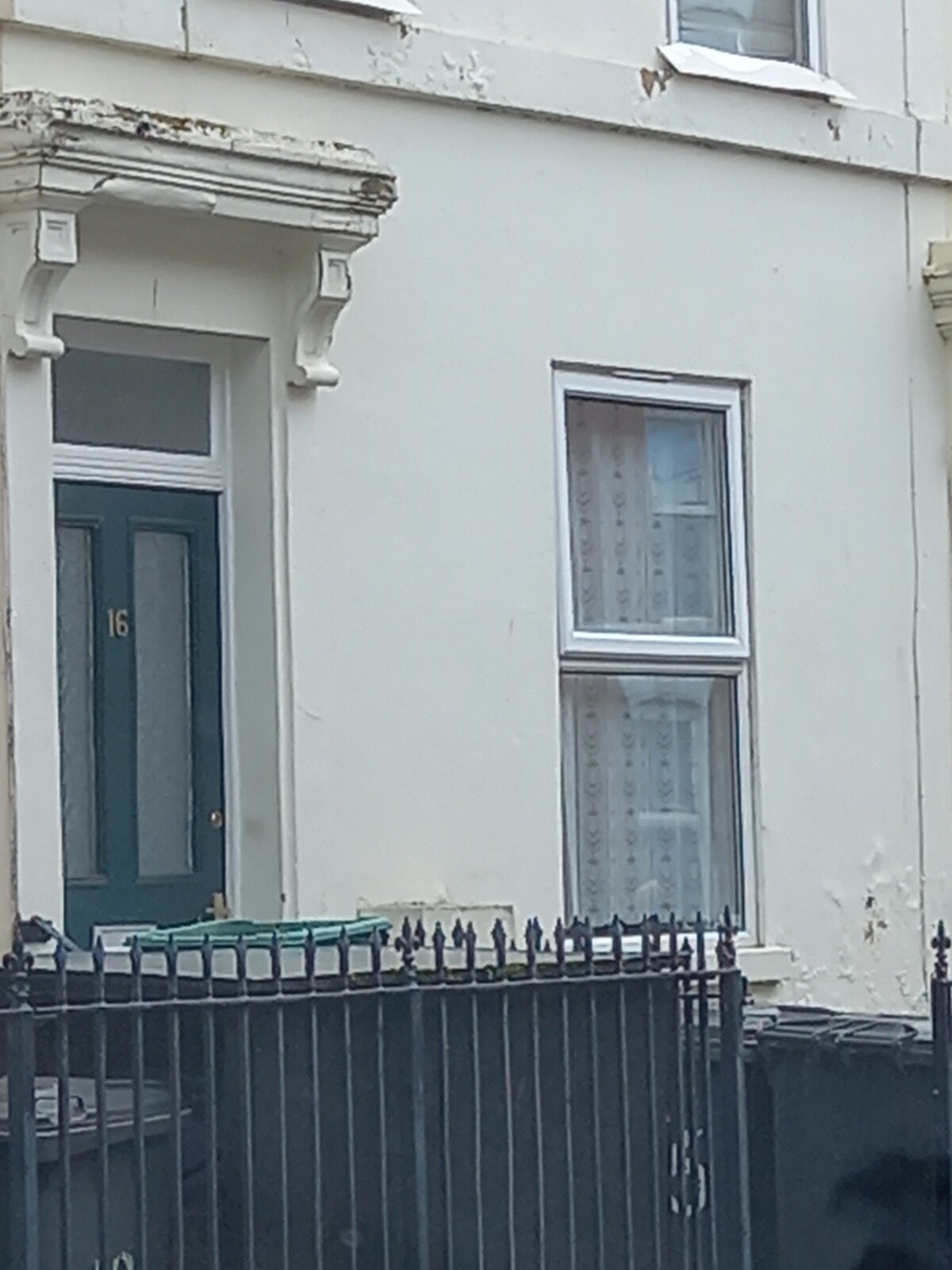

I'm thinking a paint issue, or perhaps a lack-of-prep paint issue because, whilst there are large areas not affected, other bits, around the cornice above the door and, the plinth below the first floor windows, for example, are. (see pic attached)

Re walls. Do you have lime render? What damp course do you have? Same as neighbours?
Best primer is coverstain but you don't want to be putting that over lime render as there are recommend primers specific to that surface

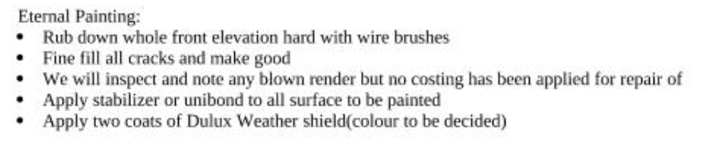

I've found the original quote for the works. It appears that a stabiliser / Unibond was used plus, 2x coats Dulux Weathershield.
This was September 2013. Admittedly it's been a few years now and so perhaps, it's current condition is to be as expected?

September should have been warm enough.
Could the wall have been wet? Not usually a major issue with water-based paints, but still worth asking.
The fact that stabiliser WAS used may indicate the wall was in a bad, porous condition to start with - so maybe not too surprising.
