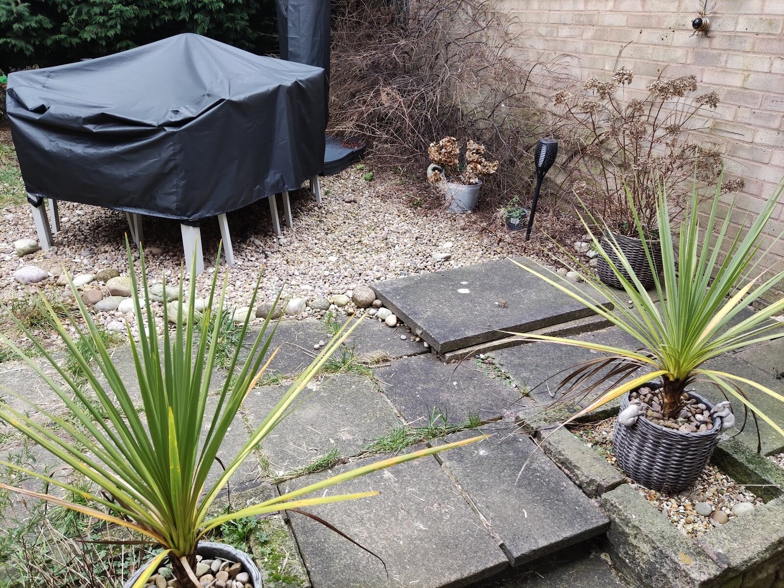

In previous photos there is a lawn growing where the gravel has been laid - that is starting to grow back through now:

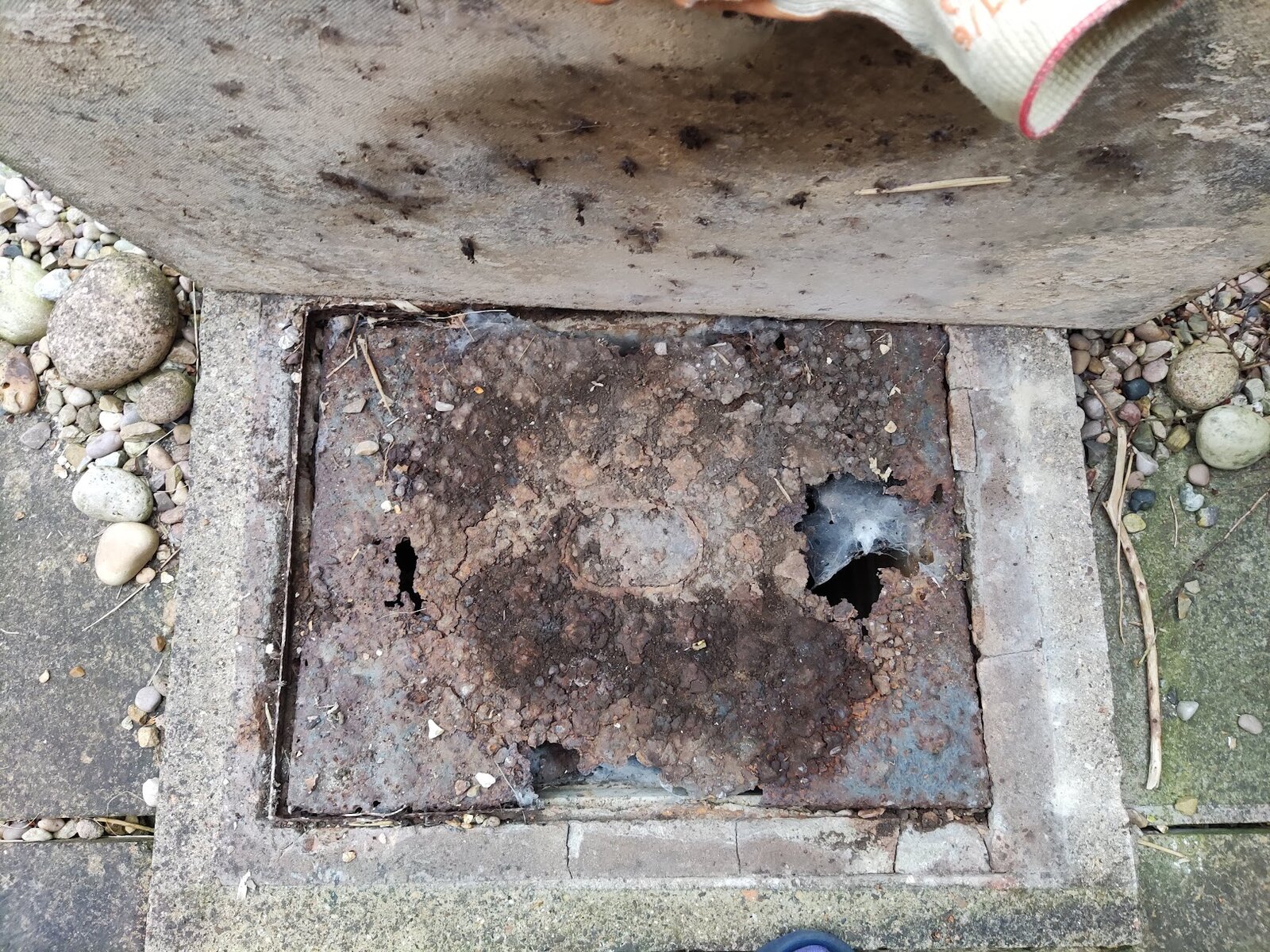

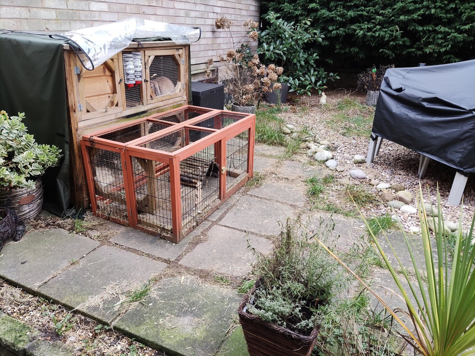

There is a slabbed patio area, approx 8m2. The slabs are in poor condition, the grout has totally gone and most of the slabs are loose underfoot. There is a very large slab covering a manhole cover which is totally rotten underneath. As the condition was poor I put a rabbit hutch on top with no cover to the surface underneath - I will definitely not to do this once its sorted and try and keep the place tidier.

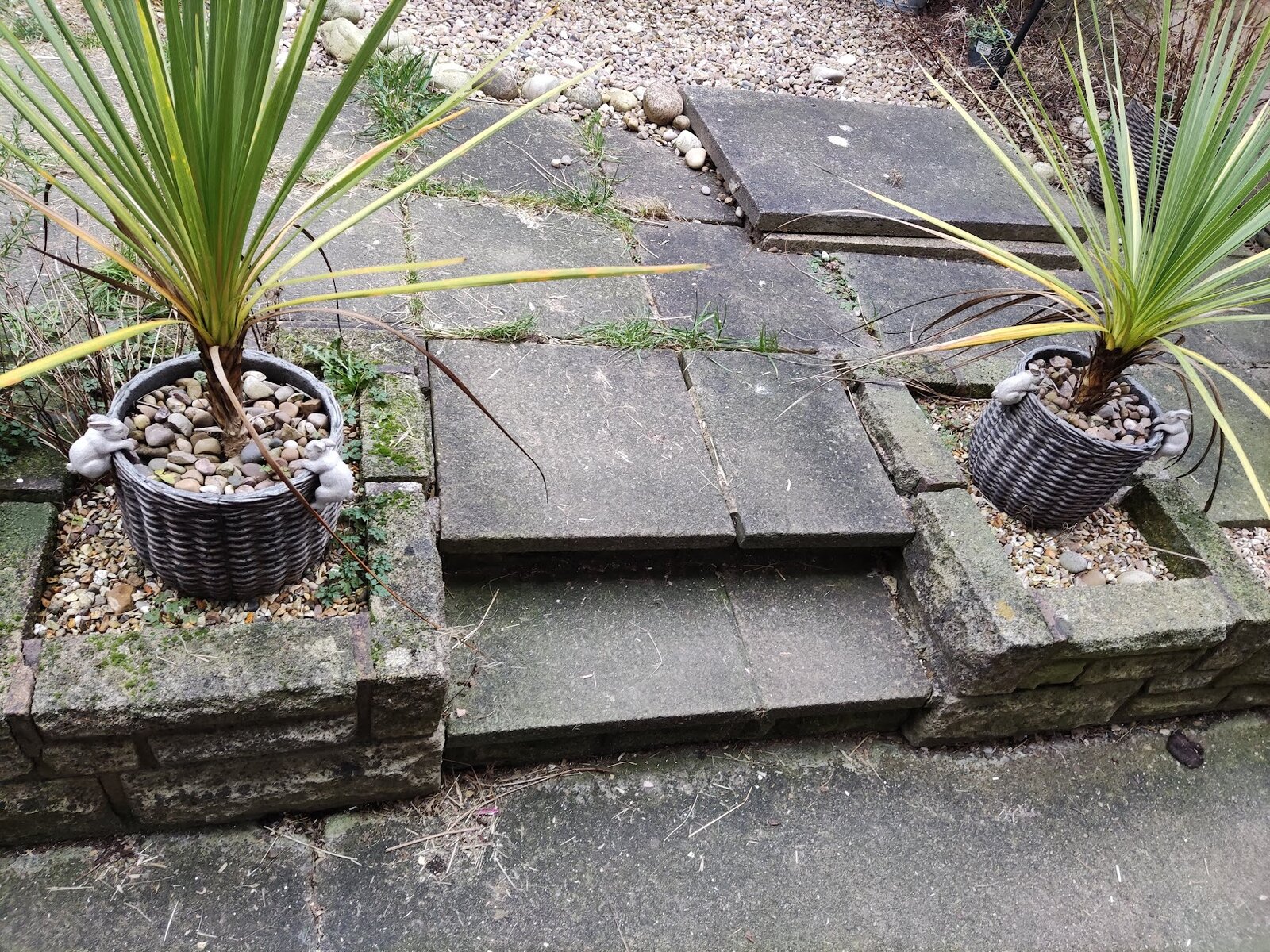

There is a "stepped" area (I intend to replace the steps with new slabs) but I will leave the concrete floor and wall and just try to clean it a bit with a jetwash etc

My plan initially is to just replace the slabs like-for-like with another set of 450mm slabs. I did initially want to change the patio area to allow for the table and chairs but to be honest i'm just looking to keep the costs down now.
If I wanted to just replace the patio with some fresh slabs, is there more to that than just lifting the old ones, replacing and grouting?
What would you do with the manhole cover?
Should I get rid of all the gravel - would the lawn grow back?

As you are planning on selling, and new owners will have their own ideas for the garden....
Replace the manhole cover - prospective buyers will be put off that, and refects badly on other items - and it is dangerous.
(Chisel out surroundings, place new cover on bed of mortar (or concrete) and put new concrete arround surrounding, smoth flat).

Keep the paving stones (why by new ones)
Wash paving stones with pressure washer and/or paving cleaner (careful it is acid).
https://www.screwfix.com/c/auto-cleaning/patio-cleaner/cat8820001
Clean out gaps between paving stones and Regrout between them with sharp sand and cement. (5:1).
Kill the other weeds with week killer (and keep using until you sell)
Rake the gravel (worst case, pile up the gravel, hose it down, and put it back down ontop of some weed membrane).
Remove all the dead plants.

You could buy a bit more gravel and add it so long as it looks ok.
Nothing to stop you placing potted plants around and taking them with you - so long as they aren't in the ground
Thanks for the reply both. Definitely made me rethink about the fact that the next owner will probably have their own ideas - if we were staying we would definitely move the patio as the current position is poor, its in the shade, would rather be in the sun personally (where the table is at the moment), and probably the next owner might think the same too
I have ordered the karcher patio cleaner attachment and cleaning fluid and will try it out and see how I get on - if the slabs look acceptable (I reckon they will after looking at a few pictures online of how bad they can be and still be cleaned!) then I will fix the loose stones and re-grout. The pressure washer will have no issues cleaning between the tiles (honestly it's mostly soil and general grot in between them now anyway...)
Will also get a new manhole cover as there's no way around that and it needs sorting ASAP.
