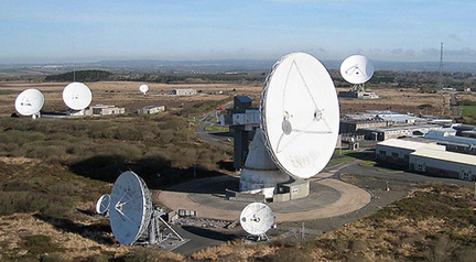

Hello, I have purchased an antenna that needs to point in a certain direction and I need to be able to change the direction throughout the day with the help of an electric motor.
What would be the most effective way to move a heavy object's direction using one motor? How should I arrange to motor to get the most from it?

Just something around this size. Nothing too large. (Not my photo)
If I build a base it could stand on how could I use the electric motor to rotate it?
You will almost certainly need to rotate and elevate the antenna which requires a two axis motion control system.
If you are tracking a moving source or switching between several fixed sources ( such as geo stationary satellites ) then this will be complex and expensive.
If you are switching between two or three geo stationary satellites then using two or three separate antennia may be less expensive.
Not at all. Mount the dish on a polar mount. Then only a single motor is required. Google is your friend.

How fast? How accurately do you need to position the dish?
You will probably end up with a gearbox the size of your house to get near the speed reduction I imagine you will need.
In an industrial setting, a servo motor would be the preferred option for positioning, but it would be expensive and requires a lot of design knowledge and manufacturing to diy it. If there's a purpose made bit of kit on the market that will be your best solution.
I used a windscreen wiper motor through a second windscreen wiper motor gearbox, 360 degrees took 2.8 minutes. However I was in the Falklands at the time, so there was no local shops I could buy one from. In the UK I used a propriety rotator which was a lot faster, however the controller used a motor to move the pointer which should run as same speed as aerial, but they were not quite every so often one had to rotate it the whole way to get both in sync again. This was OK with a HB9CV but with a satellite dish it needs to be more accurate.
