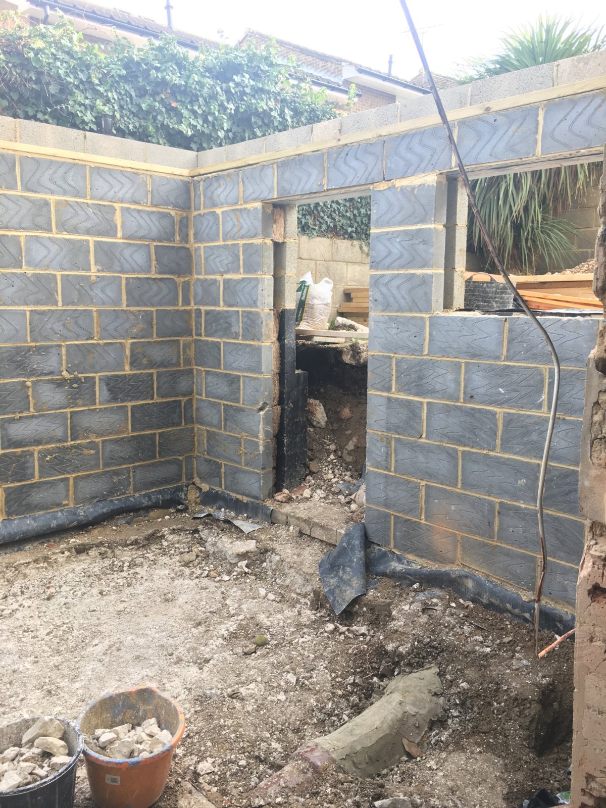

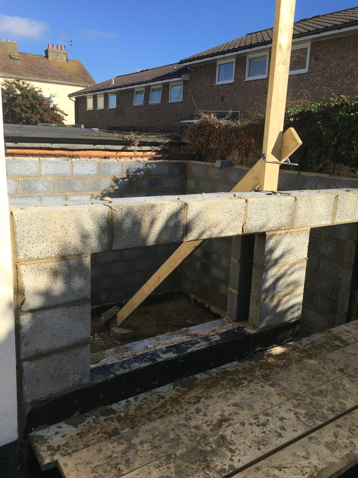

From the photo there is some kind of bridge as you can see the block immediately above the drain has been cut and the DPC steps up. Dig out that bit of soil and have a look.
The drain is quite shallow so it should be reasonably straightforward to have bridged the drain with concrete lintels. Mind you I don't think I'd be happy leaving that old salt glazed pipe under my floor. I'd be inclined to replace it with plastic for peace of mind.

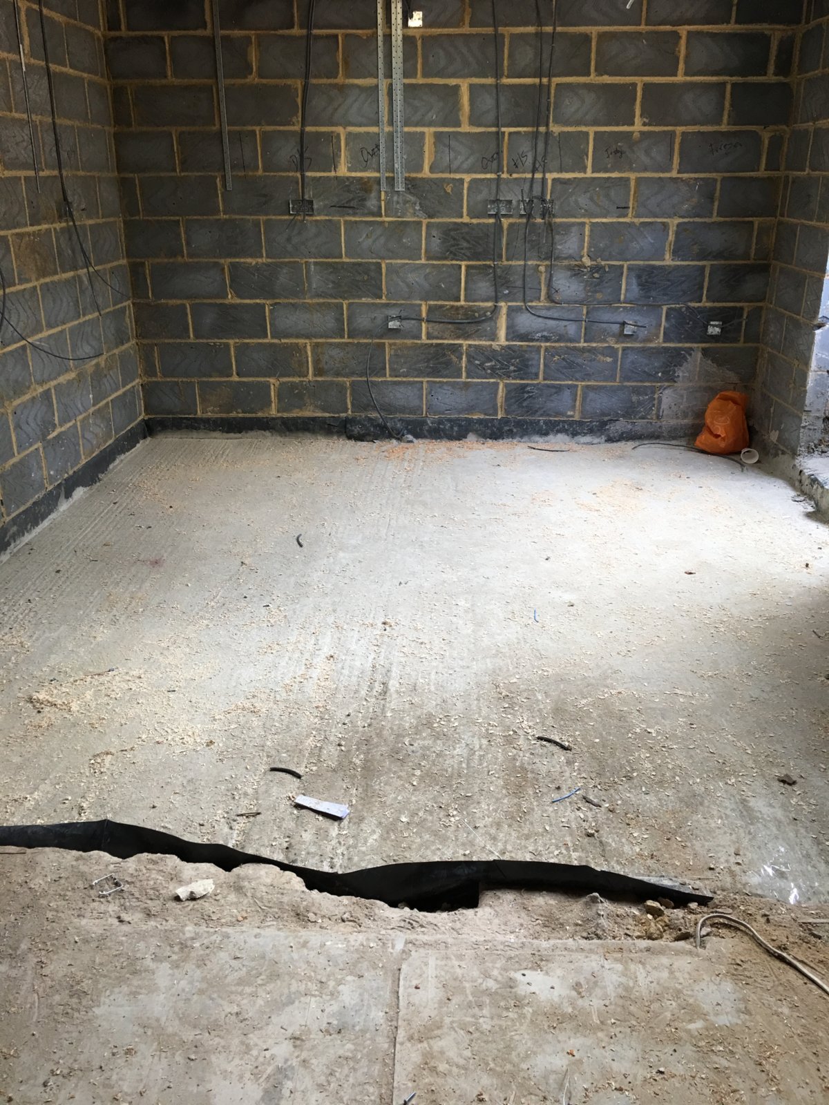

I can’t dig that part out now as that was an old photo. By the time I knew the mess I am in, the builder had already poured the concrete.

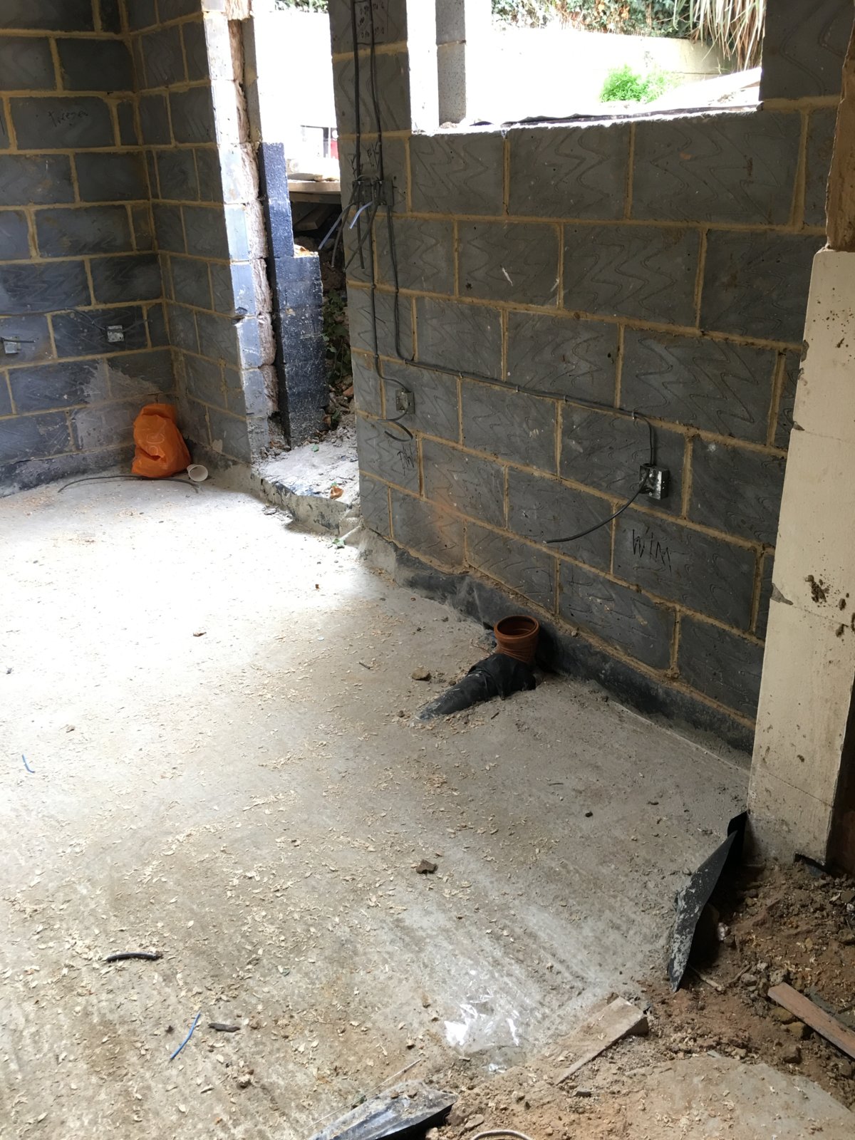

This is how it looks now and it is only at this stage that I pulled the plug and stopped all work.

That must be a very thin slab, you can still clearly see the bottom of the cut block and the step in the DPC. Also where is that new drain going? From the previous picture it looked like there was a manhole under those buckets but there's no sign of it in the later photos.

Yes there is a manhole where the buckets are and a manhole in the neighbour’s garden. Their manhole is in a location that is accessible and not under their outbuilding.

The concrete slab is 120mm and it covers over the original manhole. He still needs to pour celotex and screed over the cement.
The builder’s plan is to dig a new manhole in the side garden.
The pipe is for the kitchen sink and joins into the old man hole.

The wiring is wrong. If the builder is self certifying that then I would be additionally concerned.
