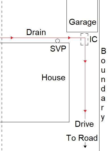

You are better off posting a plan with the pipes, the users and the buildings on to get opinion on the best way to deal with the layout.
Inspection chambers cannot normally be inside, but may not always be necessary.
Hi Woody
Is this sketch good enough?
Regards
Dave

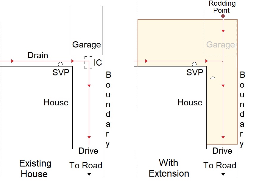

You may be able to convince the water company to do away with the manhole and have a rodding/access point at the other end of the garage (vertically to that run on the drawing), or if the garage is going, somewhere outside the new extension.
Part of this convincing may involve renewing all the pipes beneath the new extension.
Now that's a good idea - hadn't though of that.
Like this (don't know what the correct symbol is for a rodding point).
New extension is to partially cover the footprint of the existing garage.
