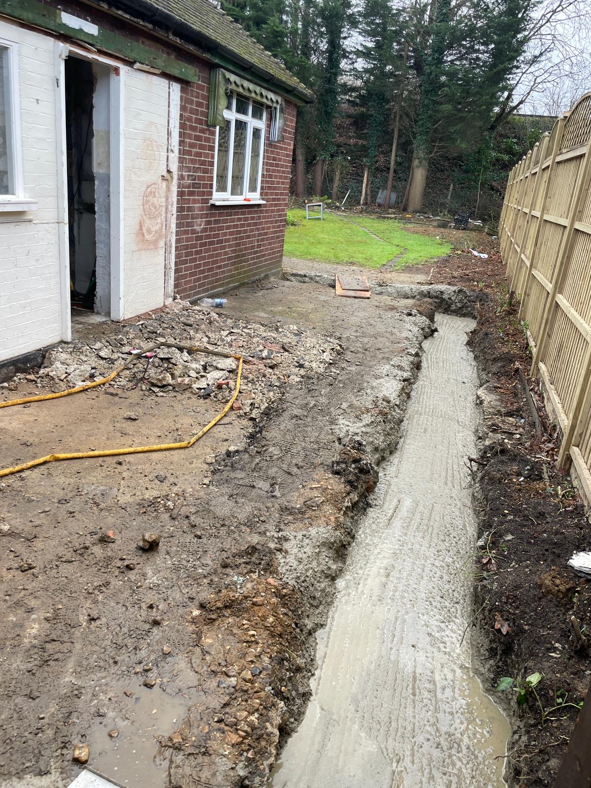

Thames water was contacted by BC to inform them of Works. I'm doing a side extension.
Thames water said I need a build over agreement.
My builder said I don't need to worry about it as they are removing the manhole and redirecting it. Is he correct in saying this?

It's private sewer with no connection to next door, the public sewer is 10m away.
Build over or near agreement is a better description
If there’s a public sewer the other side of the fence in a neighbours garden it’s possible a build over agreement is needed.

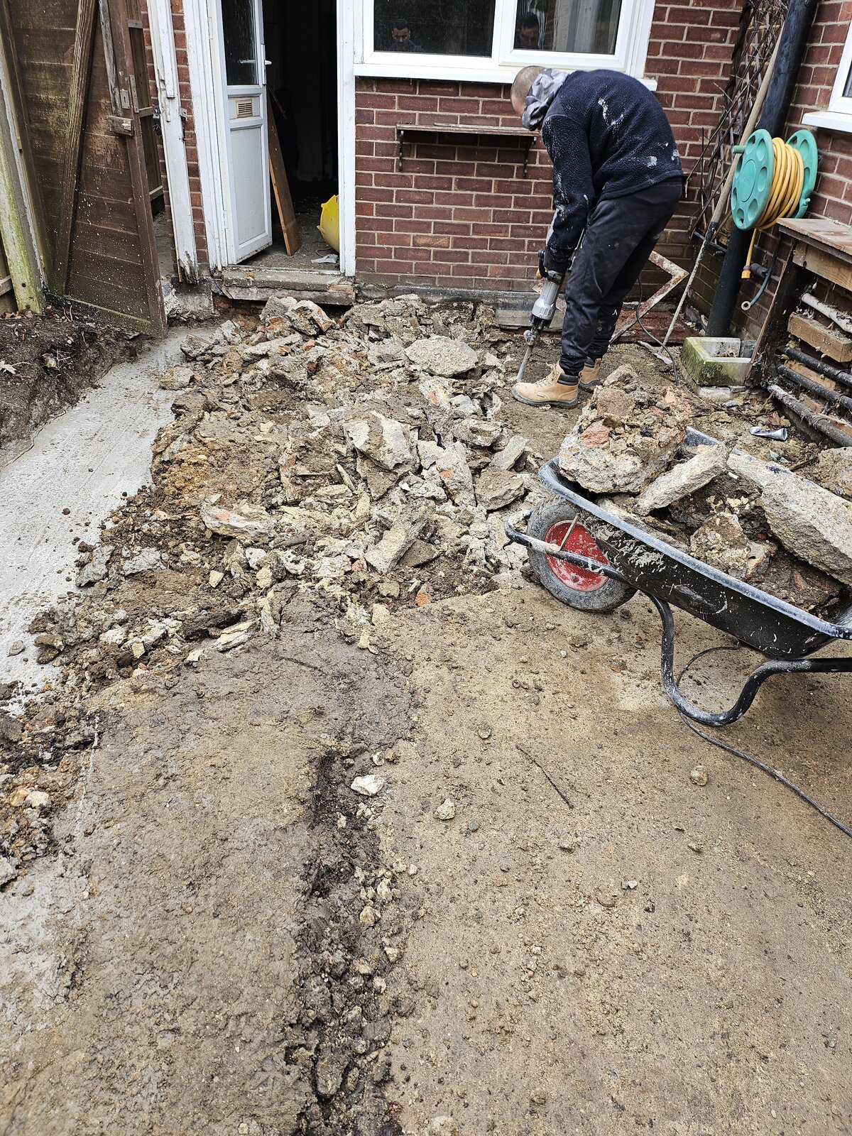

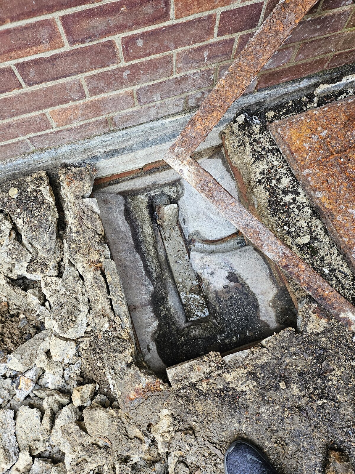

Here's a pic of manhole where it turns to the right it's going towards kitchen.
