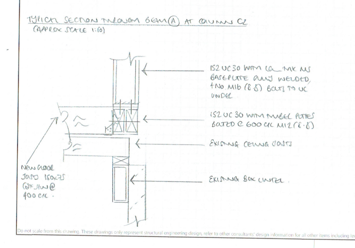

Is there a way the current box lintels can support a light 1st floor structure build with timber rather than blocks, as this way we only need to take the roof up, build up with timber on top of the boxlintels and current outside skin?

If you add an additional skin on the outside you'd need to go back to planning. You're supposed to think about how its going to be built before you go for planning. I'd be doubtful those lintels would cut it unless they were over specified in the first place but your SE would need to confirm, probably need replacing with some steel beams, build the timber inner skin off them. What are those box lintels doing anyway, are they original, why don't the trusses bear on the single skin?

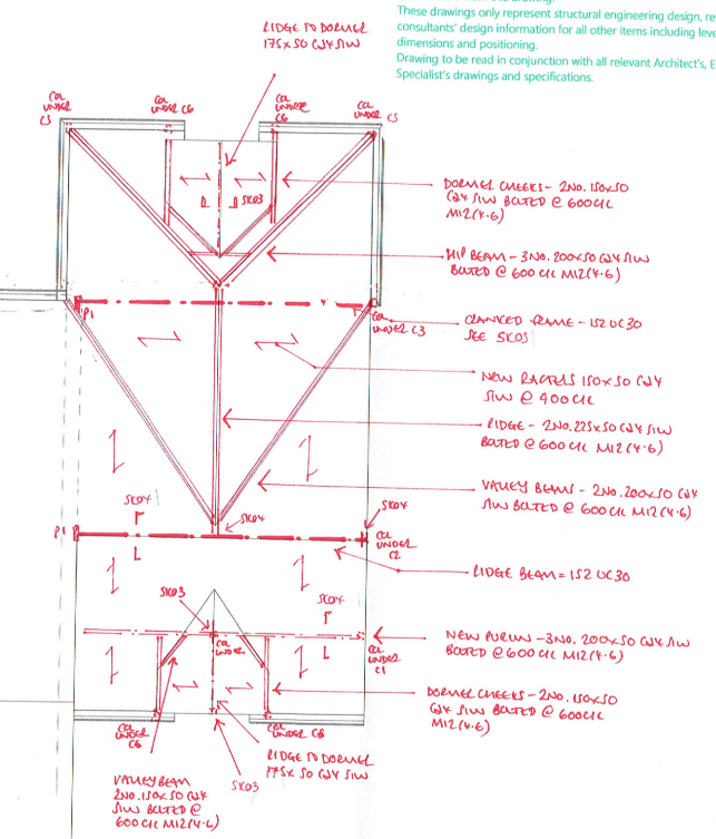

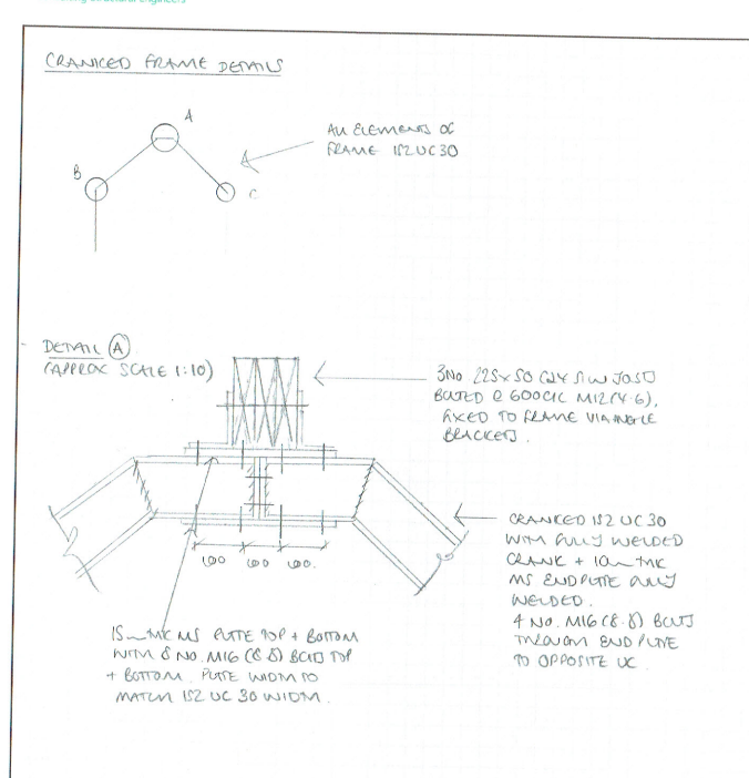

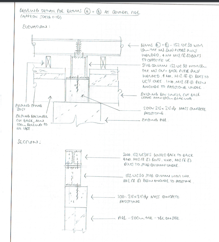

Well you've already seen the detail showing how it can be done in your other thread yes? So it is possible. Perhaps try another more progressive engineer.
