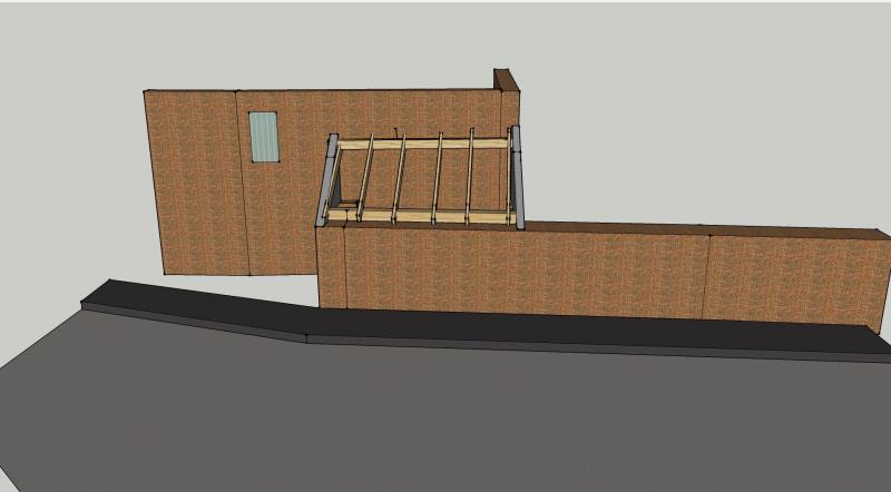

Hi, im just wondering if this will need planning permission and building control, or if it will even be allowed at all, as I see there is a rule about extensions on the side of houses fronting a road.
Basically at the moment I have a garden wall that runs down the side of my house, my house is only three years old and so is the wall, so everything is all pretty new.
At present there is a slightly triangular space next to my house thats about 3m wide and is pretty useless, as it never gets any sun and just seems to be a dump for rubbish. Access is through the gate from the small bit of path that is mine / pubic street / road.
I have a road that runs in front of my house and also a road that runs down the side.

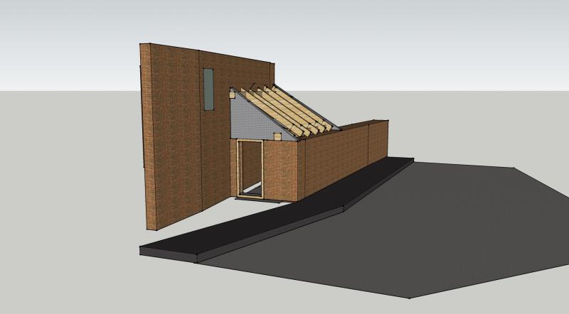

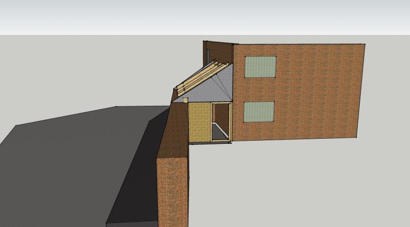

Basically what I want to do is just put a roof on this space, concrete the floor, replace the gate with a door, and put a wall on the garden end (as at present its walled in from three sides), and putting a door in that wall into the garden, so like an covered alleyway with a door at each end I can securely store things in.
I want to convert it into a shed, its not big enough to be a garage, just a shed to put stuff in, as mine being a modern house doesn't have any storage at all.
This is a Sketchup iv drawn of what id like to build, the yellow coloured wall and door frame is the only one that isnt there at present, the rest of the walls are already there. Id like to do it in the same style as my house, and the way my porch has been done, with a tiled roof and white wood on the edges.
You would need Planning Permission and Building Regulations Approval.
You would need Planning Permission because it is facing a highway.
You would need Building Regulations Approval because it is attached to the house.
How high is that wall on your boundary?
Ok thanks :) , I thought as much, the wall is about the height of door frame, so about 2 metres give or take a few cm. Its two bricks thick, and looks like you could run a car into it and it'd still be standing as its pretty substantial.
I would think you may be granted planning permission though keeping the roof pitch lower may hep your chances.
If you avoided attaching to the existing and kept it within certain limits then it would be classed as an outbuilding rather than an extension but probably still needs Planning Approval as the chances are (seeing as your house is three years old) the planners will have restricted what you can do without having to apply for Planning Permission.
