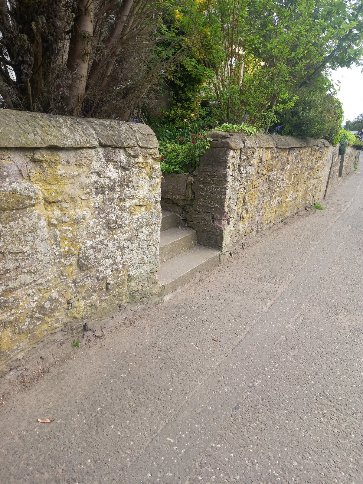

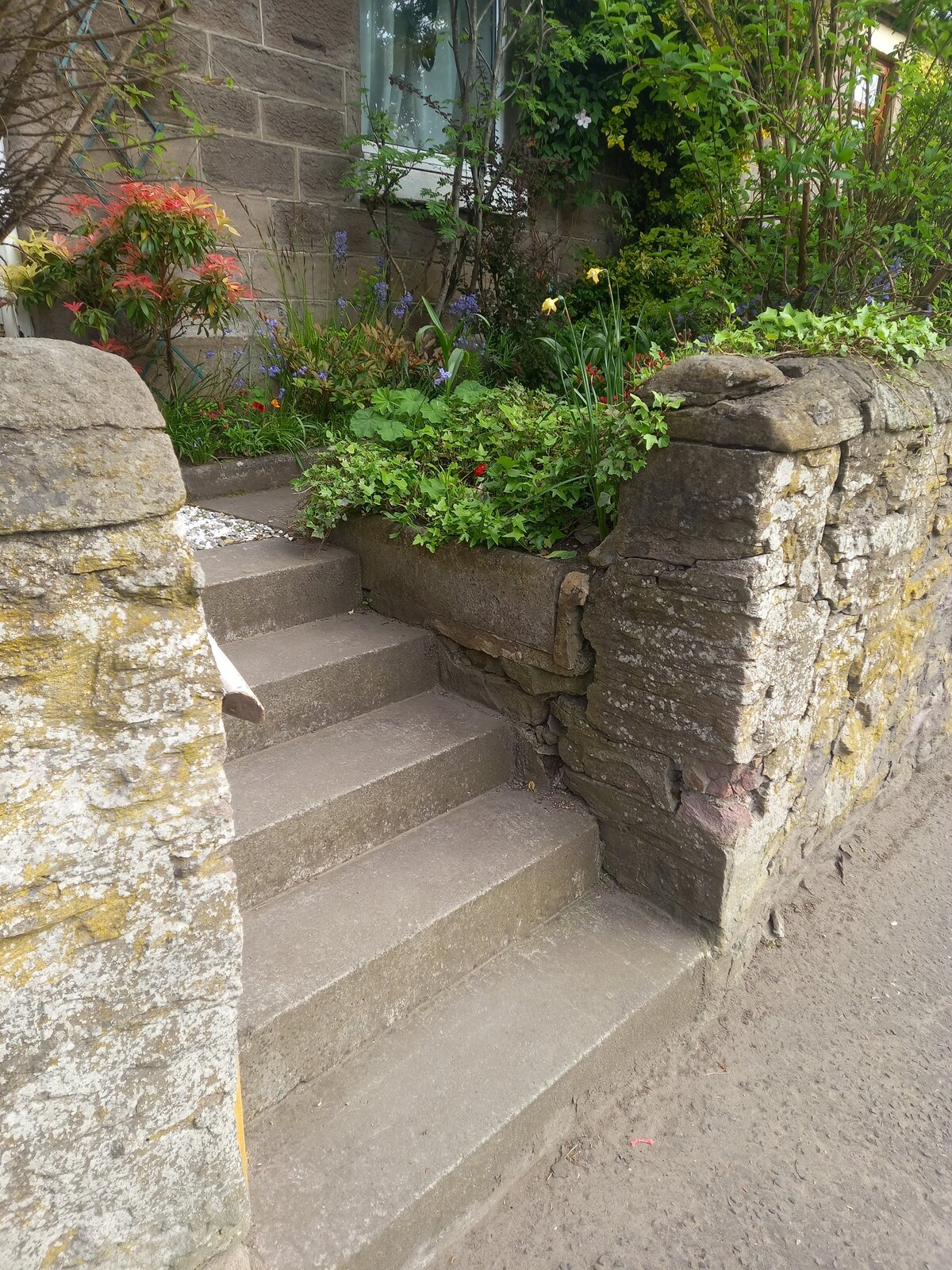

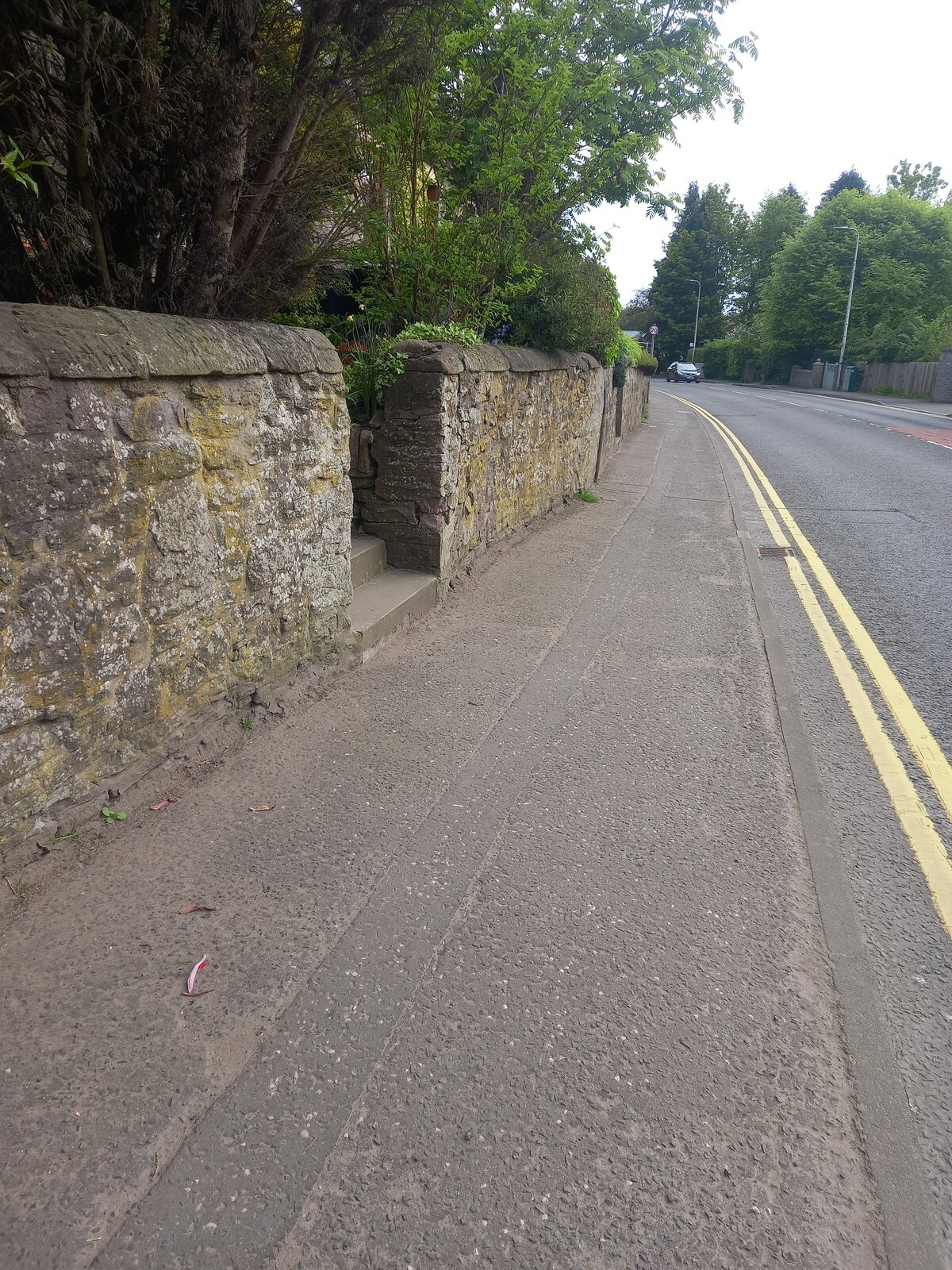

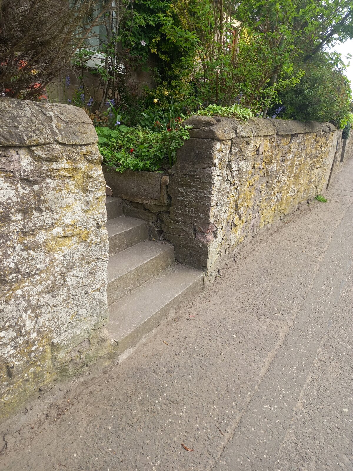

I want to build a concrete ramp next to and including my front steps though the angle is rather tight. Is this a viable option as it is from the pavement in the front of the house. The ramp will have to be about three feet vertical and a good 20 feet in length I guess and I think I will have to widen the entrance way by a couple of feet on the right hand side. This will involve taking away from the wall on the boundary and then the earth to build a ramp on .

We need better pictures and an idea of the bike’s abilities.

OK thank you for your observations but no ideas yet! The route will go to the right of the steps that's an angle as I can't go straight up the steps as the front door is right in front of that. It's a big bike 650CC's and pretty heavy. So it has to go to the right of the steps basically if you want to go up the steps and turn right that's where the bike has to go. So I have to cut a bit of the wall on the right until the ramp there I guess.

Looking at the second picture, I think the only chance you have is to take the ramp off at an angle from the steps, (say 45 degrees to the right. No way are you going to get the ramp alongside the steps and then sharp turn right at the top, certainly not with a 650cc model.
If you can go at he angle, when you get to the top, (assuming there is space), you can then push the bike backwards on to the path parallel to the pavement. But then you would need space at the top to turn the bike around as getting it down backwards would be a nightmare.
More photo's of what is to the right of the steps, especially that piece of pathway, may generate more ideas.
At the moment, it's not looking too promising/
Why does it have to go to the top of the steps? Why not dig out a parking space and build a new retaining wall?
