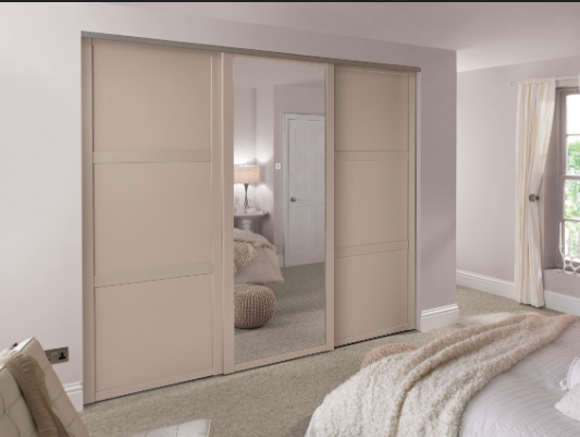

I am planning to fit some sliding wardrobe doors along one section of the bedroom. Since the doors wont span the entire wall of this bedroom, I need to build up a battened wall section on either ends of these doors and plasterboard it to finish. A bit like this image:
The floor is currently carpeted and I am nervous about screwing the studwork down to the floor board as I don't know what sits underneath here e.g. pipes, cables, etc. How do others approach this situation?
