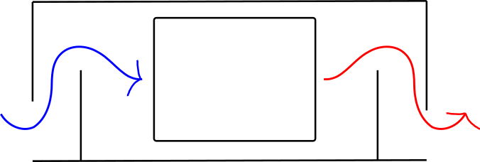

I want to build a sound-proof box for a loud computer (a cryptocurrency ASIC). The box will be lined with 30 mm closed-cell sound-deadening foam marketed for use in vehicles. I've built one already from 25 mm MDF (£36 for 1220 mm x 2440 mm at B&Q) but I would like to know whether there's a better alternative material (25 mm HDF is a thing but seems harder to get). I expect that I'm probably already using the most practical material but wanted to check.
I do have some bathroom tiles that have been in a cupboard since I moved in. I suppose I could line the box with those (betwixt the MDF and foam; I've read they're kind of sound-reflective due to hardness and smoothness)
Your diagram you posted is not strictly a sound proof box, depending on the actual size if the air ways it is more likely to be a sound absorbing chamber.
The internal walls will need to absorb sound, not reflect it. Hence line the air ways with soft material.
the bottom half of paper mache egg boxes absorb a lot of sound for near zero cost..
look for information on anechoic chambers
The sound needs to be reflected AND absorbed. The 30 mm foam I mentioned in the first post is there to absorb the sound; I need to keep the sound bouncing around inside the box until it's been absorbed as much as reasonably possible.
Change the case or the fans. You can't soundproof a computer effectively, because you still need ventilation for it.
The computer looks like this; what case would I change that to? The fans are very high-speed at 6000 rpm and are already pretty high-quality (made by DELTA) and they need to send the expected rpm signals back to the controller or it won't function without customising the firmware which is beyond me.
My design does not eliminate ventilation and I don't need to adbsorb every single soundwave; I'm just trying to attenuate it as much as practically and economically possible.

I think MDF is reasonable for this, and other box materials wont make a significant difference. The best idea would be to re-locate it to where the noise doesn't matter, in the loft? out in a shed?
I wouldn't change the fans to silent types, high power units are always going to be noisy, anything quiet wont have the same output.
Car exhaust pipes on intake and exit to the box!?
