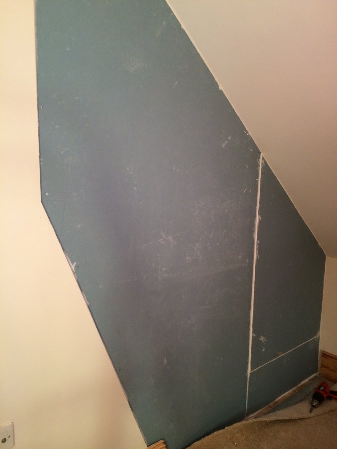

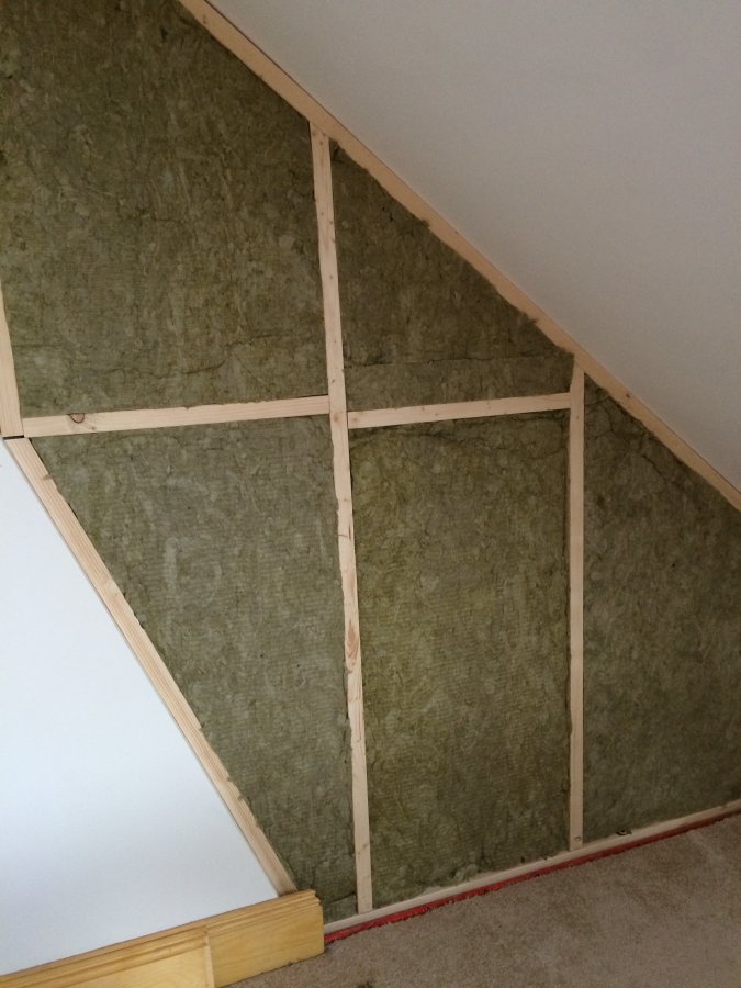

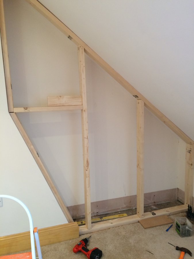

I have just sound proofed a wall, different to yours but it has worked :). I had an alcove that I could lose, so I built a stud wall, 100mm of sound slab rockwool, 2 sheets of sound bloc plasterboard, with the joints staggered and 3 tubes of acoustic sealant!
My bed is beneath the wall and no accidents yet :)
That's top work mate. 1st sheet of plasterboard has gone up, wall has a bit of "give" which according to my sources is pretty normal for metal framing and resilient bars. Plasterboard onto metal work was fecking knackering for some reason... Cheers for all the replies!
