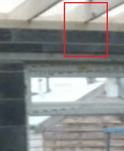

Hi folks, I have started an outbuilding 6x5, dug the footings today and backfilled concrete. Tomorrow I will be preparing the oversite, checking the foundation levels and the bricklayer will be making a start.
I am giving roofing a try, have most of it figured out but struggling to find a way to fix / tie down the timber to the top of the brickwall. I have found some joist hangers would I could use in an upside down fashion but I doubt this is the correct way.

There exists just such a thing for this purpose
Can also get twisted ones to strap two surfaces at 90 degrees to each other such as the wall and the side of the joist
If you're just talking about the wall plate, can also screw through it and into the concrete block with these:

You don't need a twist strap on each joist, maybe 2/3 spaced on the walls where the ends of the rafters/joists are.
The "L" shaped straps go up the wall and the short end of the strap sits on the top of the wall plate to hold it to the top of the wall.
Don't think there are "U" shaped ones.
How are you securing the joists to the wall plate? Nailing, notching, hangers or clips?
I will be using 6m lengths of wood across the 5m span so should get sufficient overhang. I will be using firring strips so hopefully I won't need any notches etc and should simply be a case of securing down the joists to the wall, which is why I thought I could have two twists straps per joist. I will be using wall plugs and screws to secure straps to walls and open to any advice on whether nails or screws are best for wood.

You showed a picture that featured a wall plate
Take a look at https://harmonytimber.com/wp-content/uploads/2020/02/Cullen-Technical-Guide-Restraint-Straps.pdf for options and guidance
Two straps per joist is overkill
Screws or nails; typically metalwork straps/hangers etc are fixed to structural timber using square twist nails

That setup is to provide lateral restraint and support for a floor. The detail for resisting wind lift of the roof is on page one
Thanks again for your response. Considering my design does not include a wall plate, I think I have narrowed it down to two options, Hurricane Ties or Twisted straps with firrings to help create the run.
Is there any reason I should consider fitting wall plate or should it be fine to just be rested directly on top of the wall with ties / twisted straps to secure to the wall?

Like these?
Wind Ties
Just saying, with a wall plate installed you will need a deeper fascia board.
