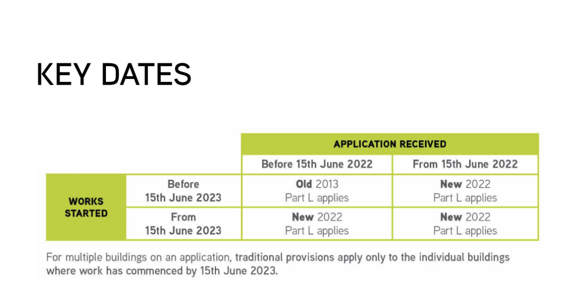

Hello I found out today from a window manufacturer that last year's changes need to be followed even though an application was made before the change. This is because it's when you buy them that counts not when you made the application.
I was wondering if anyone knows if this is the case with all/any other areas, like cavity insulation in particular.
Regulations are those in force when the application is registered. Window manufacturer's may not make windows to the old regs, in which case you won't be able to buy from them, but you might get them elsewhere. Insulation itself hasn't changed, it's just a question of how much you use.
Are the windows being installed under a FENSA approved installer scheme? I suspect they will have to comply with the requirements at the time of installation to apply for the certificate.
But as jeds said, assuming it was a Building Regulations Full Plans application and not a Building Notice then it is the Building Regulations that were in force at the time the application was registered that apply.

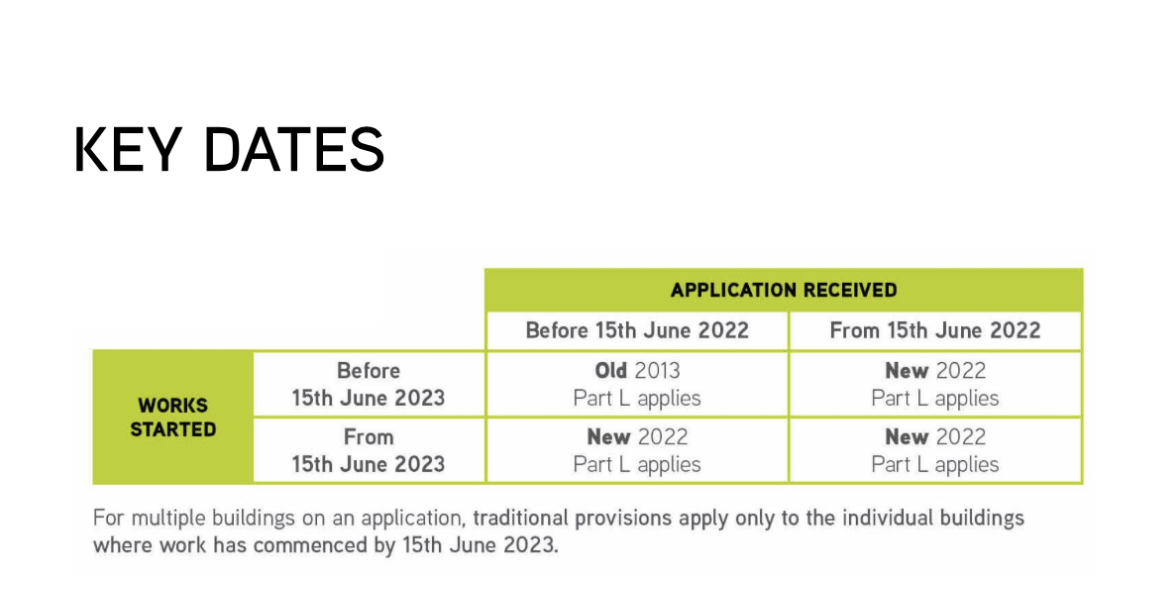

Yes, generally the work has to comply with standards in force at the time the application is registered. But I think there is a rule that if the work commences more than one year after registration, you have to comply with the new requirement? But not sure - I might be wrong?
This is what I’ve seen and I’m relying on to build my new garage with a 100mm cavity when I start in the spring.
I think that is correct? Transitional arrangement.

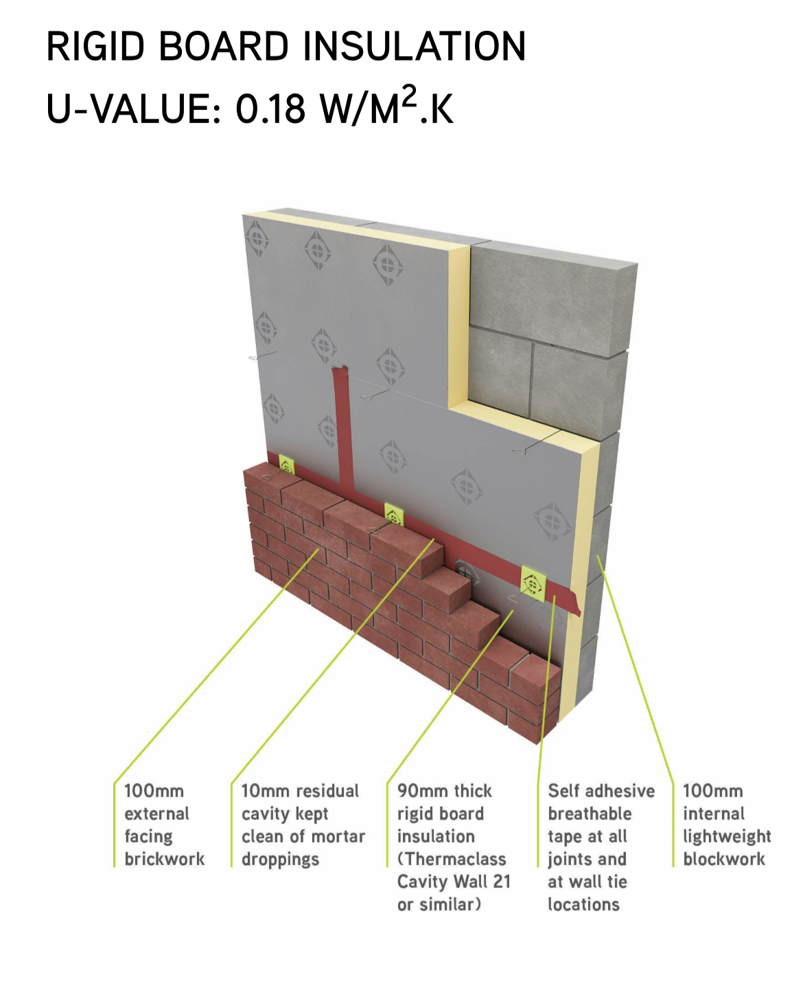

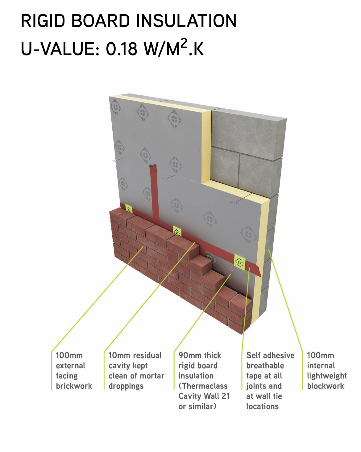

Do the new regs mean there's no way around a wider cavity then?
I've seen this spec advised by several inspectors, yet the Kingspan U-value calculator says you can have a 50mm clear cavity and 75 PIR board against aac block, and you still get 0.18.
I'd be very wary of using a 10mm cavity; using partial-fill board in any case requires more care than - say - full-fill batts, but when you're down to a 10mm cavity, that must require extra care and are many bricklayers up to that?
Cavity walls were common from after WW1 and they were introduced to prevent water penetration to the inner skin (not, incidentally, to improve thermal insulation). The 2" cavity has been widely used for over a century and is 2" for a specific reason - to reduce the risk of mortar bridging.
