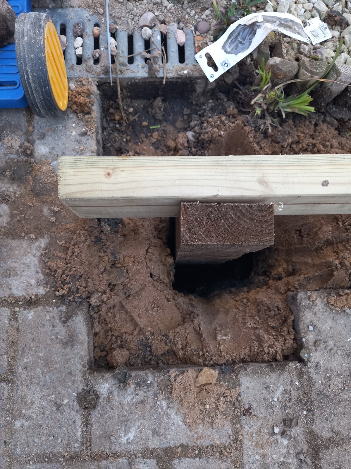

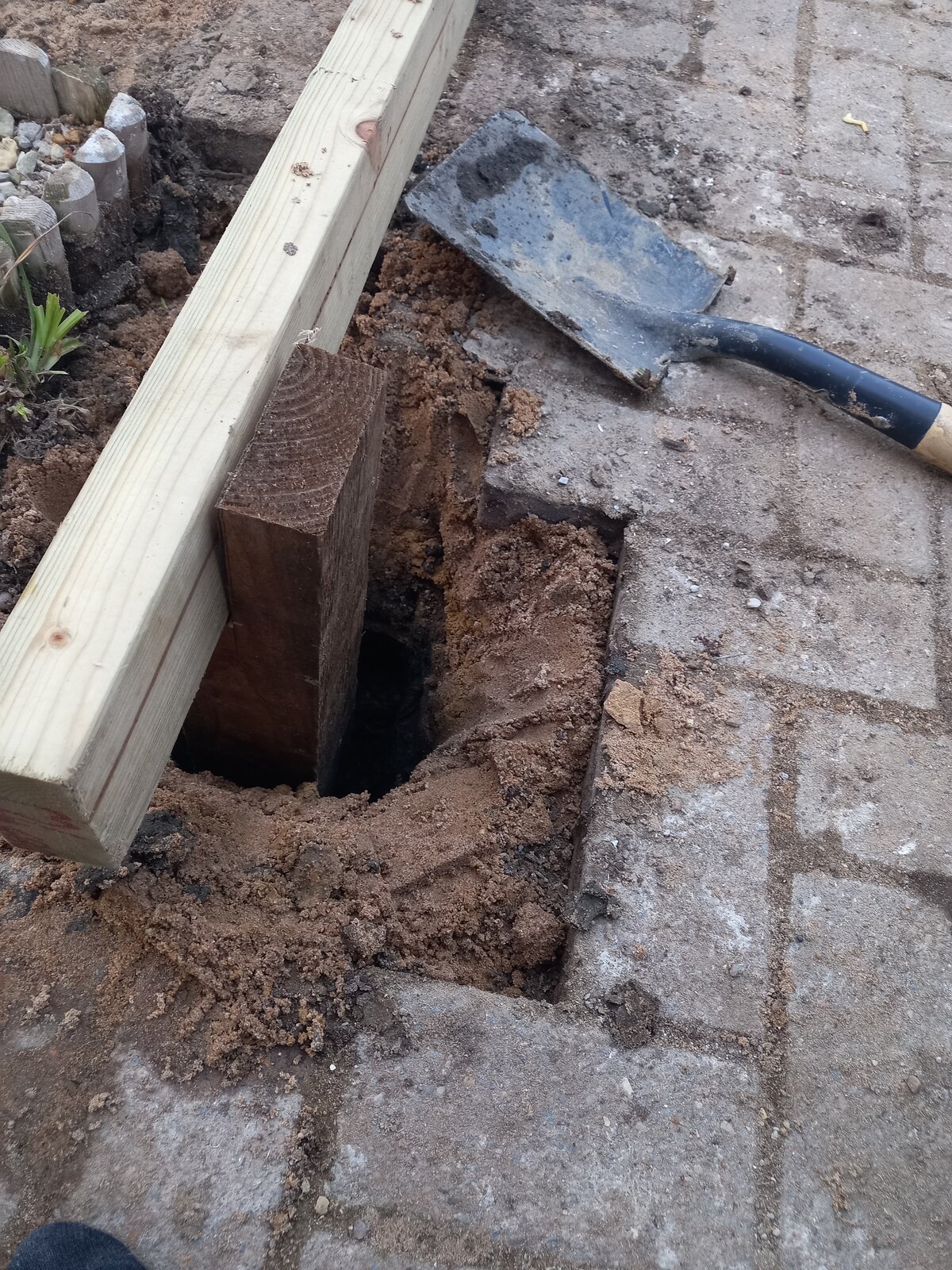

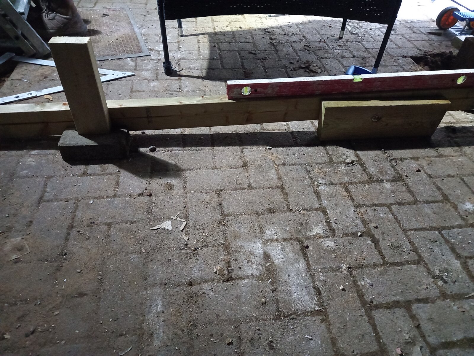

So building some decking off the back of my conservatory and wanna run the design by you more experienced guys and ask leg and support intervals...
- 4.5m wide x 2.85m projection
- Slight slope so raised about 5cm off the ground one end and about 20cm the other end.
- One end is gonna be a ledger board off the conservatory using 5x m12 studs and chemfix.
- Joists connected from ledger to other end using galvanised joist hangers.
So my question...
What intervals shall I support the frame..
For the legs being concreted in, what depth should the legs go down in to the concrete?
I want planning on cutting a birds mouth in 100x100 and placing 4 legs across the width of the end plate. Then 1x 100x100 at the 1.4m point of each end joist.
Then was gonna use concrete blocks to support across the center of the frame.
