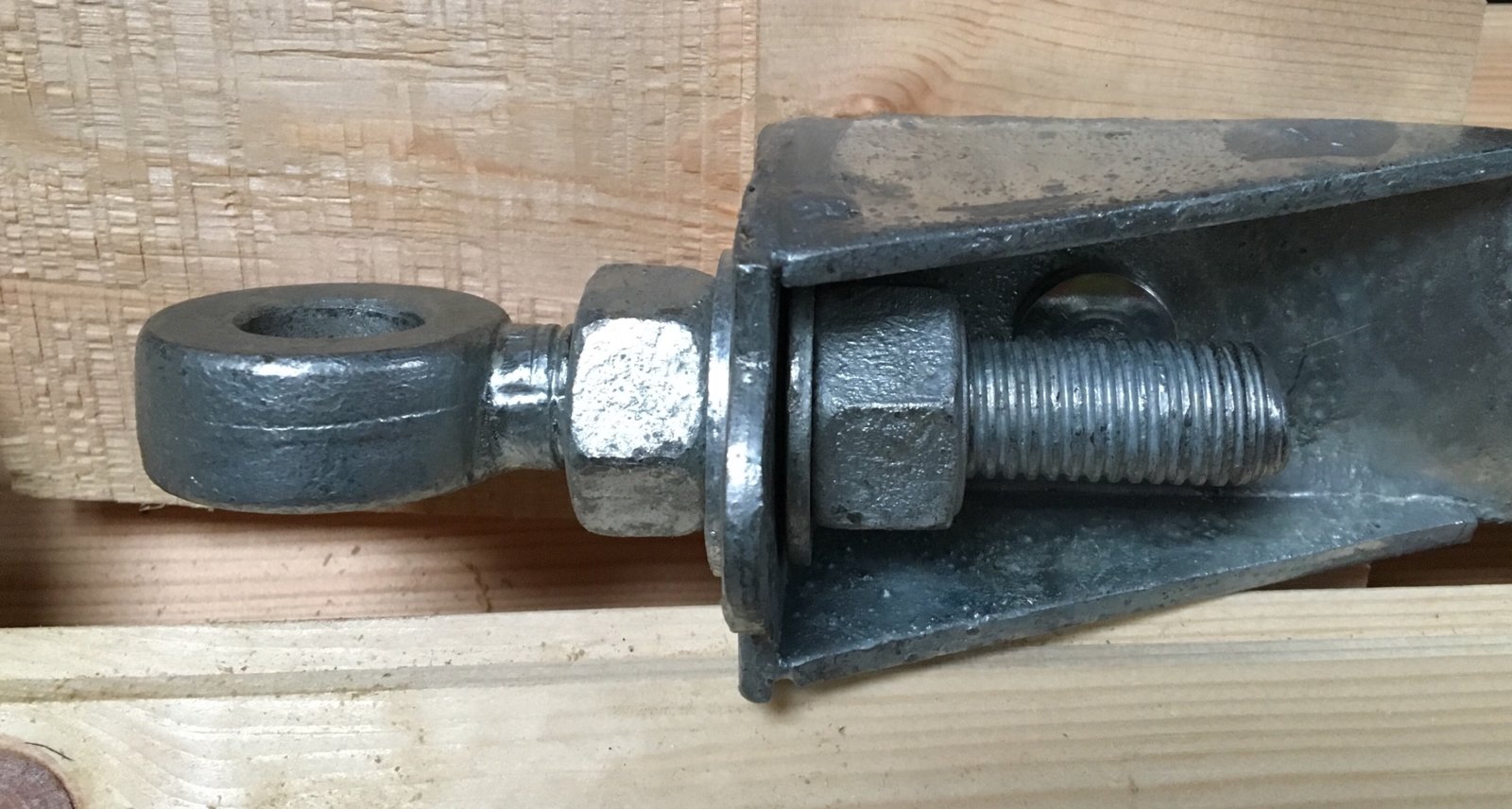

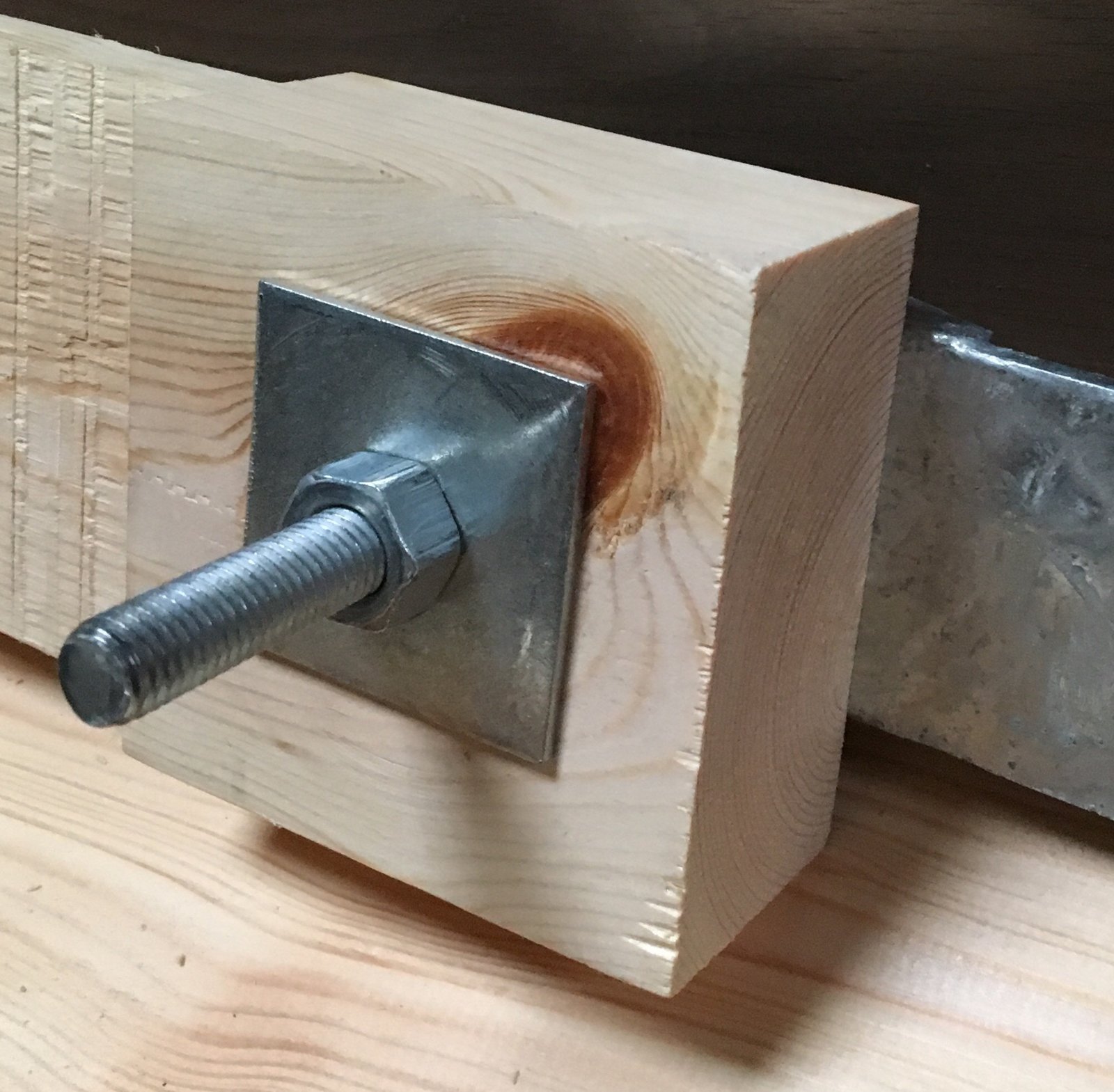

Hello again
Quick question re the acorn nuts... presume this is for the front?
Just picked up some adjustable hook and band hinges, and noticed that the coach bolt with square shank (nearest hinge) only fits the hinge from back to front, this means I’ve got the grind the bolt down once tightened. Not sure it will look acceptable.
I’d prefer the domed head to be on the front, but worried it might pull through the wood when tightened?
Any suggestions...
Thanks.
Ignore me, :whistle:
Just reversed the bolt and it’s holding tight in the wood, didn’t spin, so dome head to the front.
if you're using coach bolts of the correct size (I think mine were M10 but maybe M8), they have a short square shank that fits into a square hole in hook-and-band hinges. As coach bolts have a round head with no slot, ne'erdowells can't undo them from the head side. This works fine if the hinges, and the bolt heads, are on the outer face of the gate. They also look very neat.
However, the nut can look rather rough, especially if on the public side, and dome or capnuts look much better. You can use a C-form washer to spread the pressure if it seems to sink into the wood. I use stainless for all these things as they are exposed to the weather and I am on the coast, I think it looks brill but you can paint the metal if you use zinc-plated (BZP weathers away outdoors).
If the hinge swings freely then there shouldn't be much force on the nuts and bolts, they're just taking the weight in shear.
edit
as you say, the bolt may be a tight enough fit in the wood not to turn. After a few years, when rusted on, this may not be the case, so grease the bolt and nut well. If using stainless, there is a special compound, sometimes based on clay, that prevents the two parts seizing together (they can cold-weld and become impossible to separate). You can buy it in a 50g tin that will last a lifetime. I use Nickel grease but there are various.

Thanks for this lot.
Think I will have to resort to fitting the dome head/square shank bit from the back (as it’s meant to).
There isn’t enough clearance to chop the bolt down and tighten etc.
Your idea of dome caps is what I’ll use, as I can shorten the bolt length as required, once it’s fitted.
I’m going galvanised for finish, as it matches other metalwork I have already.
Mocked up a couple of images might make things a bit clearer.
It’s a Eliza Tinsley hinge with M10 Bolts
