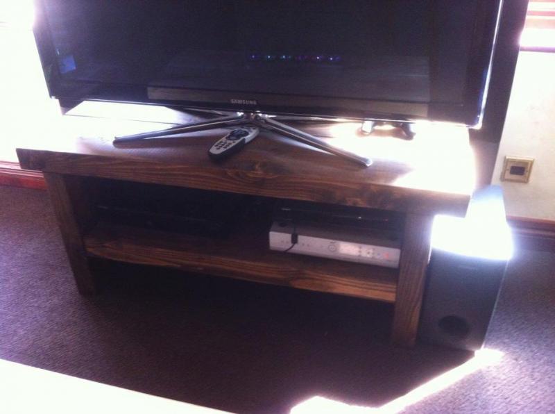

What thickness are your sleeper ? as your top and shelf are only 10cm?
Seems a bit high for a tv, the stand I built is 20" high and holds a 50" plasma at ideal hight.
that looks really nice and much easier to build than what i have designed.
just wondering how have you connected the top to the sides as i cant see any screws or bolts and also how have you connected the two sleepers on top together?
also how have you got such a nice dark colour... is that oak?
the sleepers i am aiming to buy seem to be sized at 2400mm x 200mm x 100mm my tv is 55 inch i think so wanted something wide enough with a bit extra each side so thats why i went for the 160mm also i went for a height of 60 cm as my new suite is quite heigh seated so i wanted to raise the tv a bit but 45 cm would probably be fine as thats what we currently have
thanks very much for sharing your knowledge
carl
Not clear on photo but screwed down into legs and used wood plug to hide screws, actually built as to narrow units then screwed together from rear with 6 inch screws.
Just cheap roofing timber about 10x3 stained with a dark oak wood dye and polished up.
