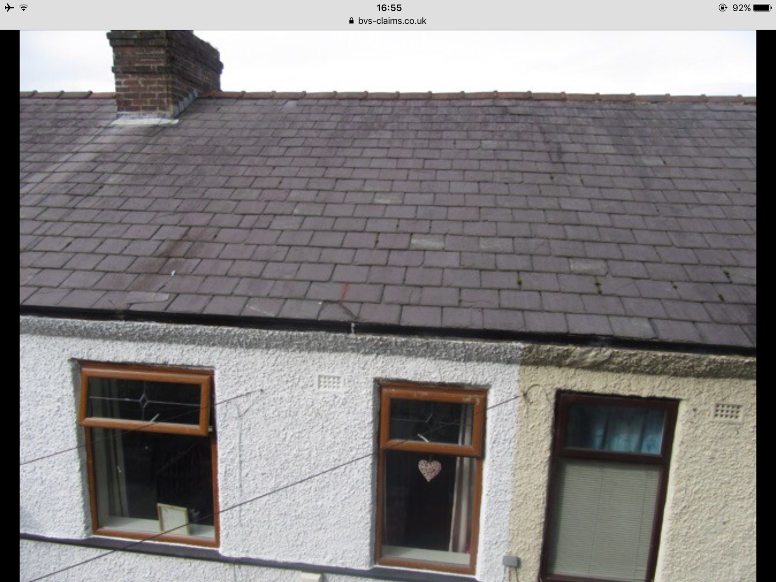

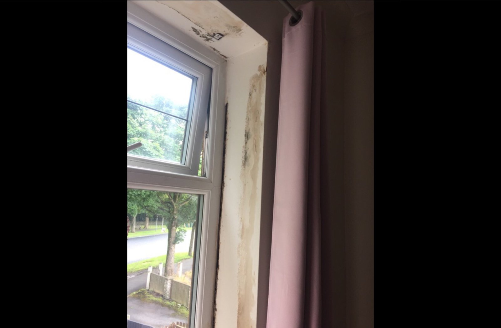

I've put in a claim on my building insurance for what I know is a leaking gutter. They told me I wouldn't be able to get that fixed as it's "wear and tear" which is fine. Told that I could claim on accident damage one for fixing plaster and damp in bedroom.

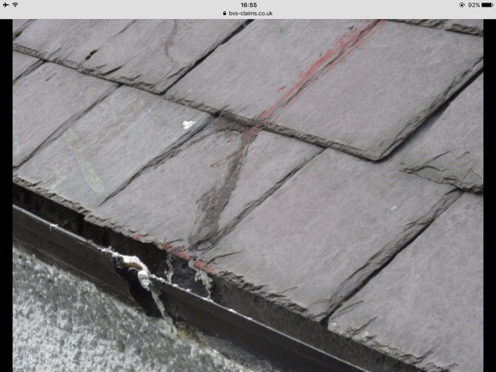

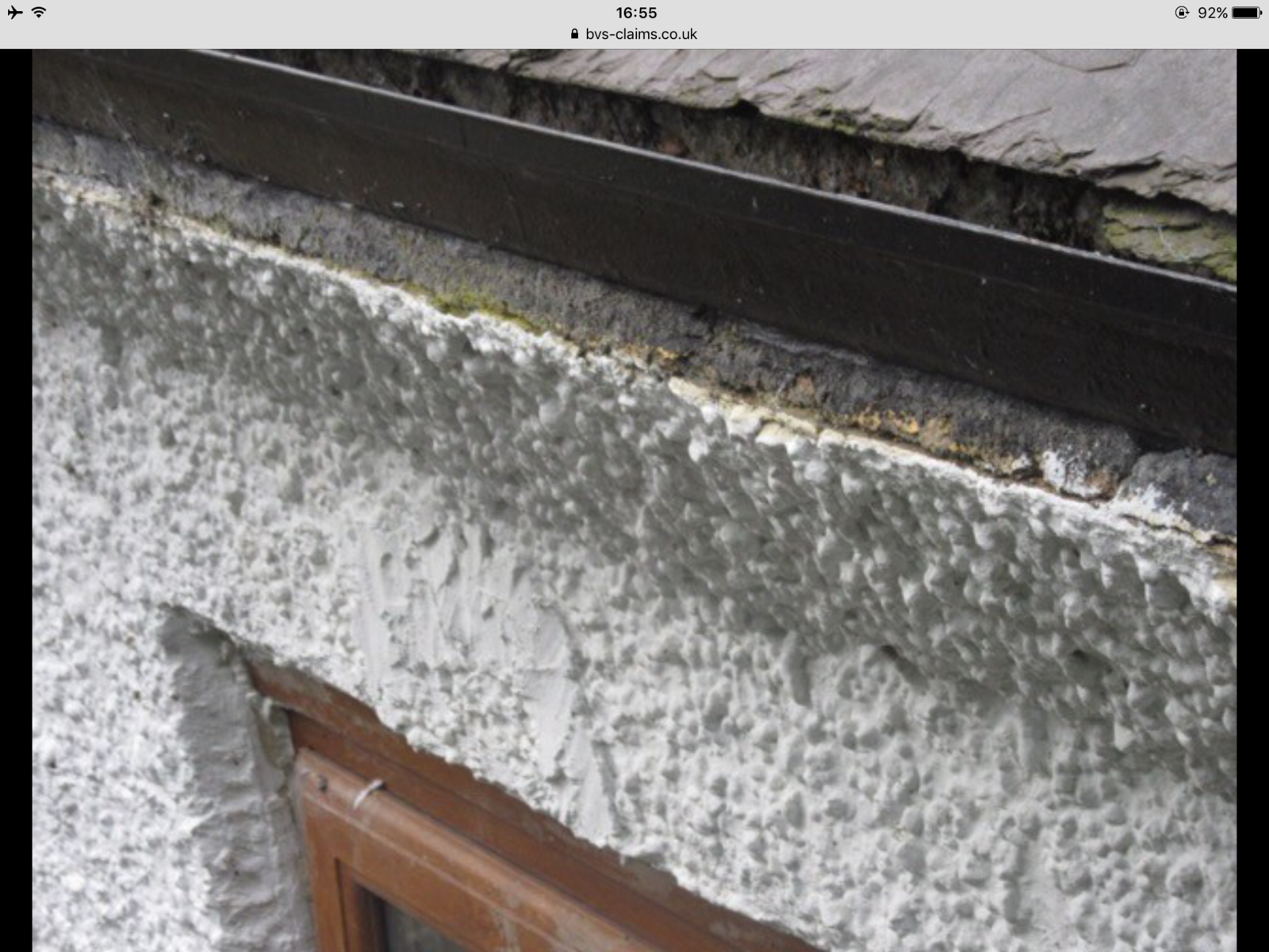

So surveyor comes out decides it's not the guttering but a natural degradation of the mortar below the guttering which is where my leak is coming. And if it's not there then it is the cracked tile that has been repaired. Now I know for a fact it's the gutter as it has been sort of repaired by myself but needs further action to rectify it.
The surveyer used a camera on pole to take pictures but didn't prod around or anything like just looked and went that's your problem you are not insured for it. Now I have tried arguing but they have said fast that's the problem now where does it leave me. We all know they try to weasel out of everything woth 75 pages of small print about things you aren't covered for.
I think there are 2 options
1 suck it up and accept there word and pay for fixing it all myself
2 get a gutter expert out and see if they can find the problem then argue with the insurers.
Attached is the pictures he took of where the "problem" is. The last picture is of where the leak is in the bedroom which happens to be where I think the problem is.
Thanks for any help.

Well, applying logic -
how can it be natural wear and tear if they class the internal damage as 'accidental damage' - the result of an accident?
On the other hand, why should they pay for the internal damage if it is natural wear which you have not maintained?
Gutters are not fitted to keep water out of the property. If your walls leak, your walls leak. If the tile leaks, it will have to be replaced.
To be quite honest, I don't think this should be covered by insurance.
It may be but such things must increase premiums hugely.
Obviously you will have to abide by their rules.
Sorry.
It's not storm damage and I doubt it classes as escape of water from fixed water apparatus. I don't think it's covered, either.
Its the gutter leaking which has caused the damage! from experience they generally will not cover wear and tear of the gutter but cover the damage caused by the leaking gutter.
The degraded mortar fillet is acting as a water trap and wont be helping matters any but its not the cause of the water ingress.
The original gutters would have covered the whole plinth.
You can appeal to the ombudsman but after paying the excess on your policy is it really worth it.
So it's not worth it then I'll just have to find a roofer and hopefully it's a easy fix. Thanks anyway.
FWIW, we had a leak from our flat roof which was not covered but the damage caused by it was...
That's what I got told the damage would be but they have said that it's not now. Just trying got get someone round to have a look and see how much I can get stung for.
I'd be tempted to do a proper repair on the gutter joint before calling out a gutter 'expert' who will simply tell you the lot needs ripping off and replacing. The problem with this sort of work is the guttering will usually extend over your neighbours house. Therefore they will get a new section of gutter at your expense. If, like a neighbour of mine many years ago, they offer to pay a small part for their section then all well and good but get it in writing! My neighbour offered to pay for his front to be completely done and because the builder said he would reduce the cost. The plan was I would have mine done on my insurance at a cost which would cover both houses and then said neighbour would give me half the cost of my excess, (which was £200 in the early 80's so a fair slice of cash to stump up)..
Suffice to say the neighbour refused to pay his share and got a new set of gutters gratis of my insurance. Couldn't even sabotage them as we moved out about a month later to have the house renovated and when we came back after 3 months we had new neighbours!
