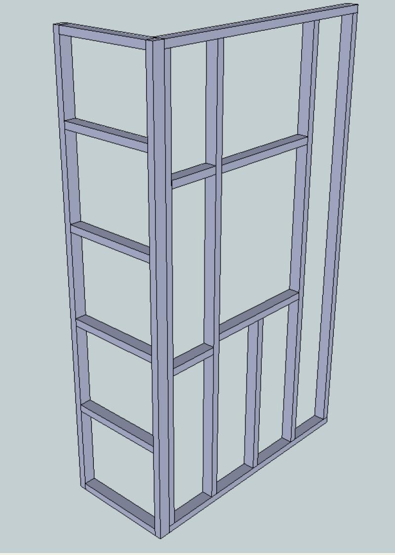

I'm about to start a little project to build out our existing chimney breast - the TV is already mounted on the chimney breast itself - a stud frame will enclose the chimney breast but leave a recess for the TV mount and a flex outlet for the power connection to the TV. Cables will be hidden inside the false wall.
Here's a Sketchup model that gives you an idea of what I'm doing:
https://dl.dropboxusercontent.com/u/570528/Chimney Breast Framework - Frame.png
https://dl.dropboxusercontent.com/u/570528/Chimney Breast Framework - Fittings.png
Note: the TV itself will not be recessed into the false wall, but the recess allows the TV to be pushed back up to it with the mount inside the recess, so it doesn't stick out any more than necessary.
I've already planned the route for the power cable inside safe zones - the flex outlet will be connected to an FCU on the left side of the false chimney breast (in the alcove). The cable will run up the inside corner of the alcove, along to the top and down the front to the outlet.
I'm still trying to figure out the best approach for running the HDMI and speaker cables - I'd like to put them in conduit so I can pull new cables but I don't want to build out the wall too much. Cables will exit from brush plates on side and in recess.
I'm just about to order my timber and plasterboard (I'm using 63x38mm CLS) and I just wondered if there's any general tips you can give me for making sure I build this thing properly, square and level.

The false wall will be skimmed along with the rest of the room. Does my stud work in the above sketch look sufficient?

Seems reasonable, although I don't think you'll need to double-up on the verticals (see comments below)
When your timber comes if it is wet you'll not need to pre-pilot (which makes framing easier). Use #10 x 3-1/2 or #10 x 4in (or 5.0 x 80/90/100mm metric - by #10 I mean 10 gauge) CSK head screws to put it all together. Make your studs match the sizes of your boards - so if you are using 1800 x 900 boards your studs need to be at 300 or 450 centres, etc. I'd consider making the whole lot up as three separate frames rather than the way you show and raising them into place (fix together through the corners) - they should be tight to the ceiling. Measure the two diagonals when you make up frames - if the frame is square the diagonals should be the same - if needs be adjust with a "birmingham screwdriver". SDS drill (7mm) through the sole plate into the floor, knock-in brown plugs, knock through with #10 screws then tighten to anchor to floor (if masonry/concrete). Same for the uprights to the walls. If you don't remove the existing skirtings first you'll need to scallop the bottoms of the end frames so you can fix it tight to the wall. Make sure that you check these end frames for plumbness and pack off the wall as necessary to get the fronts plumb

This is the sort of way I'd go:
BTW you will need to sort out that recess before boarding over the outside
