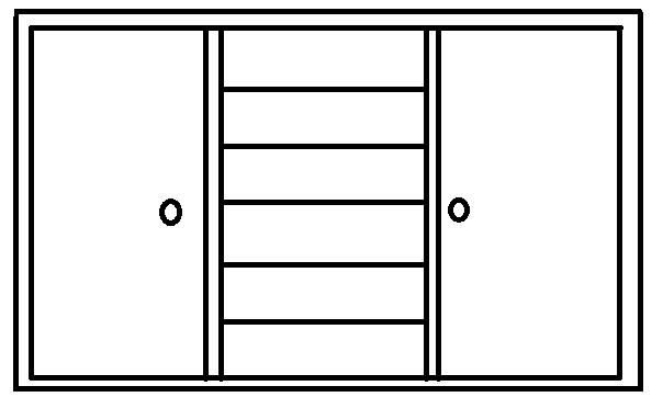

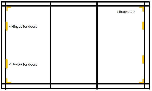

I am attempting to build a set of built in cupboards in one of our bedrooms. This really is my very first attempt at something like this but I know I have a common sense for things like angles and weak spots etc. I would just like a bit of guidance and suggestions if anyone has any. So to begin, ideally I would like two cupboards either side flanking a book shelf (which I have detailed in one of my diagrams). I would like to buy reclaimed pine doors, and to keep the timber on display old looking as our house is a character house from the 1800s. I would build the subframe out of standard studwork timber, however what would be the best size to use? I have seen that 38x38mm is best, but will that be appropriate with the relatively heavy doors? I would also like to hear any recommendations on how I should do the joins where the studwork crosses. I have also attached a diagram of roughly how I'd like to do the subframe - obviously it's not 3d but it's an idea. Lastly for now I'd like to ask how to fix the timber to the ceiling as it's an old lathe and plaster one. Would I need to find a joist above to fix to?

You would need to ensure doors are available to span the openings you have designed. Is this to be in an alcove or with one/ two exposed sides.

Thank you for the quick reply! Thanks for the tip. Thet are to be built in an alcove, well, spanning the whole width of a six footish wide room. If I can't fit two doors it will only be one but I'm more looking for advice about the sub frame, the cupboard space can be worked out.

A bit of a task this one, but certainly possible....however, try not to disturb the ceiling in any way - it'll only end in grief.
Consider the bottom of the frame, which will be fixed to the floor.
Use a lap joint to help hold the uprights, which will need to have a good fixing to the wall.
The top plate can be similarly lap jointed to the uprights, and needn't at this time be fixed to the ceiling - but the timber sections you need to use should be strong enough to self support, say 70 x 30 or whatever your timber supplier stocks.
The structure would become stronger as the work progresses, especially when uprights are added to allow the doors to close onto - on either side of the book case.
Your big issue is to ensure that everything is perfectly square, vertical and equally spaced from the back wall - you'll need a 'marra' to give you a hand, ideally!

I certainly will stay clear of the ceiling, but when you say not "at this time" do you mean I'd need to fix to it after the subframe is set?

Regarding fixing to the ceiling, the framework will actually be strong enough on its own (hopefully) and will be tight up to, but not bulging the ceiling. Any gaps can be filled later or even covered up by a thin timber strip called a lath. If your luck is really in, you may be able to fix a screw or two through the ceiling into a joist, but locating one, unless you can see from the floor above this room, is guesswork.
Regarding the tooling, a chop saw is great for cutting things to length, but a sliding mitre saw will allow you to cut out indentations in the timber for joints.....remember though, that todays wood adhesives are very strong and some even fill gaps.
I wouldn't have too much emphasis on a nail gun - great though they are, I don't think they have much use here....screws can be undone, after all!
As your project progresses, you'll find that your walls and floor won't be absolutely square or perpendicular. Avoid the temptation to make your work out of square - it'll bite back later!
Do have a bash with manual tools - but make sure they are sharp! A good crosscut hand saw will certainly be helpful, and chisels like a razor are great. Drill a pilot hole before adding screws - it minimises splitting and gives greater accuracy.
When you buy the timber, sight along its length and you'll see if its warped (or like a dogs hind leg, as we say in the frozen North). If it is, put it to one side and choose another length.
