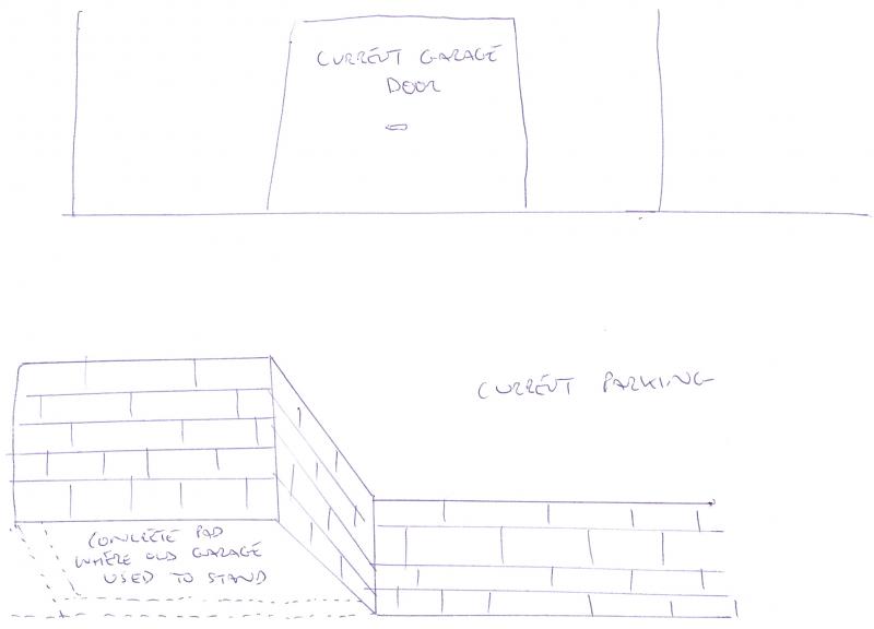

Hi, our garden is built into the side of a hill and has been terraced into a few levels. At the top level there is a driveway. The next level down is approx 5' lower and there is a concrete base where an old garage used to stand, the concrete area is enclosed on 2 sides by walls to the height of the top level.
I want to build retaining walls on the remaining open 2 sides of the concrete base and then build this up to the same level as the driveway above to create a parking spot.
Only one problem - I don't know how or where to start!
Any ideas?
(hope it makes sense!)
start with adequate foundations!
do you intend using the space created, i.e. fitting a reinforced concrete roof with a door into the 'void' beneath?
or, do you wish to solid fill the space and concrete the pad as normal?
Thanks for the reply!
I just want the finished area to blend in with the ground around it which is basically compacted earth with gravel on top. I won't be building anything on top of it.
The questions I have are - What sort of foundations would I need to lay? What construction do the walls need to be? What do I fill the "space" with and do I need to finish with a concrete pad on top?
Here's (an admittedly rubbish) picture that might help give an idea of what I'm talking about! The dotted lines are where I need to build the retaining walls.
Cheers![/img]
