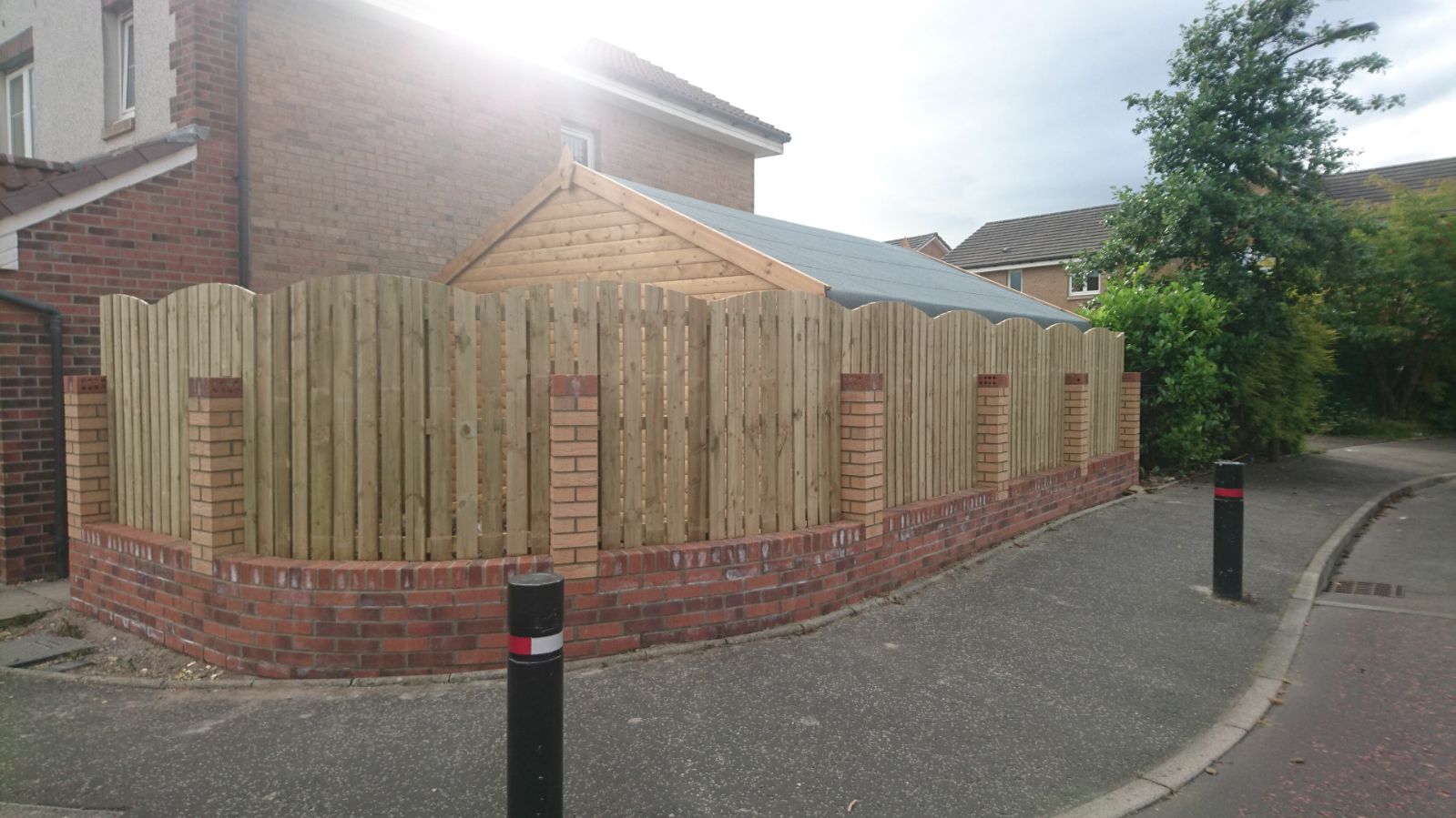

Similar to this

In the link you sent looks like concrete fence posts being used which would also work (y)
The piers in the above image are doing the square root of feckall. They are being held up by the fence.
would be with the panels tearing themselves out of the fixings rather than the piers themselves failing
The piers will fail. Miserably and with consequences if they are adjacent to a footpath.
